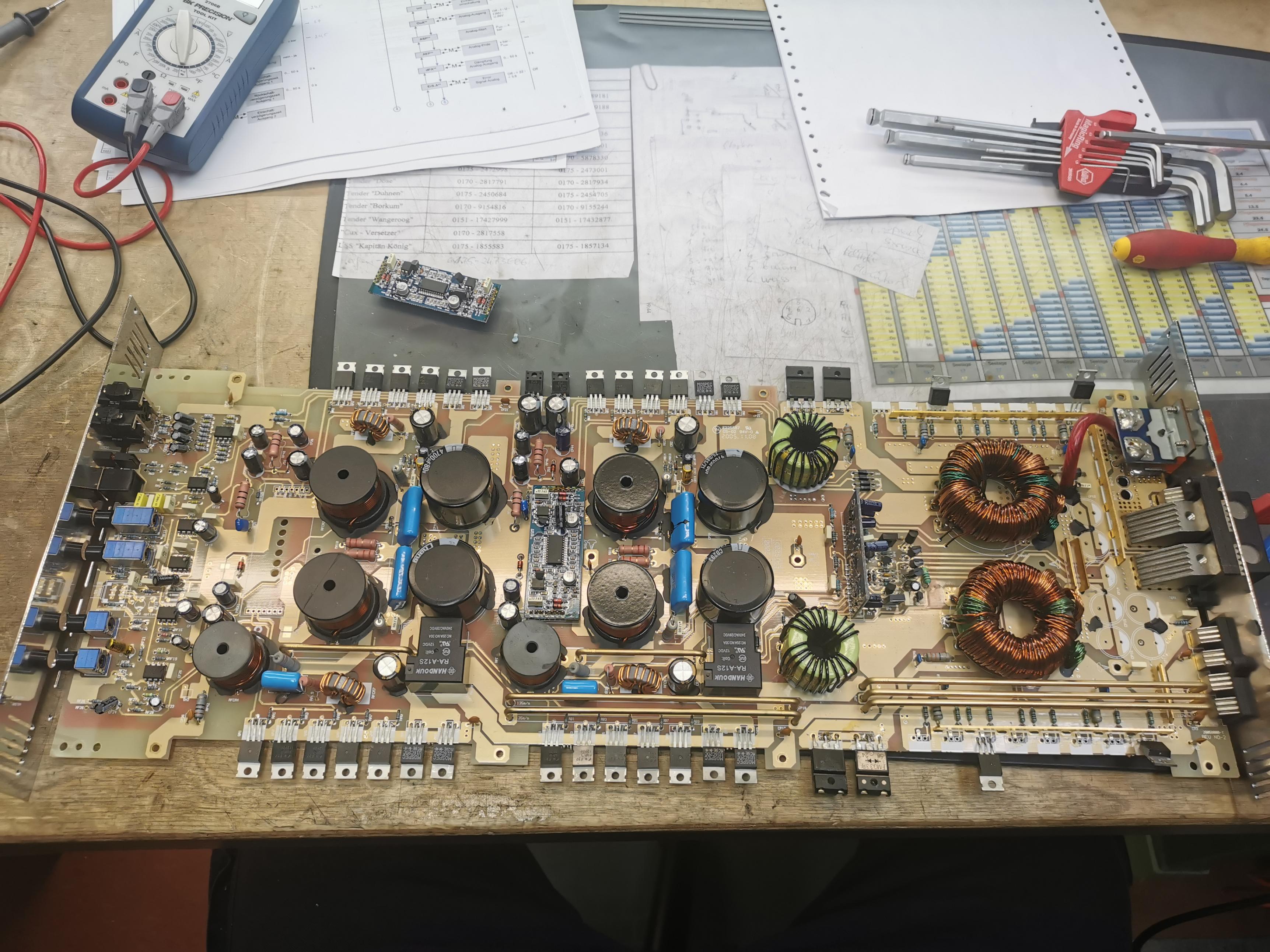

I received this amp, with a burnt ps.. Amp draws excessive current. Mosfets are all OK, railcaps also OK. If I remove the rectifier, idle current is OK. Removed drive boards, but the amp directly goes in protect.

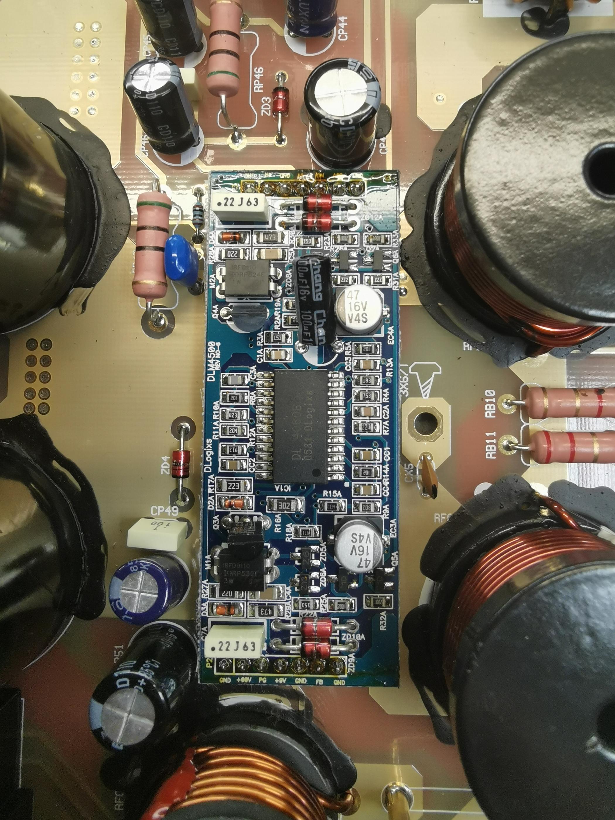

On the 6-pin connector of the PS driver board, are the pins, L-R:
Ground
Ground
Remote
B+
Drive
Drive
Ground
Ground
Remote
B+
Drive
Drive
OK, if I remove the lm 7812 or 7912 the amp current ist normal. I expect a damaged dlogix ic.. How can I measure them?

The PS is working well... I need to test the Audio Part

I'm looking for some sort of reference and I need to know what this driver board is. The pins will give me a better chance of finding a match. Otherwise, I'm going to have to work blind or let someone else help.

Started from left.
Ground
Ground
Rem
Bat
Drv
Drv

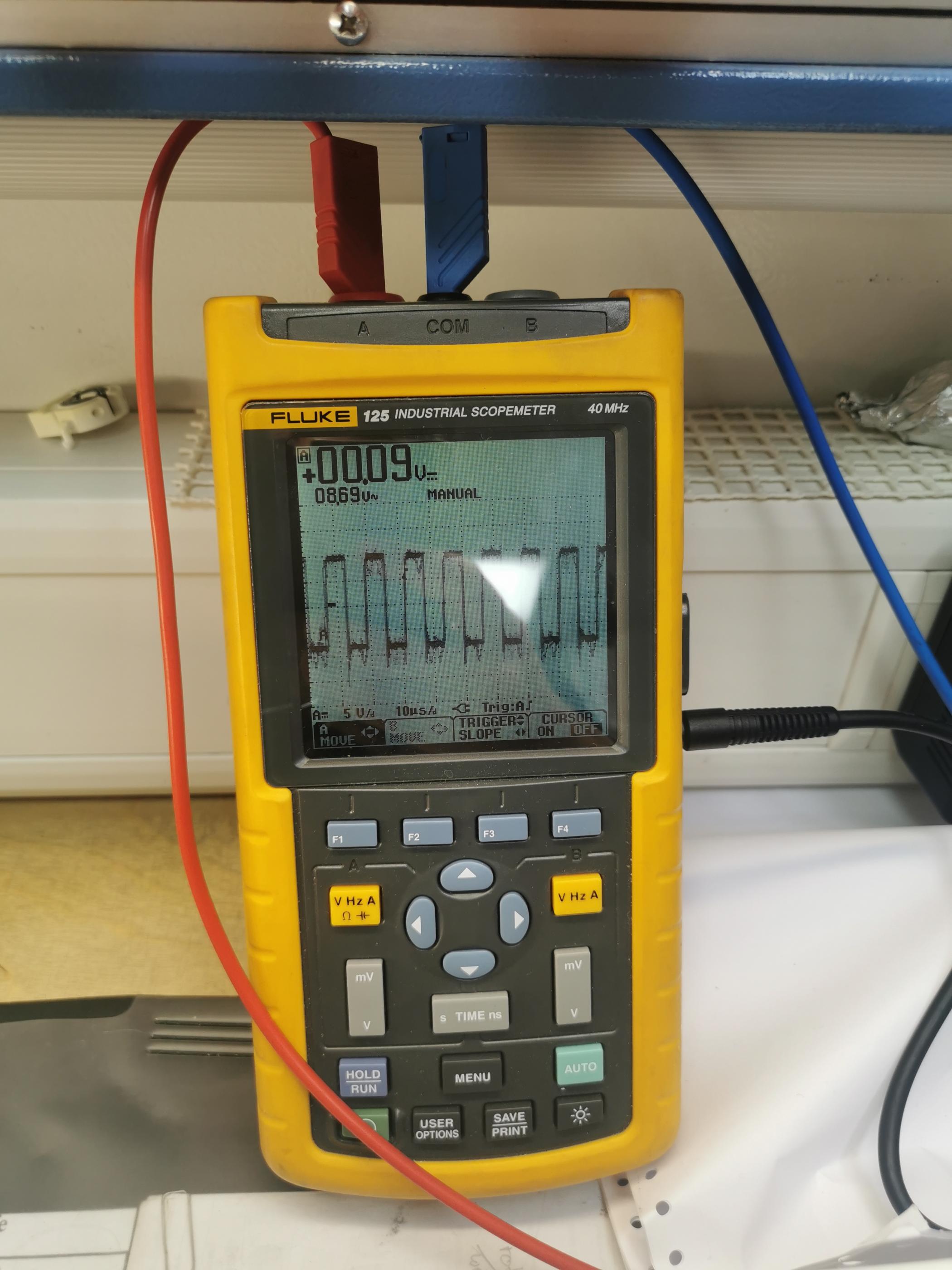

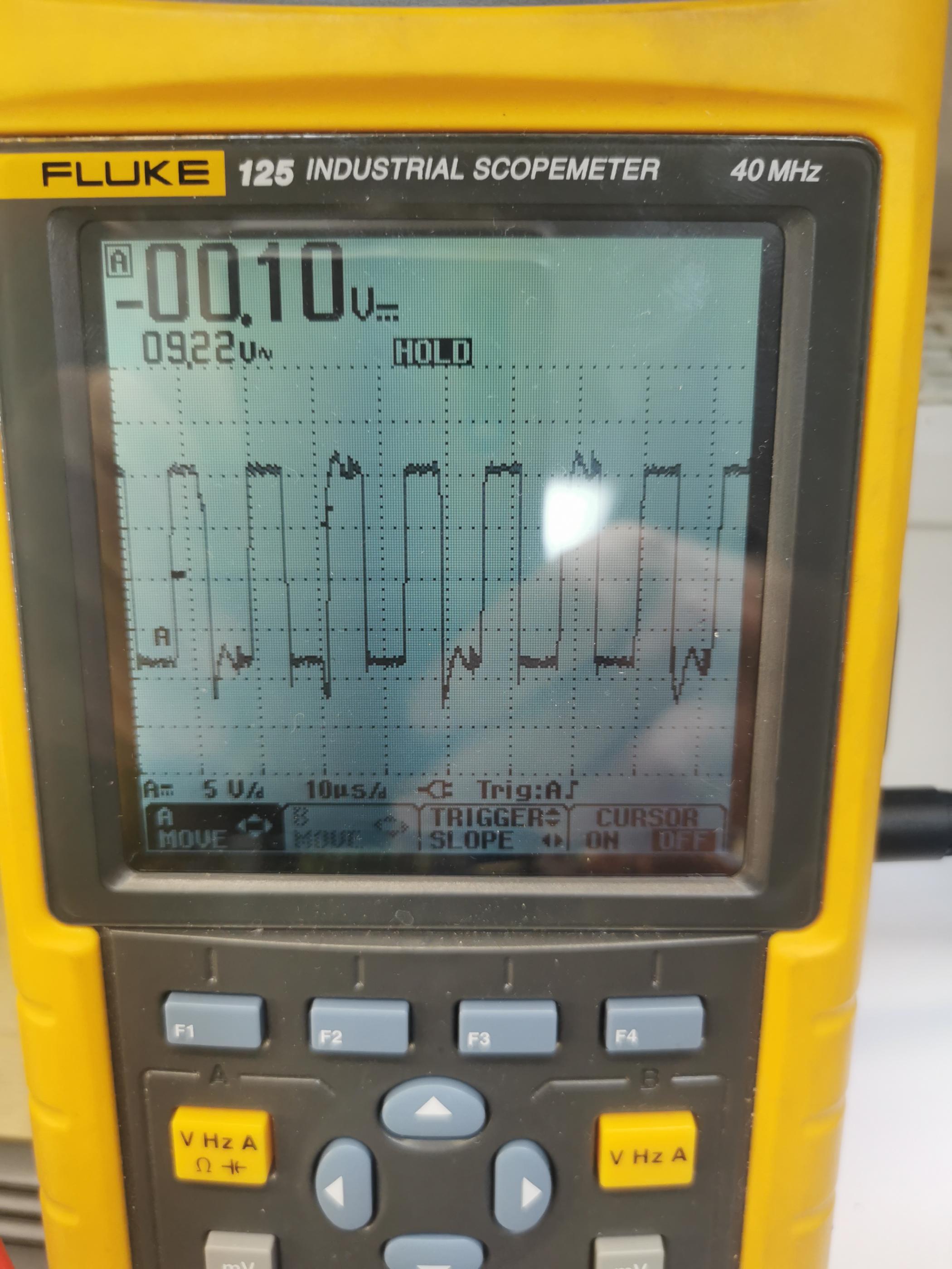

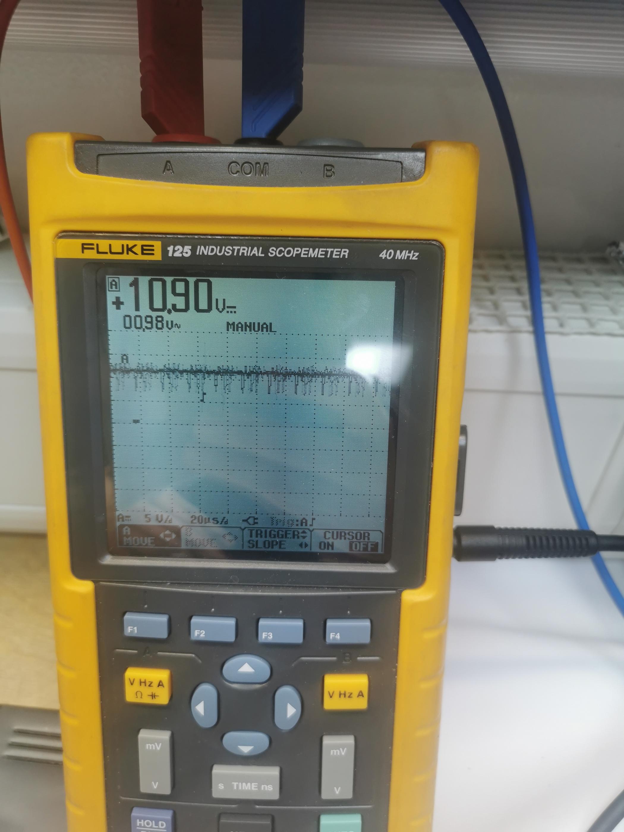

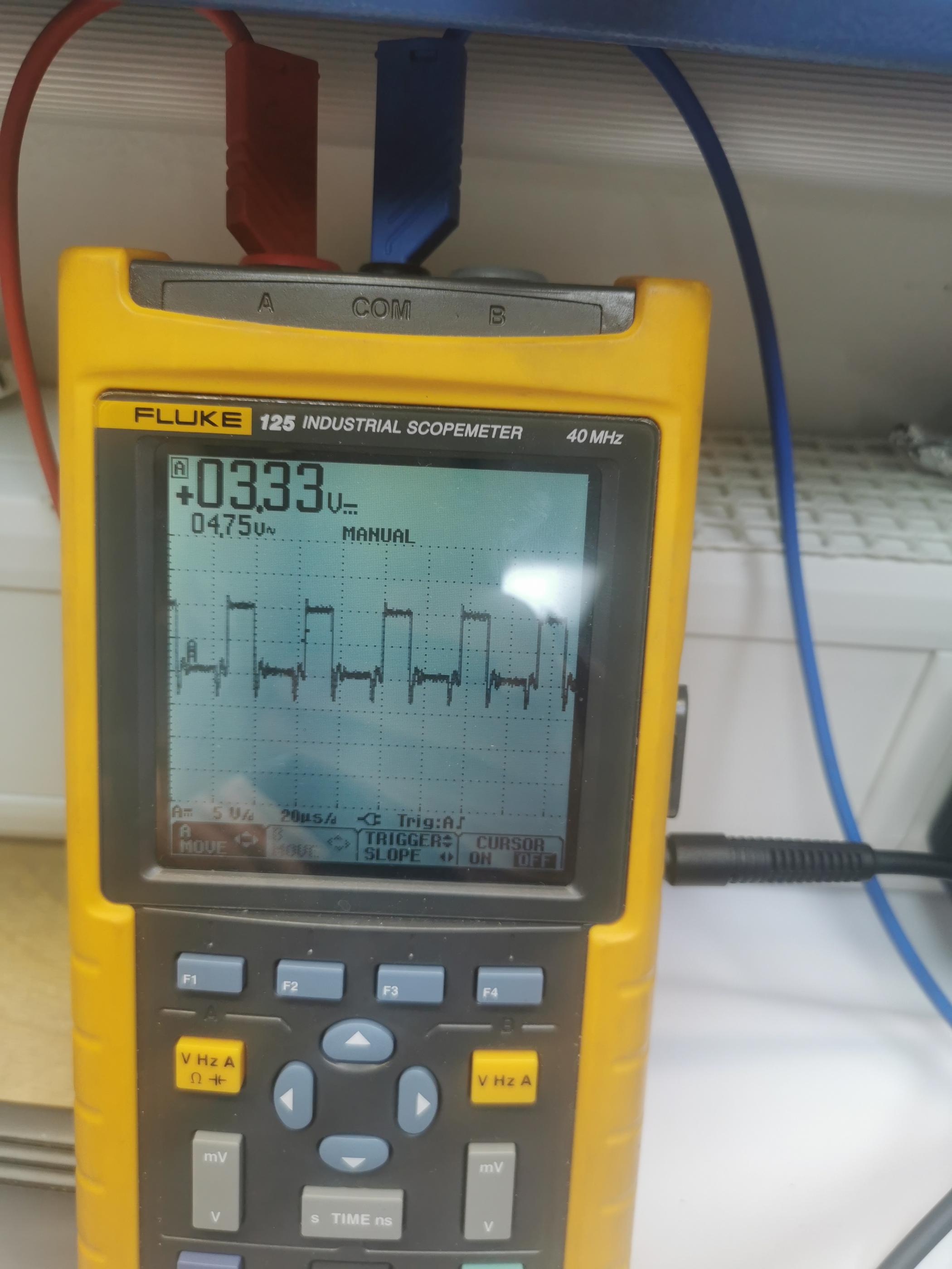

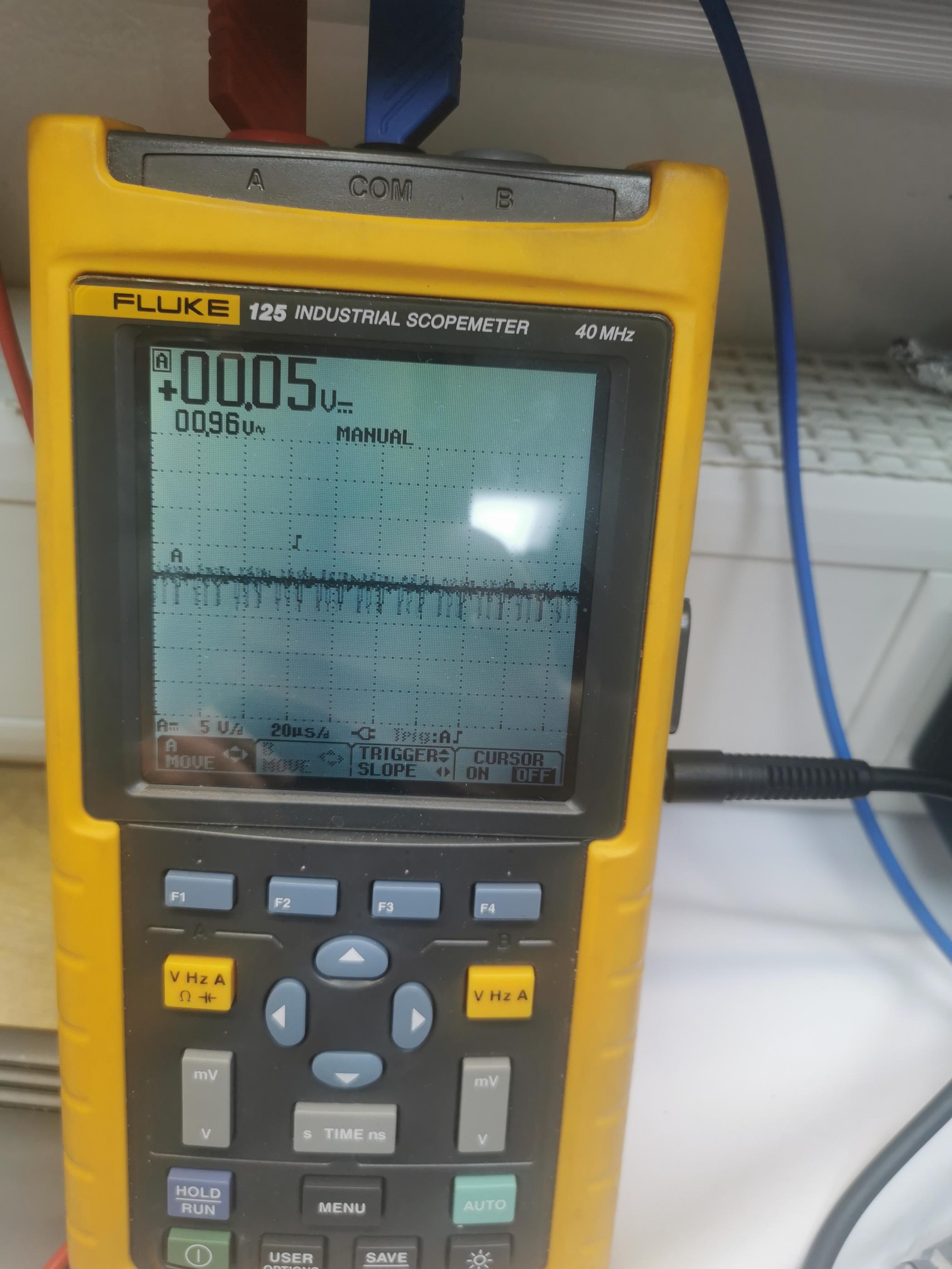

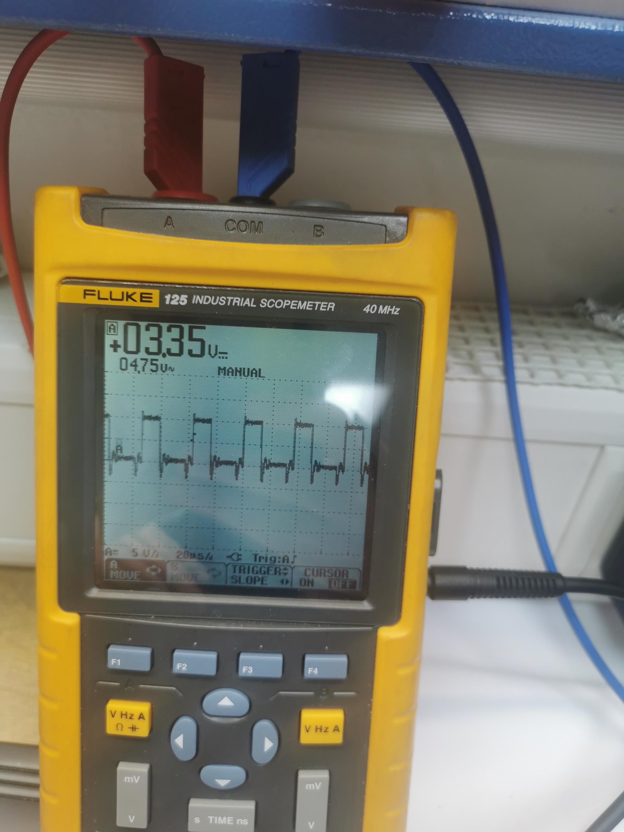

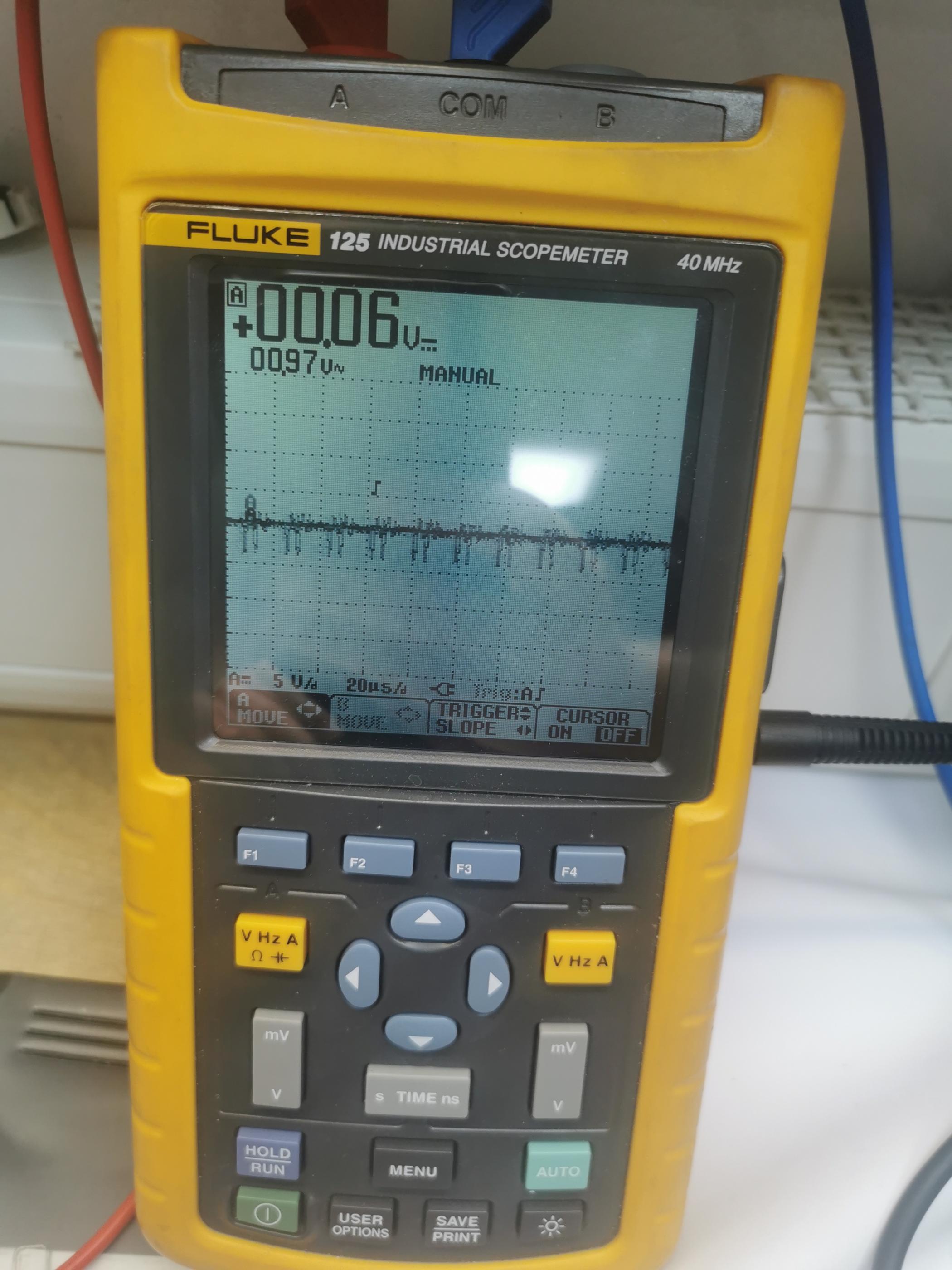

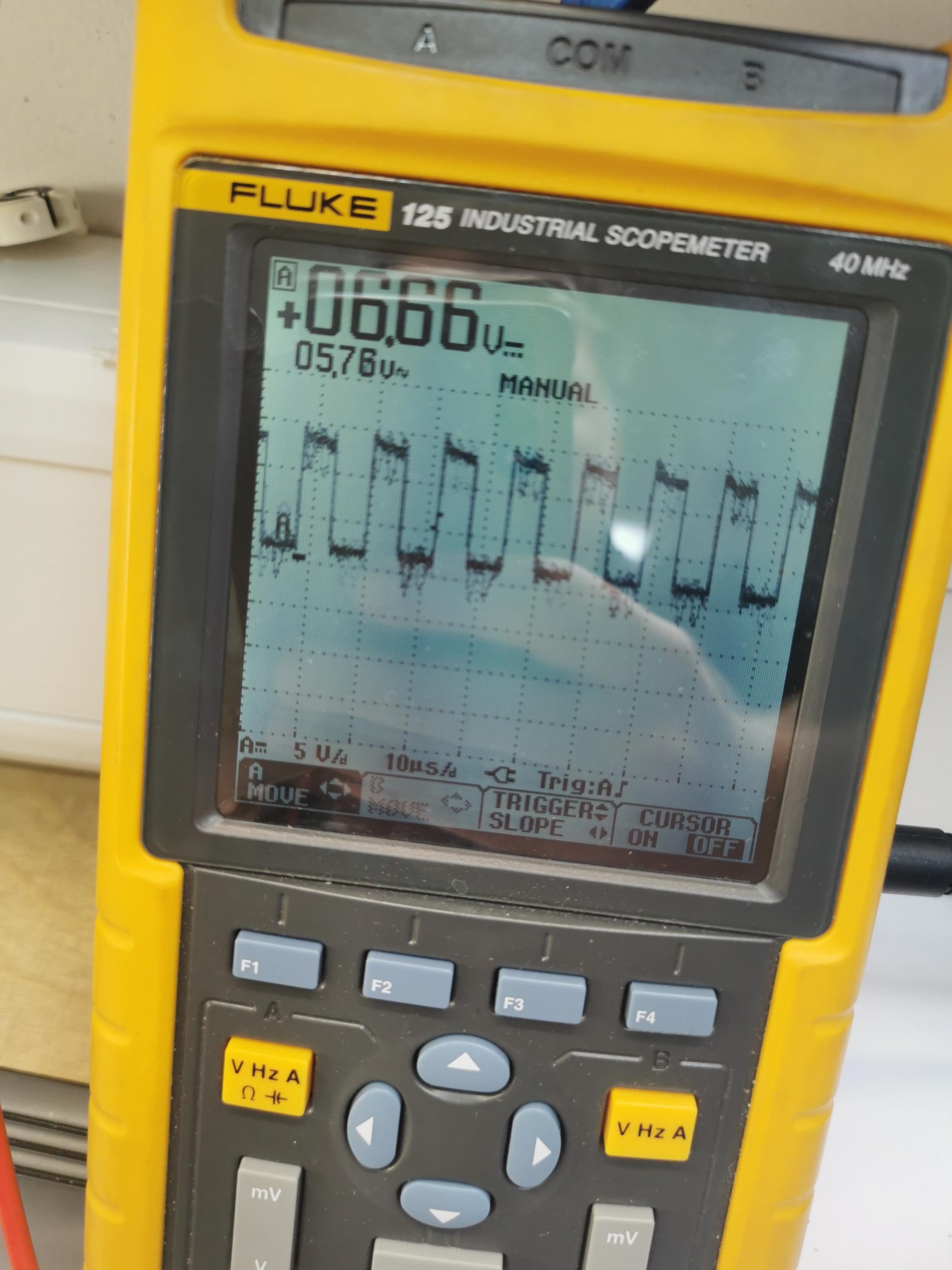

And opened the driver fets on the drive board to check the signal. Highside looks OK, but lowside not. If I put the fets in place, the signal is no square wave anymore. Could this belong to a dead drive ic, or undervoltage?
The IC has one output that's split to high and low drive in the drive circuit.
What points were you probing for the images?
Is there any DC offset on the drains of the outputs?

Have you confirmed that all of the voltages marked on the header pins are correct?
Are you sure that there is no drive on pin 6 of the 4060?
Use a ground that's on the driver board and ground the scope to that to see if the signal looks cleaner.
Be careful not to short to a supply pin when connecting the ground.
