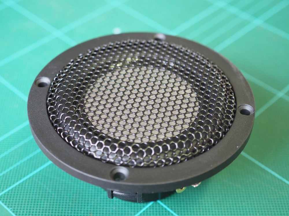

I use SB Acoustics SB10PGC21-4 on my desktop.
It is a good driver for low volume listening.
SB10PGC21-4 has a small magnet and weak driving force, so the sharpness of bass sound is not so good.
The addition of a neodymium magnet improves the sharpness of the bass and the sound quality in the all range.
[ Air-Recording ]SB Acoustics SB10PGC21-4 / normal version
[ Air-Recording ]SB Acoustics SB10PGC21-4 / magnet added version

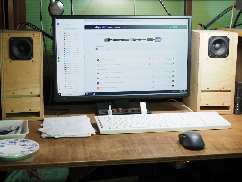

Anyone tried to wall-mount speakers right besides to the computer table, for a flatter low to mid response?
If you're going to hang it on the wall, it won't work unless it's a thin box.
The voice coil has a large diameter and the damper area is small, so the bass is not so high.
The sound quality is refreshing with little distortion.

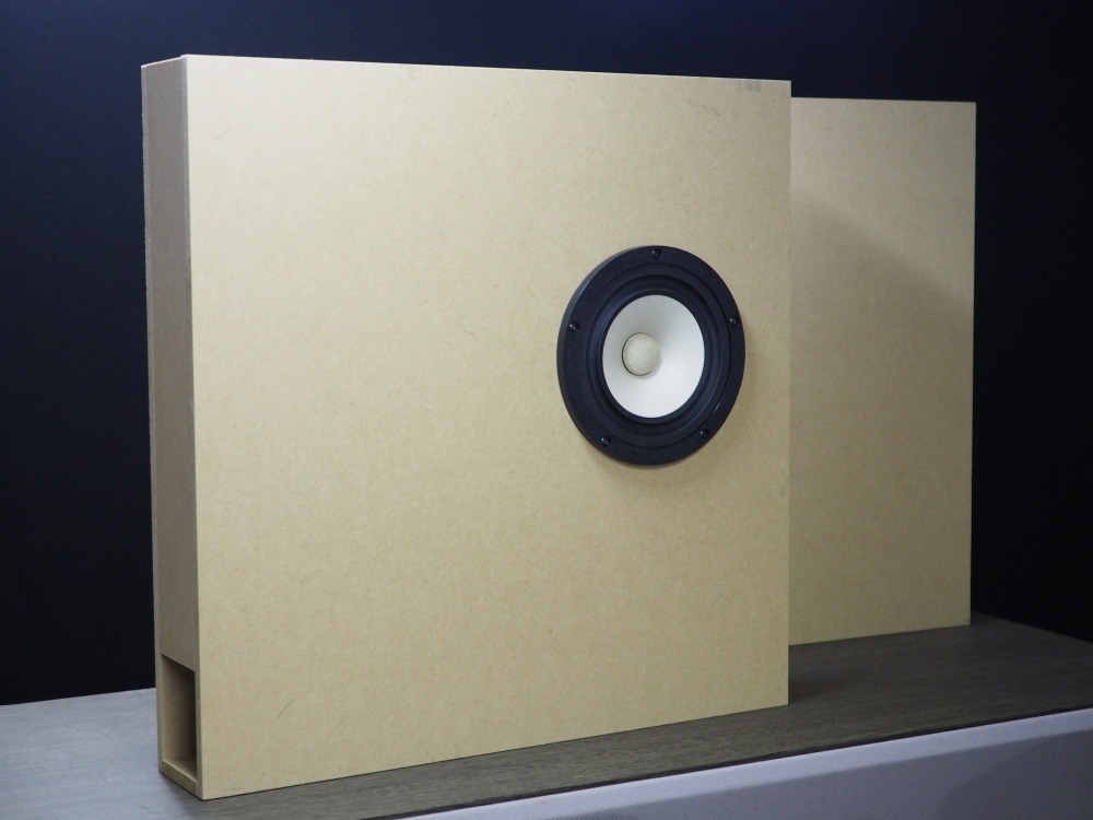

I made a wall-mounted Speaker with CHP90.
I used 9mm MDF to reduce the weight as much as possible, but it is strong enough and I don't feel any vibration of the box.

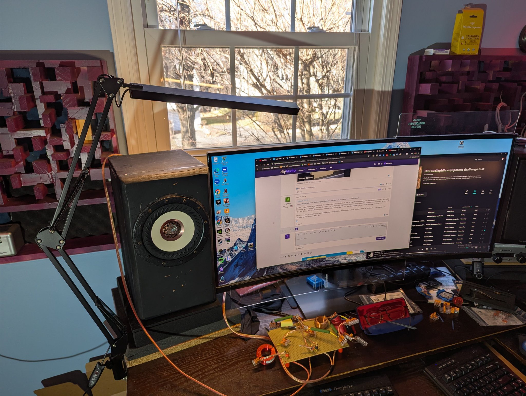

Depends…….is your desk up against a wall? Desktop listening is near field with its own set of performance factors. Full range solutions can work very well if the acoustic space is somewhat neutral to deadened…….meaning off axis response isn’t a critical design parameter. Coaxial drivers like the KEF do very well in the near field…….and the extended bass shelf tuning of the Q150 is ideal for near wall placement IF you can mitigate the early reflections……..Anyone tried to wall-mount speakers right besides to the computer table, for a flatter low to mid response?
If there’s a monitor/ screen, the open space between the horizontal sides of the speakers and the monitors should be eliminated……..this open area is a hells scape for bass response diffraction.
I don't want to talk about myself but yes, a typical computer desktop for which I started this thread looks like this - near the wall and a monitor in between. Pictured is my TB W6 prototype box and the right speaker is Dynaudio Emit. Thanks @perceval for mentoring! Of course I will have to scrap and rebuild this box. It has horrible baffle step and diffraction problems, also the internal size is only 10 L and I need more like 15-17.
The next box will have a much larger bowl-like baffle (think KEF LS50 but a lot more bowl like). The right side will stick out 2 cm and overlap the monitor surface. Essentially I want the baffle to blend with the monitor.
The box itself will use the free space behind the monitor, so essentially the angle between the baffle and the right side will be not 90 but 120 degrees so the box will kind of bend around and behind the monitor.
And the left side will make 80 degrees from the baffle, so it will tilt right, so it doesn't stick outside of the table. The top will tilt up 120 degrees from the baffle, so the reflection goes behind me.
Another option I am still considering is wall mount instead of this purple diffuser. It must be flat but odd shaped to tilt the speaker down and right toward me. The distance will be 2x from my current distance, and I don't know if it's better or worse.
But I want to add as I have other people in the house as most of us should have unless they are audiophile dead head cat boys the wall mount will require higher volume so based on that it should not be an option.
