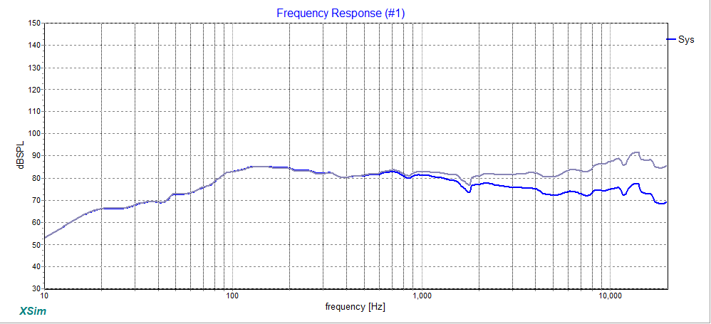

Rolling off the high frequencies is just a minor side-effect that is easily fixed with EQ. One thing I'd watch out for is that the amplifier doesn't run out of head-room if you end up boosting the treble by 10dB or so. Though with most music there is a lot more energy in the bass.

Setting aside baffle effects etc. (separate issues) what you in essence achieve is a higher HF impedance and a slightly shelved low pass effect, which then requires additional EQ to compensate for. Attached: this is the IEC frequency response of P7HD, grey 'as-is', blue with a 0.5mH inductor, 0.05ohm DCR in series. Impedance plot shows the 'raw' direct-coupled driver in a Butterworth aligned sealed box, blue with the inductor added in. Nothing surprising of course, but I can't see what the improvements you mention are?
You can fix the losses with EQ, certainly. But not everybody wants to use electronic EQ (or has the facilities to do so), & in this case, it seems like it's being used to compensate for losses that didn't exist before the addition was made. I'm obviously missing something, but at the moment, I'm not sure what. :scratch1:

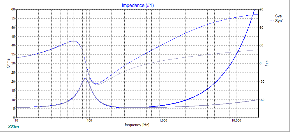

Well, you've got the impedance curve, & as you can see it's a symmetric drive type motor design; there will be some asymmetry somewhere because all drivers have that, but a 0.5mH inductor isn't going to address it (whereever / whatever its specific details might be -you'd need to take Le(x) & Klippel based measurements to know the details & what fixes may or may not be practical.

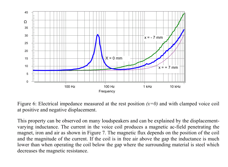

I dug this up from a Klippel paper:
Klippel loudspeaker nonlinearities pdf
Below that they also mention inductance modulation due to voice-coil current. So at high frequencies like 10kHz, the key point is to divide the distorting part of the inductance down to a smaller fraction of the total impedance.

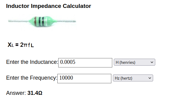

Something like 4.7 - 22 ohms in series is a super easy hack to get a feel for any audible differences, though the weak spot would likely be the bass. A small inductor (say, 500uH, air cored) takes that to the next level, giving 10s of ohms at HF, while passing bass with whatever the DC resistance is. But as you rightly said, active EQ could be a stumbling block.

Yes, that's the Le(x) test (and some more involved ones).
Which is one reason symmetric drive (in Scan Speak parlance -it was around for many years prior to that 😉 ) exists. The more linear your basic impedance load is, the higher the probability it will remain consistent at higher drive levels / excursions. While not foolproof (that's why Le(x) etc. testing exists of course), it's a reasonable guideline in the absence of anything else.
