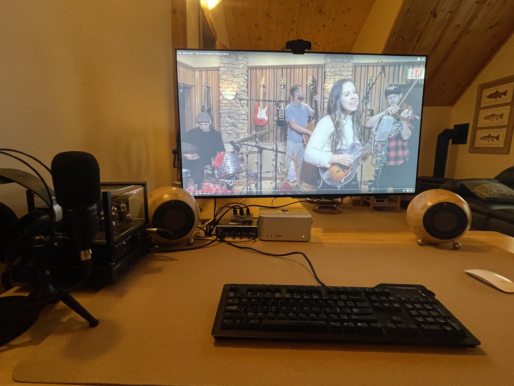

With so much optimization into the system -- do you cover the bare, hard desktop with fleece or something to absorb HF, as you listened well off-axis to the "linear array" of reflection from below? I'm sure your arrangement works; just trying to understand the subtlety of "driver on the reflective mirror-surface" pros and cons. Thanks.
WChang ~ great point and this is the downside of the "surface mounted" salad bowls... I have thought of trying to "fly" them adjacent to the panel but the bracket fabrication task seems a bit daunting. I have measured the bowls pointed out & away from the reflective surface and they are flatter there. Too, they have better bass performance backed up closer to a wall behind them (but the sub covers a lot of that issue). Still, perhaps some desktop pad ideas might be right to try... thx.
Per suggestion, I added a sheet of cork to the NestDesk surface and it did smooth the SPL sweeps some, and it sounds better. It's still a plane in front of the speakers so while they are great, I know there are reflections.

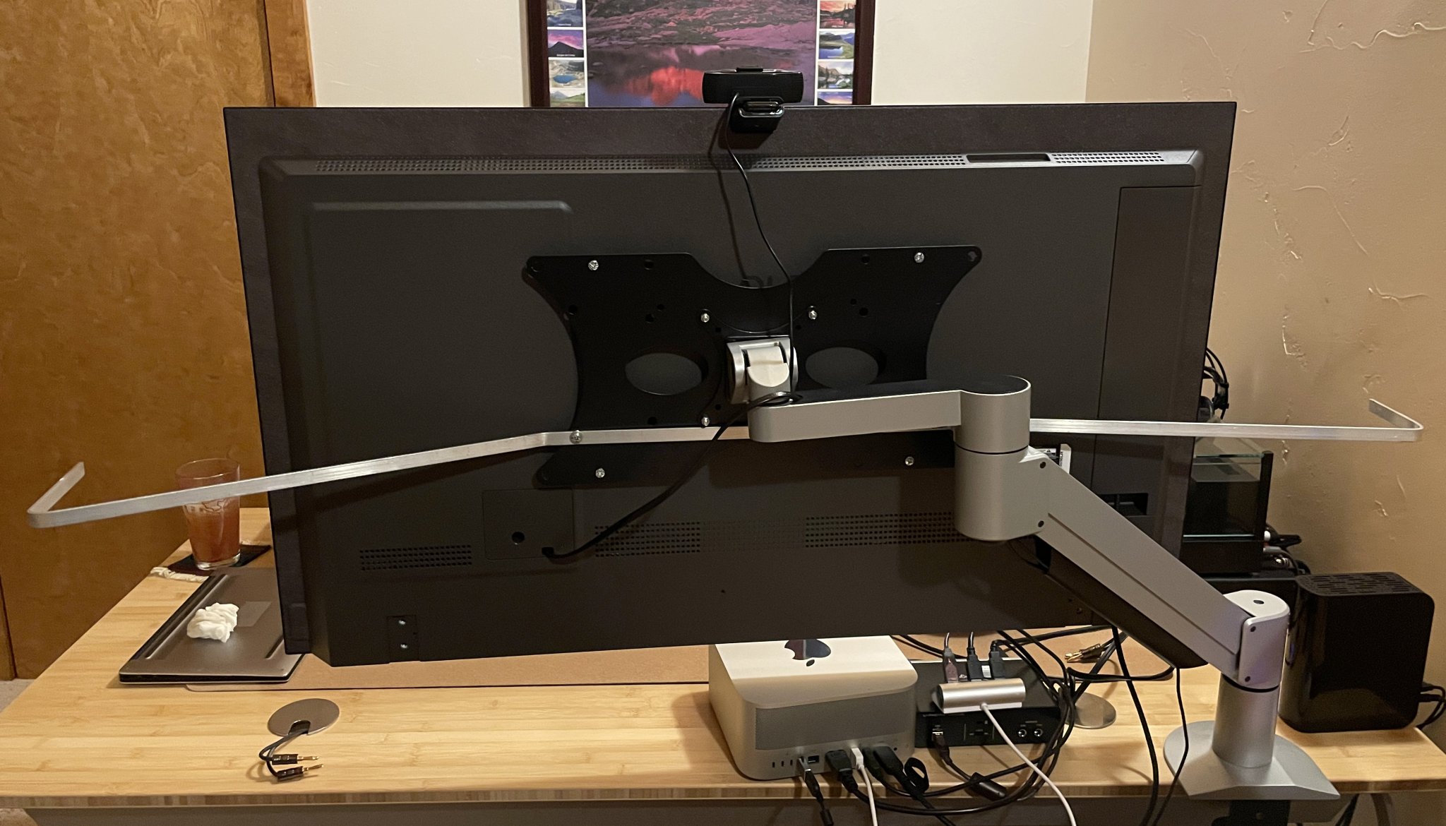

I also built a wild suspension mechanism from 1/2" x 1/8' aluminum bar and attached it to the back of the monitor on the Vesa adapter. I simply hung the speakers on the forward jutting suspension ends via the rear-firing bass ports. It was too wobbly and insecure and I took it down; the speakers are pretty heavy. I'm sticking with the desk pad though.

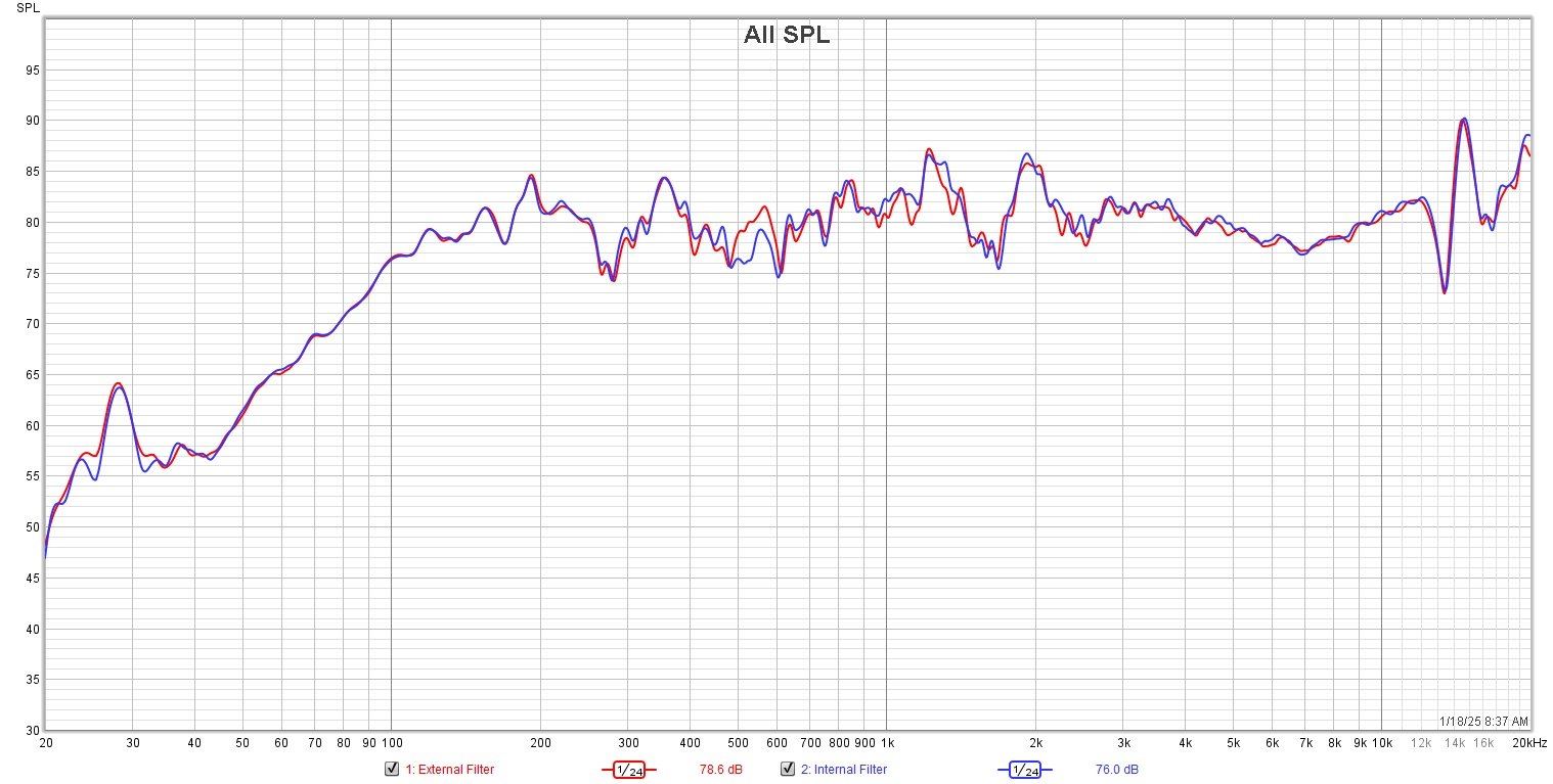

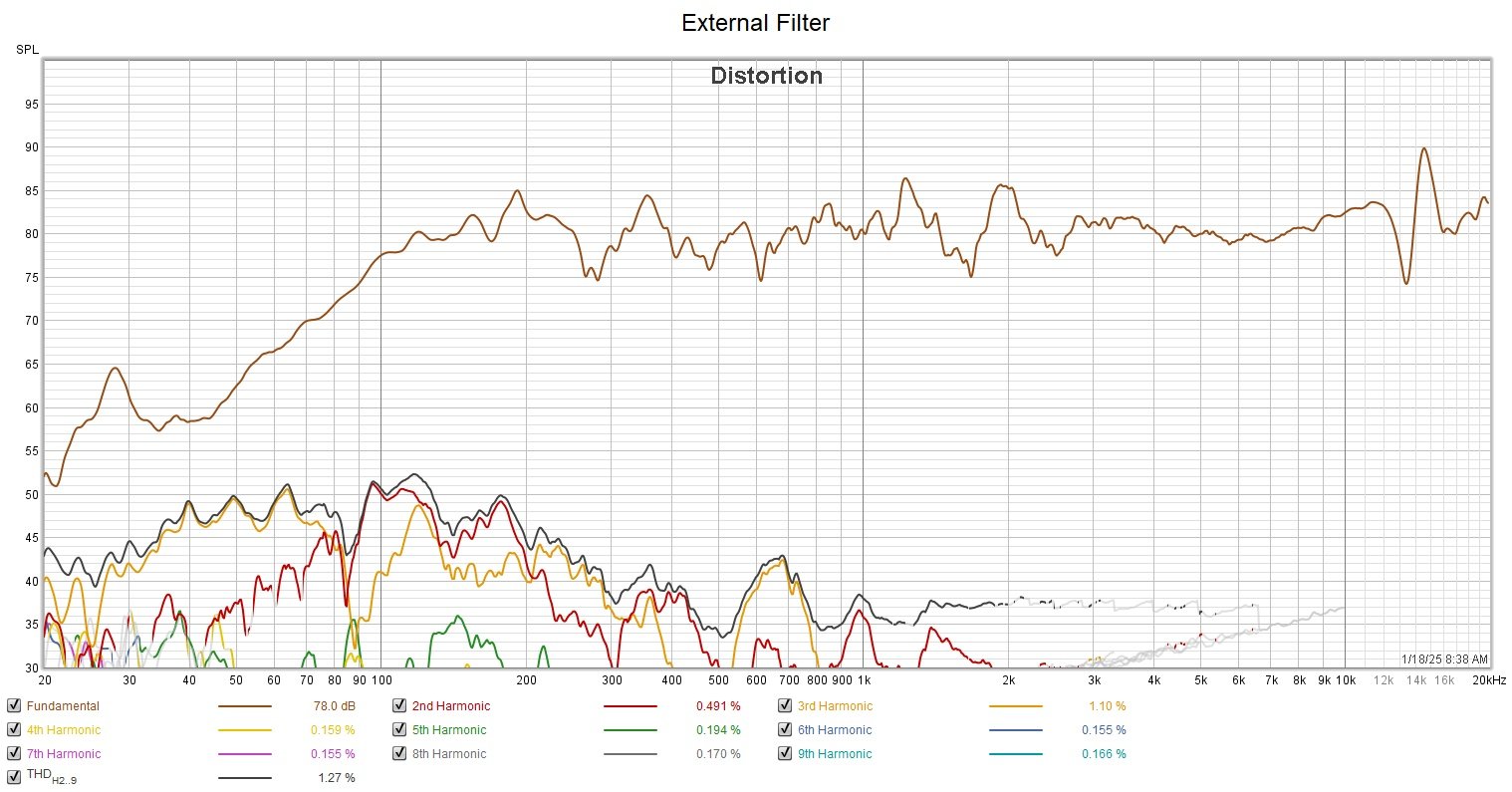

The measured response of the speaker with the external and internal (compact cross-axis inductors) are very close. There is a small difference at about 550Hz but I am nit sure that is due to the filter as it could be partly external since measurement not on same day. Distortion is also about the same. I am just going to leave it as is as this is within acceptable limits.
Comparison of Freq Response:

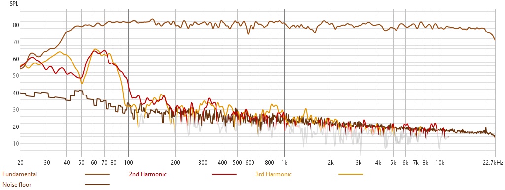

Harmonic Distortion with Compact Internal Filter:
Harmonic Distortion with External Filter:

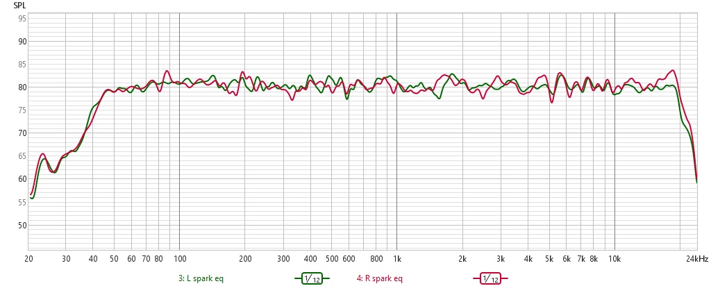

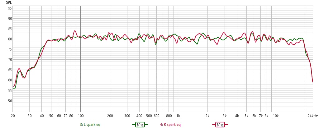

It's a Tang Band W6 coaxial build with passive crossover, and additional EQ to make it smoother. About 20 L sealed, no port as it's near the wall and me, almost headphone mode. Pics in the link above. The curve I'm currently listening:
Measured on computer desktop from my listening position 2 feet from the speakers. Distortion:

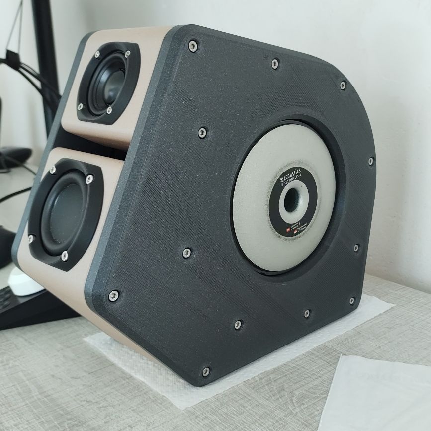

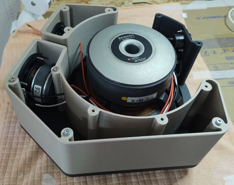

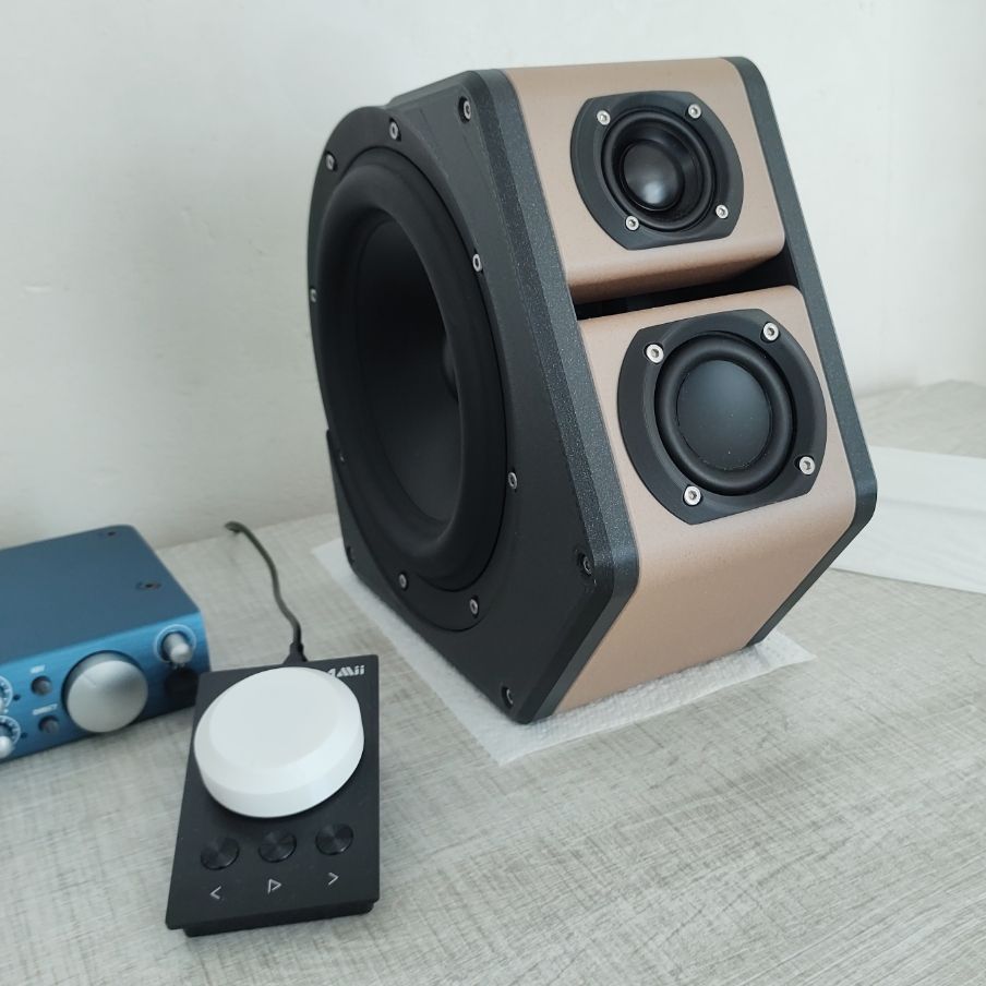

Why not use a multiway wide band configuration ?
The wide band transducer is assisted under 80Hz by a small closed box woofer and under 50Hz by dipole subwoofer ?
It is extremely compact with a 8" subwoofer.
PS : it is an unfinished prototype (lack of decoupling... it rattle everything on the desktop)

Are your little drivers separated from the 8" woofer chamber? If so, then hey can't have much space to breathe inside there.
If not, how do the vibrations of the bigger woofer not affect the smaller drivers? That would cause havoc on the smaller drivers and induce a lot of distortion.
Rattling the desktop... again... unwanted distortions.
You do not seem to be bothered by them. I do. I really hate distortion. It doesn't play nicely with my ears.
I'm happy to see you are trying things as a DIYer. That's what this forum is all about. But to me, it is a direction I will not take. I prefer good imaging, a very good FR and phase, and distortion-free setup.

I have no hifi pretentions, haven't measured the distotion of my loudspeakers, so i will not say how the vibrations affect the rendering if it is the case.
Moreover i don't know if it is usefull to mecanically decouple all the enclosures and if the direct field of the subwoofer really affect the FR driver much very well below its resonances modes.

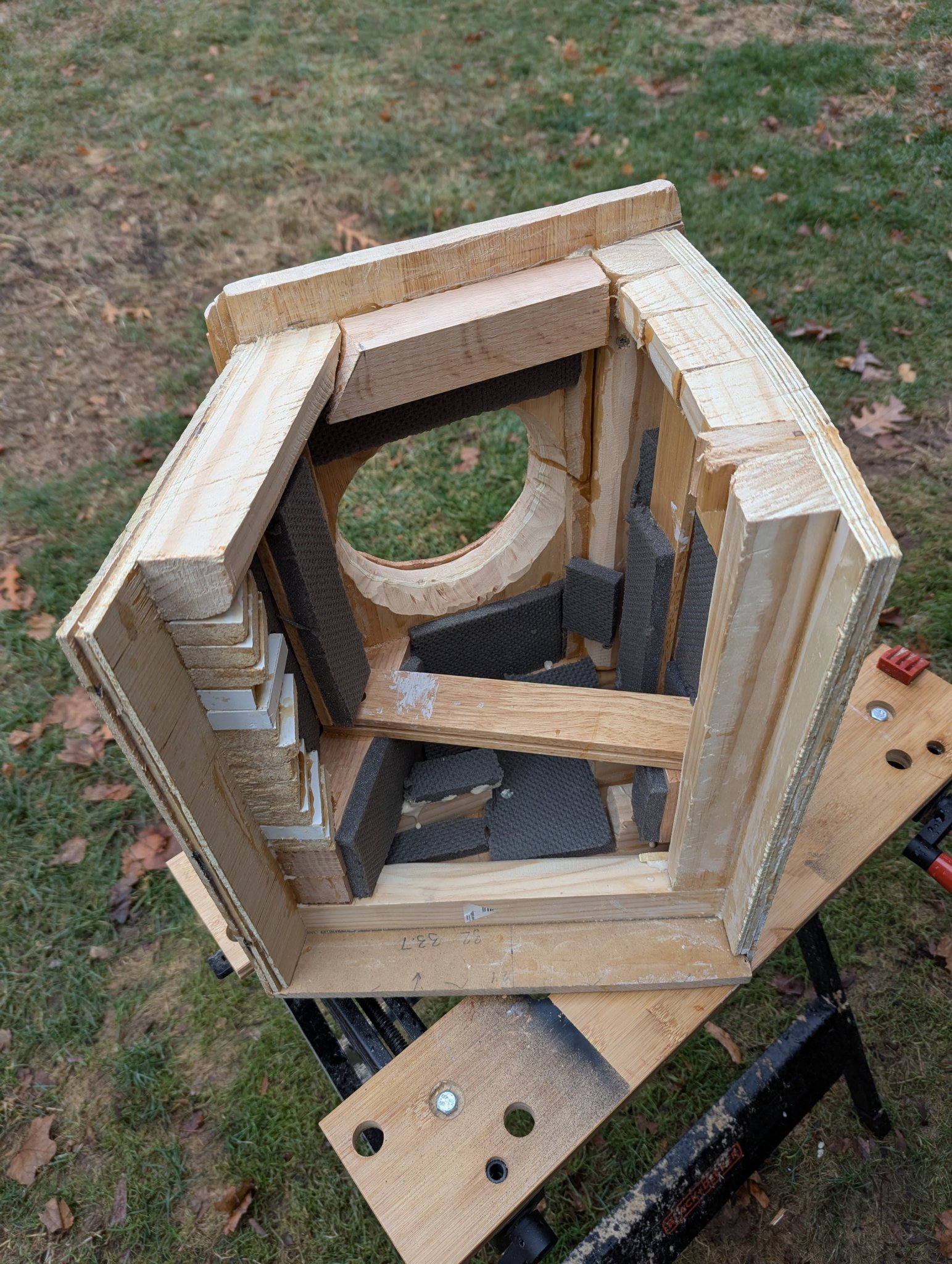

I didn't see how you made the box, if you added crossovers, but maybe with a power supply with a few more Amperes it could still improve the sound. maybe with 15A
It's just a simple stuffed box. The driver in that box doesn't need a crossover or EQ. A 15 amp power supply would be an unnecessary expense and a waste of power. This is a very small class A amplifier which has low power but more then enough for desktop use. The power supply that I'm using already supplies more current than is necessary.
