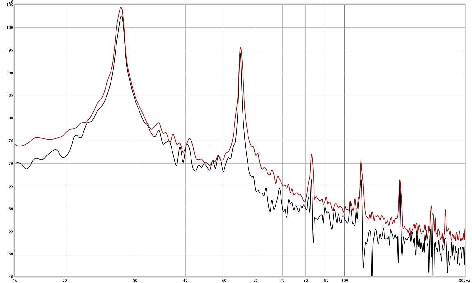

@silverprout amazing project. I suspect the compromise would be to design the crossover the way to make the 8" drive volume knocked down to prevent vibration.
Thanks, I havent studied the crossover right now, the mechanical desing is not finished because the desktop decoupling is crucial and the spikes are not effective. The weight of the speakers should help to rise the self resonant frequency of the dektop plate but the if Z decoulping is impossible, it must be damped properly in order to have a very low resonnant frequency of the assemby (loudspeakers + wood plate).
It implies that the loudspeaker cabinets have to be suspended with elastics like a microphone to achive that utra low resonnant frequency.
I'm confused by this statement. Are you trying to couple the speaker to the desk or decouple it from the desk? And is there an intermediate structure between the speaker and the desk? Sorry if I'm misunderstanding what you're after or if you've modeled this interface and already understand what's going on.desktop decoupling is crucial and the spikes are not effective
Spikes are more typically used to couple.
Rubber feet or other methods to isolate/decouple.
These are just a couple of the off-the-shelf options. Some suggest cut in half racquetballs/squash balls as a cheap alternative (if you already have any of those handy and just want to try something quickly).

Hello, for me the spikes act like a spheric contact on a plane that supress 2 translations an 3 rotations, resulting Tz only.
To be simple as possible, the desktop is a rectangular plane with 4 forces in the direction of the roof (foots) and the loudspeakers are two forces in the direction of the floor. The plane is not perfecly rigid and can oscillate between the 4 forces and the two loudspeakers forces are osilllating, therfore if you supress these oscillations by damping the Tz from the plane, it will stop to oscillate.
PS : i want to have an adjustable inclinaison of the loudspeakers cabinets, the rubber foots are not damped enough and the foam will deform my strucural shell.

Considering the whole assembly of the loudspeakers cabinets and the desktop equilibrium, i will use 6 horizontal natural rubber silent blocks on a frame for each cabinet with an ajusted gravity point or approximaly 3mm of static deflection. It will gives a 6mm of "not too unlinear" damped displacement and around 10mm of total damped displacement.
The frame is coupled with the desktop, the desktop is coupled with the foots and the foots are compled with the floor, the loudspeakers are free to move in every directions Tx-Ty-Tz-Rx-Ry-Rz.

If the cone vibrations form a vector that points exactly to the centre of gravity of the box, the box could be suspended in such a way that it 'slides' without trying to rotate.
It could then be suspended by 2 pieces of fishing line, and a third piece to control the tilt angle.
