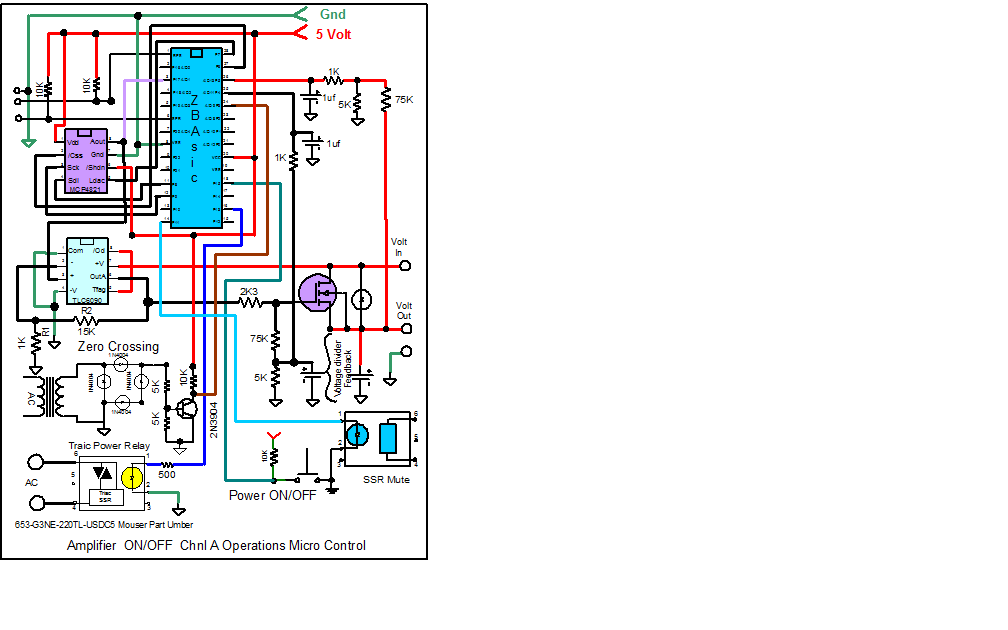

In focusing on the AC control of the power supply, which is better, a Triac controller Opto Iso with built in zero crossing connected to the Arduino or separate zero crossing detector circuit and the Arduino directly controlling the Triac? If anyone has an example, please post it. Thanks
Attached it is a drawing showing the zero crossing that I used to control my amplifier power ON/OFF. The circuit give you a pulse every 1/2 cycle. Also the Omron Triac relay that I used. It is non zero crossing relay. Used 5 volts to fire it. The zero crossing it is at the bottom left of the drawing.
Attached it is a clean drawing one.
Is the connection to the triac relay correct in this schematic? It's connected to VSS on the microcontroller.
Yes, you are right. When I cleaned the drawing I didn't notice where was connected. Any way you can connect it to any pin in the micro. This was an example. Also attached it is an update drawing with the pin connected to the right pin in the micro. Sorry for the overlooked.
Thank you Tauro, this is pretty cool.
Long time ago, I was testing a new 1.5KW transformer at home, connecting it directly to the mains from time to time for measurements, until the building protection disconnected the whole floor (4 apartments) 🙂 Just happened connecting it in a "wrong" moment 😛
I would still leave some inrush resistor though - zero crossing helps to ease the trafo initial start, however we still have some bulk capacitance to charge...

Do you feel it's worth the extra complexity? It's a neat idea but I personally think your chassis mount power resistor is pretty fool proof.
It actually is a pretty fool proof. High-power resistor for 2-3 seconds - works very good.
But as a potential solution for enormously high-power PSU - good to have it in a "toolset" 😉
I do ramped the AC on power ON/OFF using the micro and the zero crossing. By doing so the AC will come slowly up/down. Like your are adjusting the AC slowly with a Variac. I has been do it for about 3 years and implemented it in all my amplifiers built. Also it will prevent the inrush current on power ON.
Yes, I used for it for the Vcc to the micro. The micro control everything in the amplifier. It read the power switch and turn ON/OFF the amplifier. The micro it is powered all the time.

Just to clarified. I do not enable the traic at zero crossing permanently. I fired the traic from 90 degree of the AC sine wave and keep increment the firing in small steps until it reach 45 degree then I enable the traic permanently. I do the firing in both positive and negative side of the AC sine wave. I other word it look like ramping the AC by slowly moving the variac knob up or like using a dimmer to turn the light bulb dimmer or brighter. By doing so it prevent the inrush current on power ON and allowed the capacitors to slowly charge. This is a good application for tubes amplifier. It will allow to filament to slowly heat up while the high voltage also slowly increase. Also will eliminate the filament stress at power ON. This is my theory and do not know if it is true since I do not have a tube amplifier. Maybe the members with expertise in tubes will or can collaborate it. My knowledge in tubes are vague.
