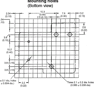

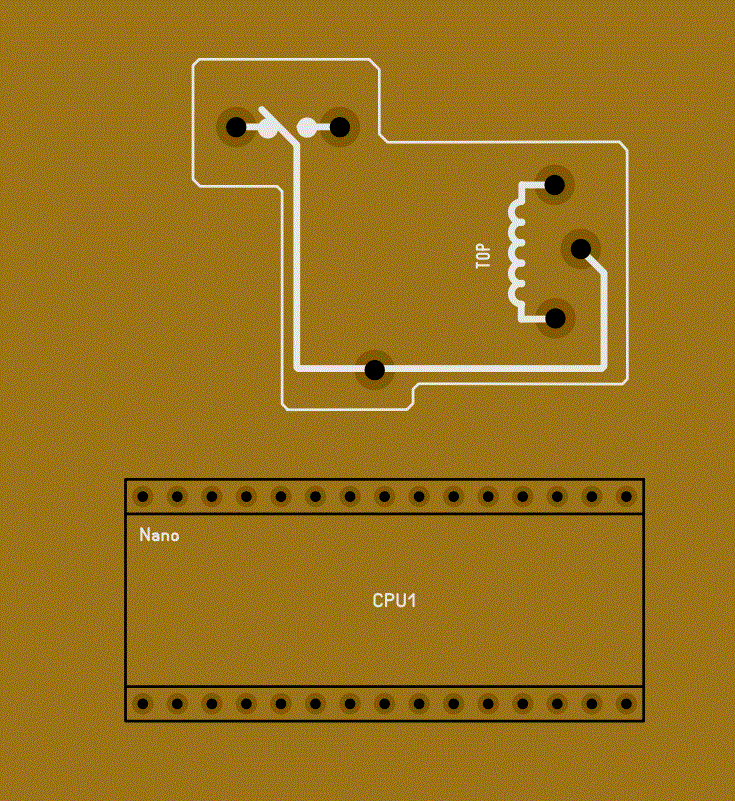

This relay only uses 77mils, could it be used?
G8P-1C4P DC12 Omron Electronics Inc-EMC Div | Z1009-ND | DigiKey

I prefer chassis mount relays personally. I'm on a phone so it's tough to pull up a data sheet but I don't think those are rated for 120/240 vac.
Switching Voltage 250VAC, 28VDC - Max
How large are they? If they are the small automotive version they might be good to keep everything self contained.
