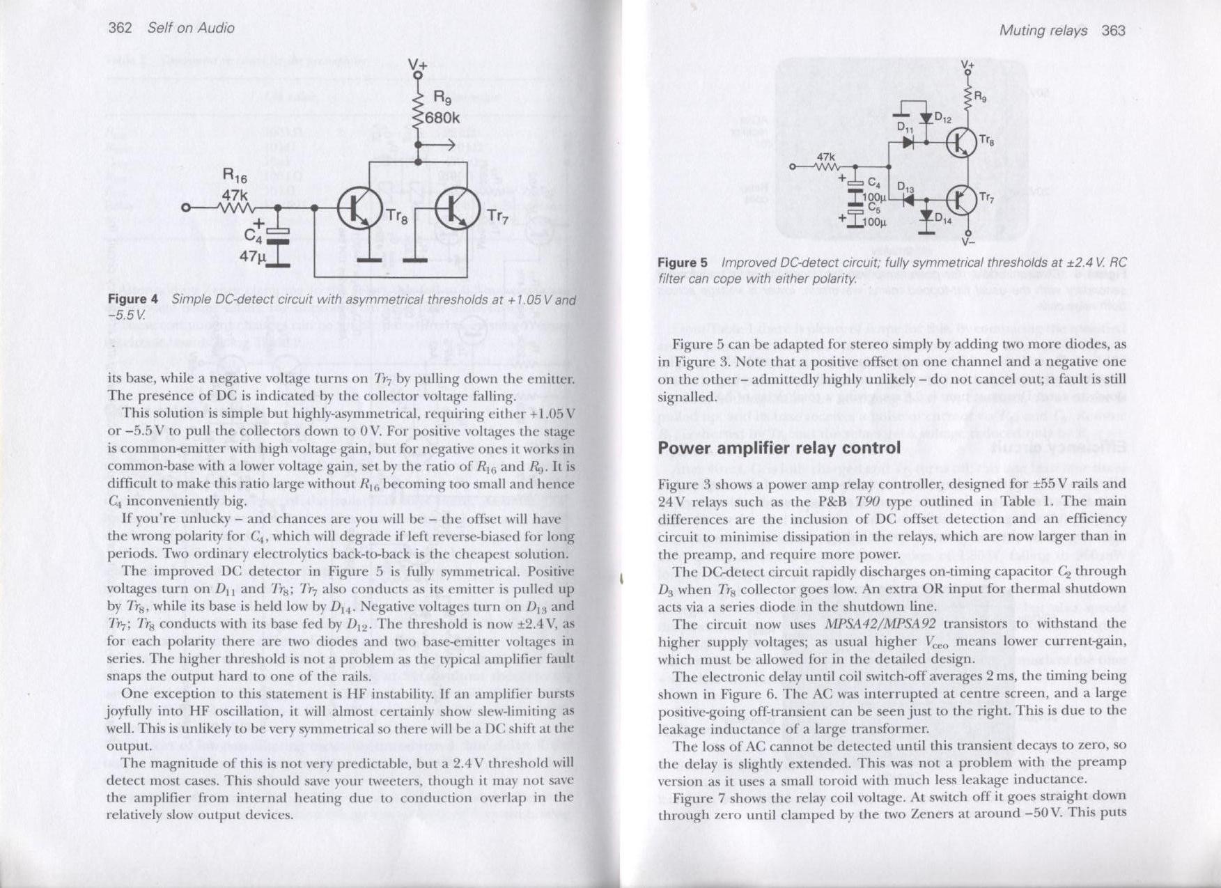

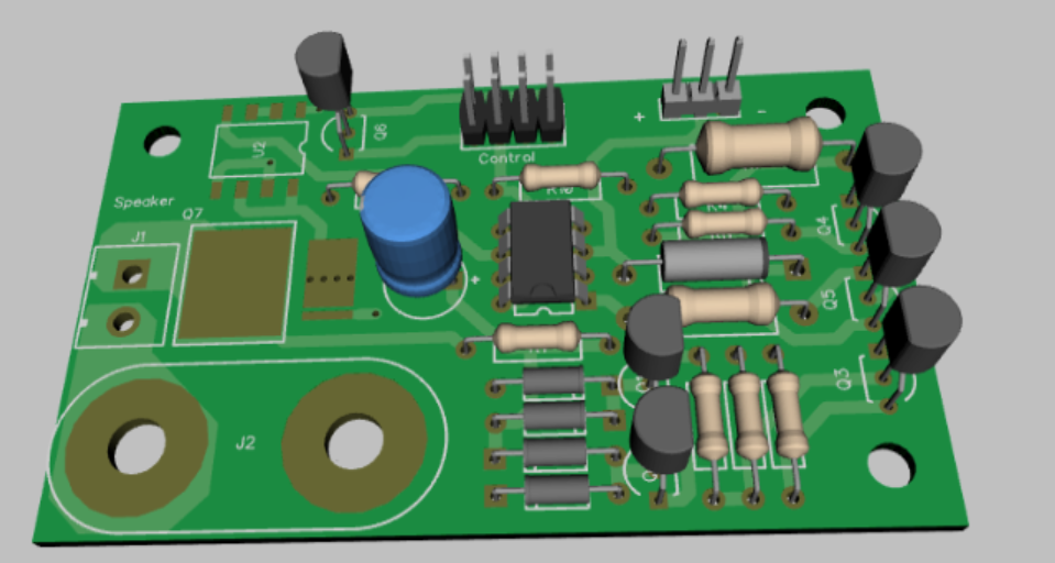

I've come up with an optically isolated DC detection circuit that still retains all the functionality of the last design. As tested in breadboard, detection is activated at + or - 1.25 VDC. As of yet it is untested for false detection on AC signal. It still activates on loss of rail supplies and still interfaces with the main control board the same way as the last design as well. Any suggestions on improvement are welcome before I order some test boards.
Why not test it to see how well it rejects audio(ac) information? It basically comes down the the response of the filter. I assume you are using bi-polar ecaps in the 220-330uF range as everyone else does.As of yet it is untested for false detection on AC signal.
I just wired up an old Hitachi HA12002, since I had one on hand as it was used in the old Sansui G-7500. This is the protection circuit for my 120W/ch amp, I used 68K/220uF. Seems to be working fine. For 200W/channel increase R to the 75K range.
If you have a sig gen like a hp 3325A you have it all in one box, ac and dc offset capabilities. Btw I bought one of thse lately, what a deal for $200cdn!! lots of great finds these days.
I plan to test with AC signal when I'm back at the office next. I was too tired to test last night after I got it up and running (I've got health issues keeping me from sleeping properly). My test equipment is junk, but I have a signal generator that will work.
This is a modified version of the ESP design. They recommend 47uF maximum for reaction speed. I'll know more after some more testing. I'd like to figure out a little more elegant way to reduce voltage for the opto-isolator yet. I would prefer not to run a 3 watt resistor and zener for something like this.
Yes maybe you are correct use two 100uF back to back polarized ecaps as Doug Self does too. We are talking msecs here.
I have not looked at the circuit, but if i am correct you are using the 3W resistor because you are using the opto as the DCV sensing device. If it is isolation you want then sure use the opto, but not as the detector, use the traditional transistor circuit to drive the opto instead. See the attached, you can use ckt fig4 or fig5, put your opto in series with r9 and select r9 for your required opto led current.
I am using a traditional detection circuit. I'm trying to isolate the the grounds so the control board can be used in dual monoblock type stereos.
