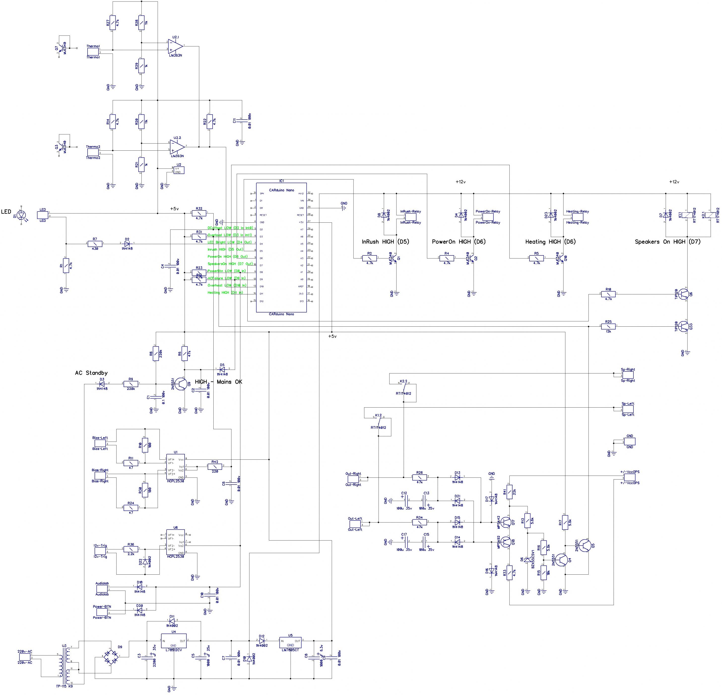

I've got 2 temperature sensors there with comparators, triggering the alarm 😉
I've been meaning to ask what temperature do they trigger an alarm at?
Around 90 degrees Celsius. Easy to adjust with resistors if necessary.
It may be done using analog inputs - I just decided keeping it simple at the time I designed it 🙂
Would you have any objections to me redrawing your schematic for your great system?I've got 2 temperature sensors there with comparators, triggering the alarm 😉

Attached is a hi-res image of the schematic (don't forget to press "eXpand" cross at the bottom left corner as soon as it opens).
Not at all - please go ahead!
I've got it originally in DipTrace. I can publish my souse file - just not sure it will help as not many people use it for layout designs...

The high res helps a lot. Thanks, I see what I can do with it.
I see if I can put a LM35 on a Output lead of a Output transistor and make it track... sort of a side experiment.
It would likely be easy to adapt 2 wire sensors to your existing circuit as well. I want to fire up a heat gun and test the circuit, Just curious how long I would be heating. I think you have the pin numbers marked incorrectly on those temp sensor transistors in the schematic.
Is discrete device output the preferred design or IC based? I personally like ICs for driving relays. Much less clutter on the boards.
Umm... not sure I see what you mean 🙂
They are connected as "diodes". Emitter goes to the ground, collector and base together go to comparator input...
On the MJE340s the emitter is marked with a three. I'm not sure if that is a pin making but if it is that should be pin 1.
I like your IC drive approach - let's go ahead with it
Ah! I see now... those numbers... well, just follow the diagram 😉
Thanks for pointing out - I will check them later today.

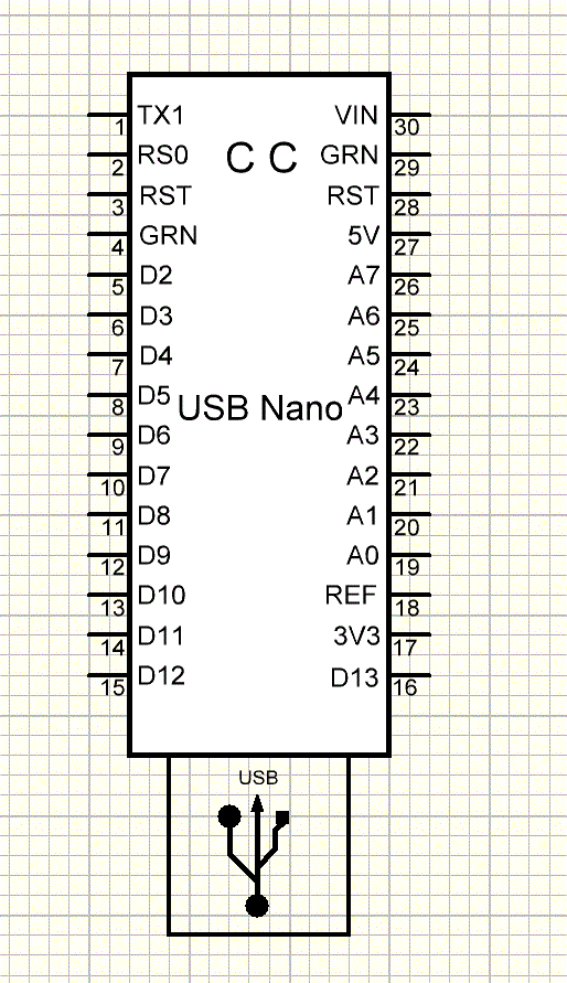

Just wanted to point that out for anyone redrawing the schematic. The highs and lows beside the Arduino are a little confusing as well. Whenever I get around to drawing up my version I plan to add a little truth table for the Arduino pins.
I have this for SPlan 7.0
That's fine. However, some Chinese Arduino clones, have got 2 additional pins at the top, having not 30, but 32 pins in total. My schematic and layout use this pinout for compatibility reasons - I use this 32-pin clone myself.
