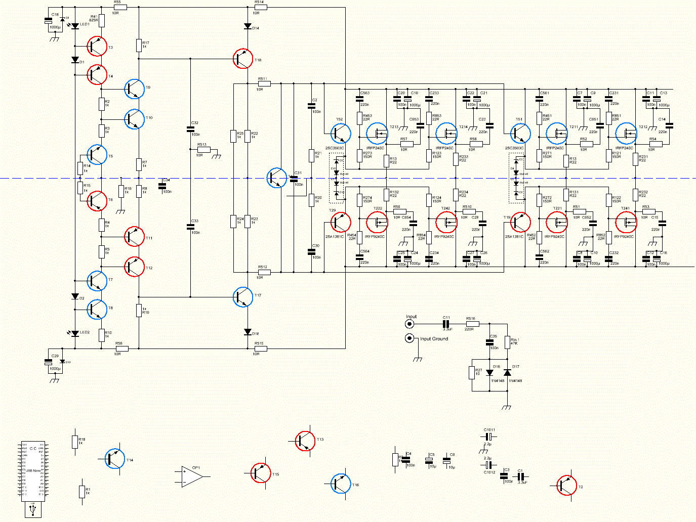

I started but did not finish a redraw of Valery's schematic, it is very hard to see in its present form. You are very correct that his work covers just about everything.
An integration of his work into an existing or under development amp would be interesting and educational too.
Are you drawing it in LT Spice? I need to redraw it as well. I've modified his design a bit.
I was using SPlan 7.0
Does LTSpice do opto iso too. I would be pleasantly surprised if it did.
