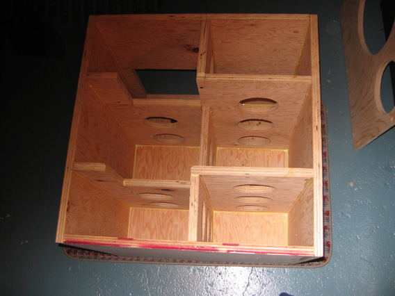

Alright.. Well it looks like I'll probably use that last design I drew up. I keep trying different things, and I'm not liking the results. I'll be constructing out of Baltic Birtch Plywood except for the rear port piece and the braces (I'm a cheap bastard). I'm also limiting myself to these materials as this is what we have at my workplace, so I can get them at a reasonable price.

OK... Final design is complete, and I'll be building it on Friday. Laquering will probably be done another day as I'm sure there will be enough cussing for one night. The only downer is that I measured the BB plywood we have at work, and it's .574 inches thick, or 14.45 mm. I'll still be using this, but I'll probably resin the interior sometime soon. The braces and the long piece of the port will be 3/4" MDF to save on costs.

That looks much better, but looking at it I can see a few things I would do differently. For your consideration...
1: The braces in the cavity behind the driver I would make more like a multipane window and add one or two vertical braces joining them all together in both planes.
2: When in use I would have the port mouth, AND the driver as close to the floor as possible.
3: I have a gut hunch, and others may care to comment, that the bracing in the port may be better with regular large axial opeings between sections to make it more of a reinforced one piece port with braces, rather than acting as 4 seperate ports.

Also, I finished the cabinet today and I'm very happy with the results. I'll post pictures later

Alright.. here's some pictures.
