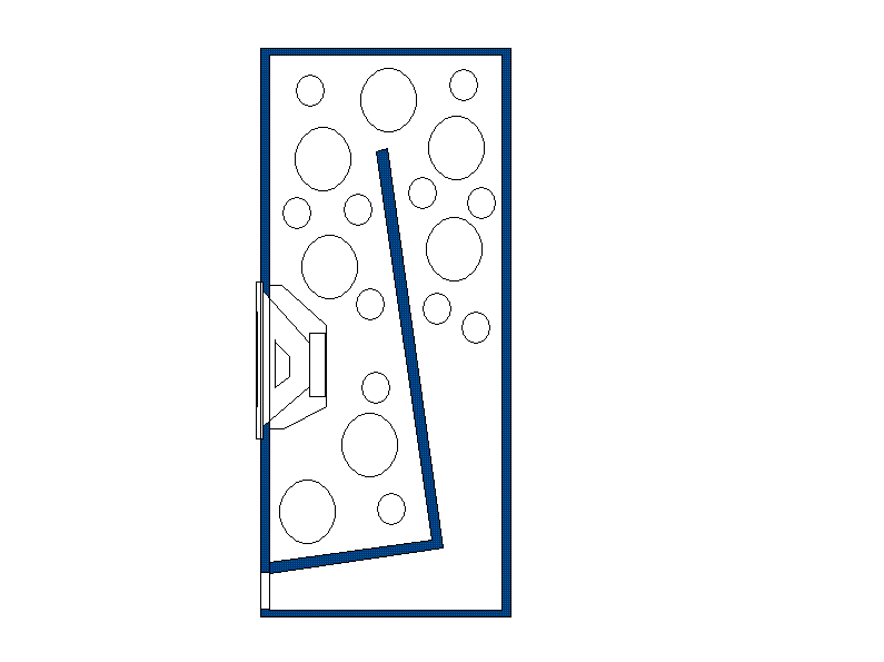

If you can live with a box that big, you might as well make it a TL. TLs are much more tolerant of design errors than bass reflex.
Here's how I did it before.
There is a full brace down the middle (that which has all the holes). This will give you amazing bass.

Well I've been looking at doing a TL, but I havnt the slightest clue on how to do one. I think I'll stick with the bass reflex.

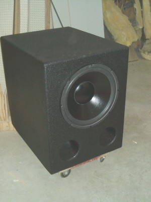

You may also not need to bend the ports either, depending on your box volume and shape. Here is a picture of a box I built for an Adire Malstrom about 5 or 6 years ago. It was very large, Maybe 13-14ft3 and had a pair of 6" I.D. PVC pipes for vents. They only went along the bottom of the cabinet and ended up about 8" from the back. Also, 2 6" I.D. ports have plenty of area for the Malstrom or an SX 18. Tuning was right around 18Hz, IIRC..

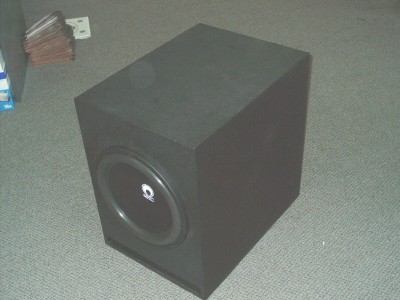

Here is a picture of an SE15 for a set-up almost identical to what you want to do. There is a Dayton 1000 watt plate amp on the back of the thing also. The vent and cabinet are smaller than what you would use, but proportionaly, similar. The vent went along the bottom and about half way up the back for a tune right around 20Hz.
