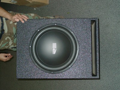

Same set up again, this time for an SX like you have. This was only a 15 though, almost the same box as the SE. They both work great for music/movies in boxes like this. Just use enough bracing inside the enclosure and built it solid. I also like the ports on the front and bottom always, it is a preference of mine. It always seems to make the sound more predicable to me, maybe I have just had bad luck with the port in other places, but I have built maybe 50 or more subs like this for home audio and have always had good luck doing it this way. I like to have the cabinets sprayed with Line-X by the way...

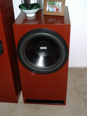

I bet you would be very happy with the results of that design. That SX 18 will hammer out some serious lows in that box. Your port dimensions are almost exactly the same as my XXX 18 enclosures I am currently running for my H/T right now. They were just about right on the money with my calculations and they are absolutely devasting, I don't think I could have done better........

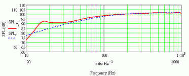

If you fancy something a bit different, here's one idea -a mass loaded tapped horn (not the TD style - driver front vents to the room).
Total line length is 120in, folded in half for a 60in tall box. Internal width = 19in. Depth of the sealed end = 6.0in. 1:4 taper ratio, depth of the 'open' end is 24in. In the open end is a 5in diameter 8 3.5in long vent. You can either have it firing vertically (suggested) or horizontally, as close to the end of the line as possible. Driver is mounted 32.75in down from the open end. Line the box from the sealed end to just above the driver on opposing faces with 1in acoustic fiberglass.
Anechoic FR attached. To this you can add the usual approximate +3db from 100 - 40Hz & +6db below that figure. Impedance curve is nearly flat, excursion is 1mm total for 1w / 1m at 15Hz.

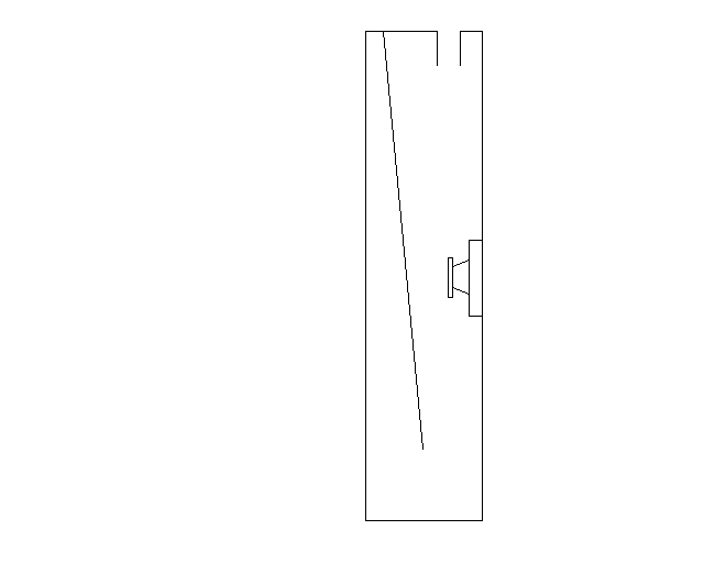

To be completely honest. I understood maybe half of that.
Would you be able to draw a picture out for me? This definately sounds like something that I would be interested in.

Badly. Drawing is not exactly my strong point. Side-on view. Total line length is 120in, folded in half, as you can see, for a 60in tall box. Narrow bit is 6in deep, wide bit 24in deep (cabinet is 19in wide). The vent is 5in in diameter & 3.5in long, firing upward in this case, though if you want to move it so it fires horizontally, be my guest, so long as you keep it as close as possible to that end. Line the box with damping material from the narrow end all the way down that half of the line, & up the 2nd half of the line to just above the driver, the centre of which is mounted 37.75in down from the wide end.
