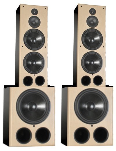

WAIT! I've got it! Build it as designed - because it will sound good, but place it on top of a a 3'h x 3' wide by maybe 4' deep separate box with an 18" pro sub with the same finish. Viola- 3' taller and waaaaay more impressive! Use a separate plate amp for this. You could built the MAgnas first without the sub and enjoy them while earning/making the subs.
Post 44 has info about some 18" subs. Here are some that will go lower: Parts Express #299-444. You could also put the ports on the sides of the Magna in order to move all the drivers down some more. When you add the subs you might want to plug the ports as it makes them easier to integrate.
Best compromise might be to built the Magnas as they are designed which would have the tweeter at 3' height (perfect for listening while sitting) when the boxes aren't on top of the subs and then make the sub box about 30" tall so the when the magnas are stacked on the subs, the tweeter will line up with ear height of a standing person. Parts express gives box designs for the 18" subs mentioned, They don't really have to be those exact dimensions as long as the interior volume is the same. Probably you should download Win ISD to get a better idea if bigger boxes would go much lower.

So I'll put in a vote for your Magnas on top of an 18" sub. Wow, that's a lot of speaker!

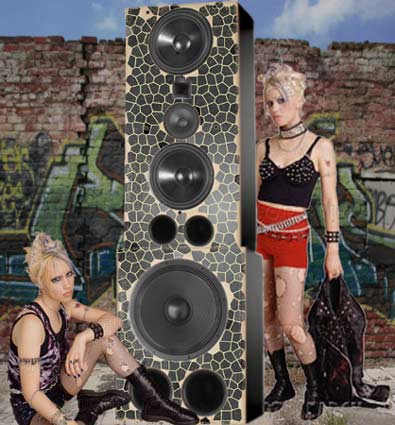

lndm Those rule!

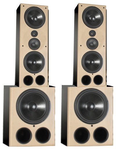

Should be about 7 feet tall.
Damn, if our Punk buddy doesn't go for those, he's crazy.
ldlm:
Fantastic rendering. I especially like that you created it by just enlarging the lower part of the upper speaker!!
Hey, guys: Considering the frequencies involved, would it be ok for punk to put one of the 12" drivers ABOVE the mid and tweeter? This would lower the tweeter to a height that would actually align with a (standing ) person's ears!
So it would be from the bottom:
Subwoofer, woofer, mid, tweet, woofer.
I think punk wants a horn tweeter. Well he should build it like the plans show, but with the tweeter on a removable panel. He could then make another panel with a horn tweeter and substitute it with a new crossover until he got it right. In the mean time he can listen to the designed dome tweeter.
