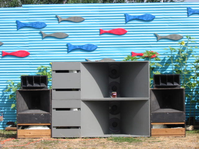

OK Punk...I think I have a very nice idea!
First of all, I really think you will need to build horns to get where you want
1. Frontloaded bashorn - you can drive it with a cheap plateamp; you dont need EQ, and not a lot of power
Advantage - no passive crossover components to muddy things
- you will need only one woofer - you will get high SPL without a lot of movement - and its the best way to get bass with PRO drivers, not very deep, but excactly what you want - and its adjustable
2. Midbass - well we will have to find big fronthorn fore a 10"(?)
Advantage - you will need only one driver(?) - high SPL
3. 2" compression driver/horn with wide FR
4. Depending on midhorn you may want to ad tweeter horn
Advantage - at this high frequency you need only a small condensator
OVERALL Advantage - you will have only one crossoverpoint at 800-1000hz with passive components - simplicity(?) - its possible with 6-8 ohm - and I think you could pull this thing off, that is if you can do the woodwork - and its BIG

are we saying that 120dbA is a sensible target to meet the brief?
100db/W to 105db/W for a folded horn bass with 100W of amp power just gets there but the box will end up about 23cub ft=650L (based on Labhorn volume/length/mouth). and that's just one channel bass driver.
when corner loaded, times two when floor/wall loaded.
