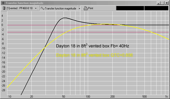

As for the 18 boxes - 8 feet (227L) looks good for each driver. With 2 x4" ports the box could be tuned flat with long ports or peaked all the way up to +6dB @ 50Hz with just 4" cutouts. Easy for Mr. Punk to tune it the way he wants.
Below you will see a modlel graph of the Dayton driver in an 8 foot ported and sealed box. Tinitus - I looked at a lot of sealed box volumes, this driver just didn't model well sealed. The 3dB peak you see is for more thump. A lot of it will go away with the driver's natural fall off and of course baffle step. But it should sound nice and bassy. Changing port length gives more or less boom.
There we have it!

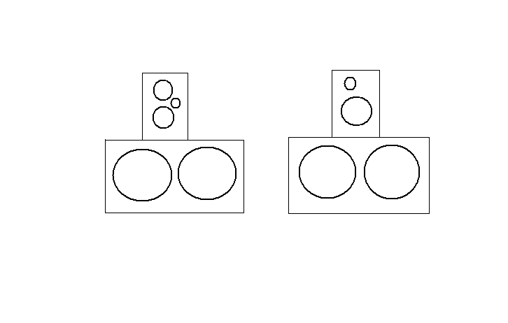

OK Punkr, now Pnomaniac has calculated the size of your boxes. Just use the volume he calculated to design the boxes. Make them all the same depth and width. His number a couple of posts ago is for one 18" driver
If the 12" box will have too big a volume just put in a partition part way back (a "brace") to get the size right
Draw it and scan it or use a drawing program and post the image here!

Ok, So I've got my driver selection.
4 Dayton Pro 18" woofers
2 12" BetaLTA mids
2 Selenium drivers with waveguides
Is this right?
Now that's done and over with.
Finally...
Where can I can a drawing program though?
the only way I can think off would be to use the Microsoft paint, which would be extremely difficult even for me being a good artist and all.
Can someone get all the data together though cause I have no idea what internal dimensions I'm supposed to be using .
That would be awesome if someone did.

We have the tools to show whether or not a pair of 8" drivers will keep up with a pair of 18" drivers, or if something more is required. I'm going to walk through this with the assumption that later on you'll get two 18"s per side, and will drive them with their full rated power.
Looking at spl_max1.xls from http://www.linkwitzlab.com/page_index.htm, , and taking Sd for the 18" woofer to be about 1500 cm^2, Xmax to be about 6 cm, and max power to be about 512 watts, and sensitivity to be about 95 db/w/m, we can see certain things about these woofers.
If you have two of these woofers on a side, driven with about 1000 watts shared, you are excursion limited below around 100 hz, dependent on your bass reflex alignment. Above that frequency, you are power limited at around 125 db at one meter. This doesn't tell us anything about the bass since you're going ported, but it tells us a bit about how hard the midrange needs to work to keep up.
One 8" woofer has a radiating area of around 300 cm^2, and about 3 mm Xmax. Because you're using this sealed, the excel spreadsheet DOES tell us something about its excursion in its lowest reaches. If we pick a 400 hz crossover, then the single 8" driver can do 120 dB, limited by power handling. Adding a second 8" driver doubles power handling and adds 3 db to efficiency, allowing you to reach 125 db with the mids at a 400hz crossover.
The 12 inch drivers give you better sensitivity, but they really don't give you much better power handling. As far as I'm concerned at this point, it's either two 8"s or one 12", but no need for two 12"s. A single 10 doesn't look like it will keep up with two 18s.
More on the tweeters in a bit... if I get around to it.
Thanks Joe,
I'm afraid most of us posting are having more fun talking than getting anything done... A breath of fresh air to get your input.
Punkr:
Pano gave you the internal size of one bass box for one speaker. I assume that you are making 4 bass boxes, and two combo 12"/waveguide boxes.
So first why don't you calculate the size of a bass box?
He says 8 cu ft, which is 8x12x12x12 to get cubic inches
13,824 cu in.
Then take an arbitrary width and height that sounds like about what you want, and then see what the depth would be for this
lets say 14" wide and 30" tall 14x30= 420
13824/420= 32.9" deep Is that a depth you like? or would it be better to make them less deep maybe? Well, make the box wider then. Maybe the height is wrong, so calc what that does to your width and height.
Remember these are internal sizes so you have to figure the finished boxes will be 3/4" bigger in every direction. (use 3/4" ply minimum)
Maybe you can just make a sketch and scan it and post it , or just tell use the proposed dimensions in words...

Next you have to design the combi 12" / tweeter box.
Use the width and depth of your bass boxes. See what the height comes out to match the size Pano spec'ced for the midrange.
If height isn't at least 18"( to accomodate the 12" driver, some space around it and then the tweeter waveguide) then you will have to make the internal volume smaller by adding walls on the inside. What I do is build a small box around the tweeter and horn to keep vibrations from affecting the tweeter horn. This also take up room which you will probably need to do. Of course subtract the outside volume of the tweeter box from what is available for the midrange driver.
