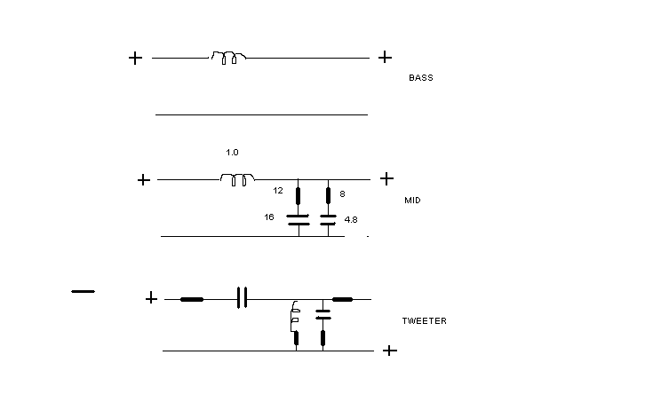

Got some values on my mid filter
If you run mid all the way down and only cut bass 6-12db around 150-200hz...you might get that extra midbass you want....but could be too much though...and might make phase problems
Looking at "BLUE..." tweeter filter....a bit strange values....could be that ressonance peak at 2khz
Drivers with a "mild" and very wide rise can very well sound better not touching it too much....depends on its nature....but coming from 12LTA which you say sound nice as fullrange...well..
But it will give a higher crossover point....so if you will use that from "Blue..", it will have to be modified a bit....maybe not
Ahh..."Blue..." tweeter filter...overlooked that last resistor....explains that small C

Re the midrange, it has a rising response as Pano said, like a lot of wide range drivers. IT is very tempting to put the low inductor in to roll off almost the entire band width of the driver by 6dB. There are a few different places to do it though. If you guys decide we need a crossover at the top (low pass)instead, then we do it, no problem from me.
BUT, it seems that out choice is a low inductor on the mid or a cap and inductor high up. Which sounds worse? I kind of like the low inductor only, but we really don't know...

Variac: Looks like an inductor of about 2uH would tame the bump at the top of the Beta 12. Don't know if we really need to, but it might be a good idea if he runs these super loud. That mid bump could get annoying really fast. Sure would pop out the vocals, tho.
