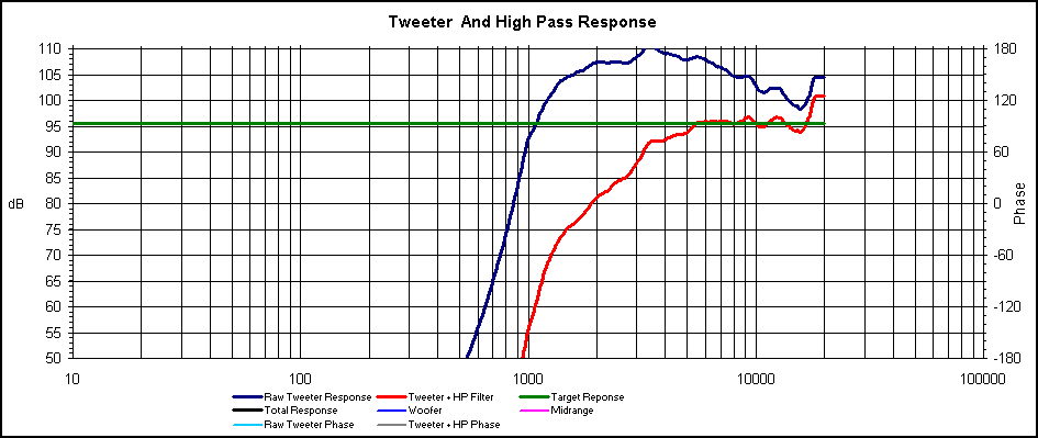

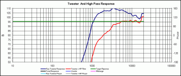

I got a start on a filter for the Eminence compression drive and the little wave guide. See below:
This is simple 2nd order high pass with C=1.5Uf L=0.37mH. There is an L-Pad (2.4 & 20 ohms) to bring it down to the 12".
The filter assumes that the wave guide does not alter the measured FR of the driver much (as stated in the Blue Wonder project.) Of course the worry is that peak at the top inherent in this driver. When we tilt the response up, the peak looks even worse. I don't know if it will be a problem, or if there is a fix. TBD.
FWIW, the Selenium D210 looks a little smoother, flatter, so may take less work to get sounding good.

Well, keep in mind that you can correct the tweeter with components too..
Truthfully, I run my Seleniums with only a simple second order crossover at 3000 and they sound great. They don't sound like they are missing treble. Weird but true
Yes, but small corrections are better...
Trouble is that just below 2khz you hit several impedance resonance peaks...will affect filter slope
Sorry, wrong...theres only one at 2khz...rest is from horn....but its there still
Wrong again...2khz ressonance...also from waveguide...I think
So, no problemo I guess

Tinitus, don't worry about those impedance peaks. Once you put attenuating resistors in the circuit, those peaks flatten right out. I had to learn THAT one the hard way. L-Pad = goooood.
