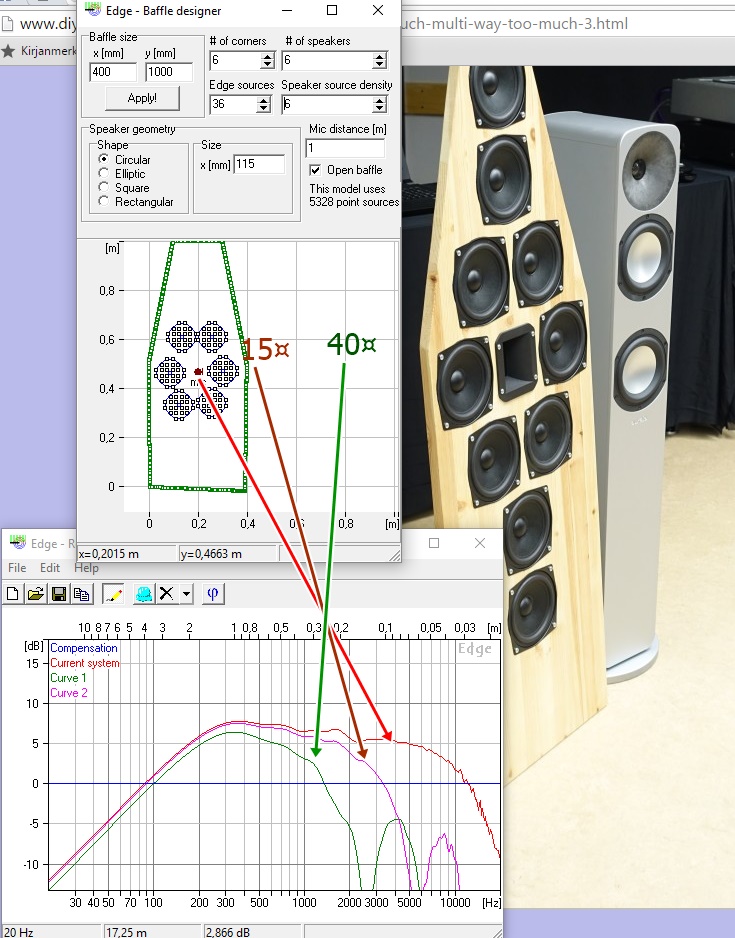

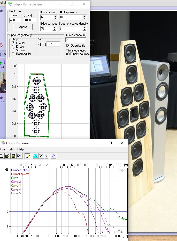

Here is a dipole speaker with 6 mids around the tweeter. It is a passive kit published in a Finnish audio magazine. Perhaps "dipole" isn't a good idea here.
