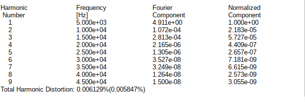

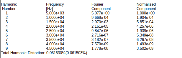

Below a certain value, THD has no meaning. But the THD should not vary much within the audio band, remember that an instrument has a fundamental and overtones. If the the harmonics has higher distortion than the fundamental, the instrument sounds different. Attached is a simulation of my amplifier with and without global feedback. Even without feedback, the THD is too low to matter. But in reality the amplifier is used with feedback to reduce offset and output impedance.

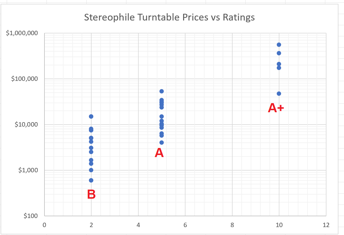

Looks like a correlation to me, just assigning 2,5,10 values for B, A and A+ The R^2 is 0.74
