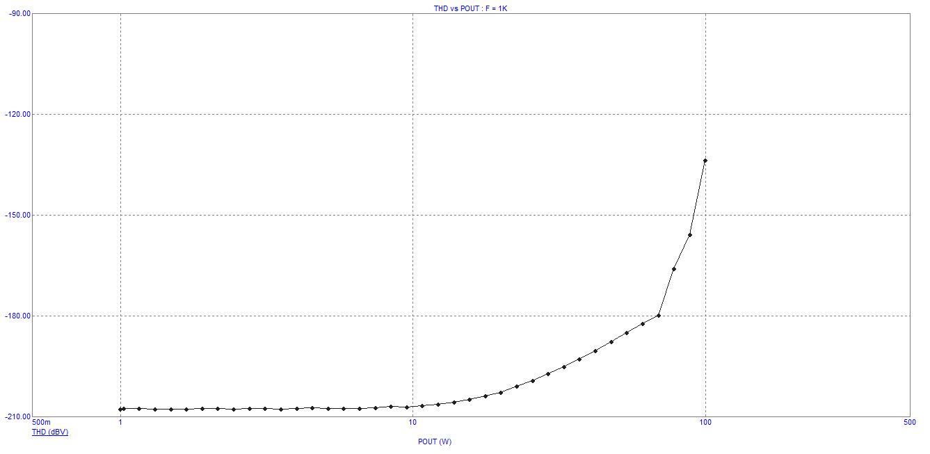

Do you mean like this ?Most natural sounding is an amplifier that has monotonously increasing THD vs. level, that is vanishing THD at low level and increasing with level up to a reasonable (low) amount.
My view is that IMD is more important in listening quality. If you listen to complex music, amplifiers with modest IMD sound indistinct, and I have been able to hear more of the separate muscial instruments with amplifiers having lower IMD.
IMD can be worse than THD, but amplifiers with low THD generally have low IMD as well. Therefore, whle THD may not be the best indicator of musical quality it is a measure of how an amplifier's IMD will perform. Therefore, I suggest THD is important for that reason. FOr if you have high THD you won't get good IMD.

Put two signal sources in series at the two frequencies you want to evaluate. Make sure the combined peak does not exceed the amp input voltage limit and cause clipping. You need to run the simulation for longer than a single frequency in most cases so that the subharmonics (f1-f2) are appropriately calculable, with a fine time step (at least on the simulator I use, which does not have a built in IMD function either), then perform the usual FFT on the results. For example while I might run a 1kHz signal for perhaps 20 cycles, with 100ns time step, a 19kHz/20kHz signal needs to be run with the fineness of 20kHz (10-20ns) but the duration of 1kHz (20ms) to give a sharp response in the FFT at 1kHz.How can I measure IMD?
I mean in SPICE.
I don't think my software has that option.
No. If the gain varies with amplitude, the transfer function will not be linear and that will show up as harmonic distortion.If tone 1 alters gain symmetrically about the middle, HD may not show up because the tone is only modulating itself with perfect linearity. But if a 2nd tone is added, more complex interactions may then become apparent.
You don't need to consider IMD separately from THD. Just make the transfer function a straight line. I will award bonus points if you do that without a lot of global feedback.
