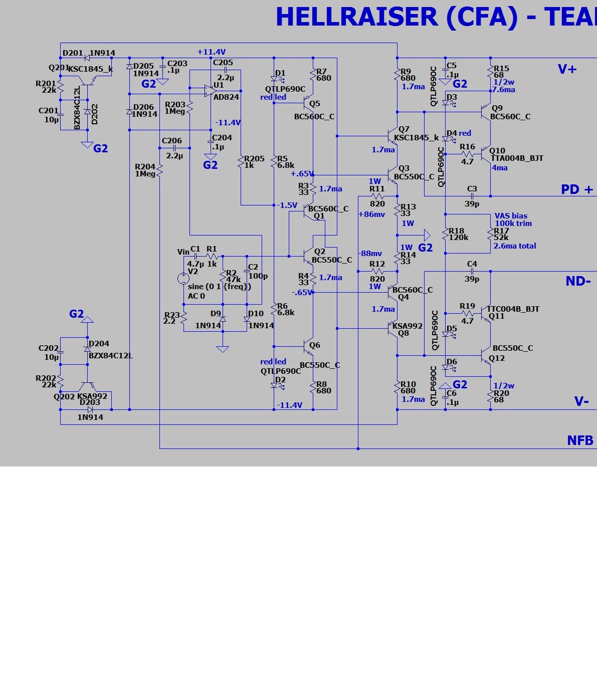

Even as I design PPM amps , I don't feel that is what makes them sound good. For a full range system - the IMD distortion , slew rate , and
damping factor are far more important. Being fast enough to recreate a complex waveform with multiple frequencies and negotiate the "jungle" of
impedances that the speakers present is the top consideration.
Layout that does not create a bad environment for audio is also important. Some SMPS's do this , but can be isolated by adhering to the "rules" of
keeping your analog and digital separate.
If you ignore all the OEM garbage coming out of Asia these days , we are lucky. SMD , better components , and lots of design information make designing
utter perfection (Wolverine) possible even for a pitchfork villager like me..... he he.

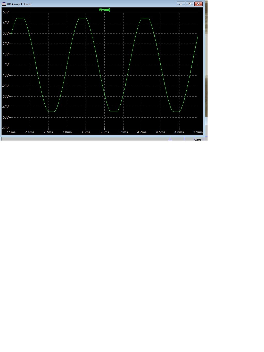

Only in 2020+ can we put 3ppm/20Khz-300V/us ... at 100V p-p on a credit card sized gold plated FR-4 for <10$ (below).
This is my next design to give to the community. (below 1) 60W/120W EF3 to go with it.... or lateral FET ??
And what a good bass/sub amp ... overdrive it and get very little content after 1k ! my cascode acts just like a valve stage... (below)
"hellraiser mini amp" will be the thread heading.
