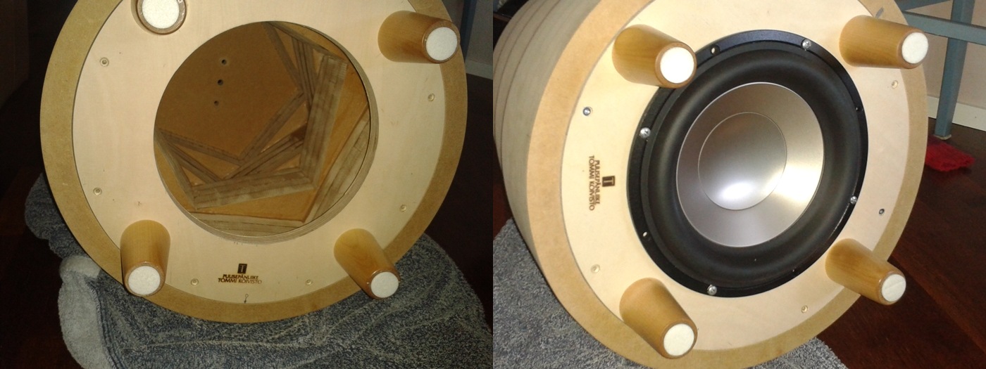

My bass box was done from round disks of 25mm (1") MDF. Pentagonic holes were cut and then discs were glued together. Top plate vibrates a little, or perhaps it is the whole thing? Inner volume is 25 liter (closed) and driver is SEAS L26ROY.
Mo measurements but knuckle test says "dead as rock"

Pictures 6 and 7 (a little over halfway down) show a removable rear. Vibration does not seem to be an issue with the assembly shown, when judged by the crude "hand on it" test.
