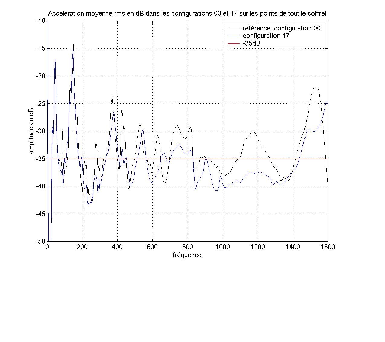

I know quite well about the CLD but I stand next to my claim; see the attached measurements. the black curve is the naked cabinet the blue curve is the cabinet with added CLD on the back only but the results are similar (just amplified) for more surfaces treated with the CLD.
The damping does nothing for the first few modes.
BTW you mentioned you are using braces with CLD. May I ask how you do it because I tried it and it proved useless.

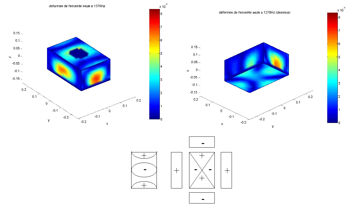

Note that the box was 320x178x210mm with about 5.5L internal volume, Standard quality particle board.
1181 points were measured (15.3mm special step)
We can consider this box small but the first resonance was at about 150Hz. A compact floor stander first mode was about 80Hz so you really cannot count on the "high frequency" to help with CLD.
Here is attached another example of global mode.
M
