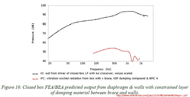

Big speaker companies like KEF and Wilson Audio have studied this much. KEF LS50 whitepaper tells pretty much of the construction of multilayer cabinets.
Nanometers - YouTube

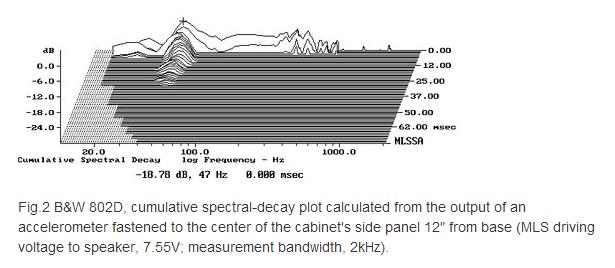

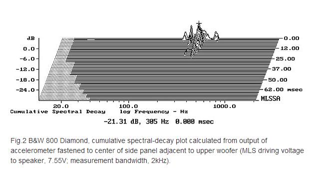

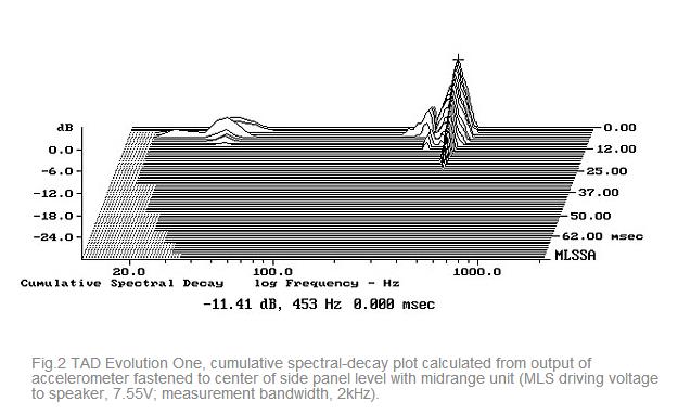

But it is still obscure to me how loud these panels vibrate/ring. Stereophile shows panel vibrations too, but from a single point and dB scale is irrelevant (measuring distance not said).
This is from the KEF whitepaper, a simulation/modelling of driver vs. panel soud pressure level
