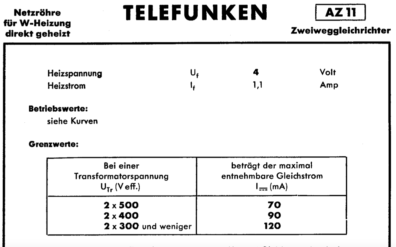

The AZ21 differs from the others primarily by a slightly higher maximally rectified current, and it also has a middle heating terminal to which a + high voltage output can be connected. This, albeit minimally, reduces the uneven wear of the ends of the heating outlet and makes the middle outlet of the heating coil of the rectifier unnecessary.No. AZ1, AZ11, AZ21 and AZ31 are the same tubes, but with different bases. They're all successors of the venerable Telefunken RGN 1064 or Philips/Valvo G 1064. First production run for all of them featured mesh plates, later replaced by solid plates - without altering their characteristics or ratings, mind you!

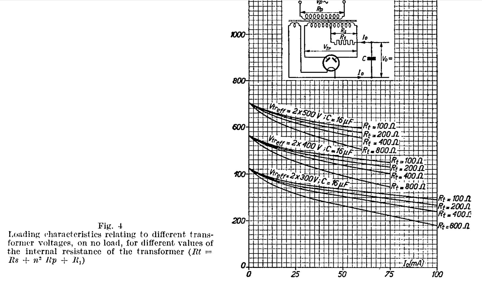

The suggested minimal resistance (Rt) is very important, this protects/limits rectifier tube current (first capacitor large charge pulses).
Rt= Rsecondary + square n * Rprimary + (optional) R1
If Rt smaller than suggested in datasheet, must be used additional R1.

If you use cLC filter, the first capacitor charging pulses stressed mainly the rectifier.
In your case even at 4.7uF the pulses can reach 0.7A peek ... if you don't use limiter (mainly DCR of secondary).
You use PSU 7/24 ... because with this low DCR secondary sparking occurs at turn on.
If you want long life rectifier, never use it over its limits.
If you use choke input filter, the stress significantly lesser ... but no free lunch, the output DC also significantly lesser.

No, you are wrong. The transformer resistance is important and when you dig deep in the old datasheets of the rgn types, there are even formulars in ther which show the resistance allowed is depending on both, HV and current. As well, the trick is NOT to use resistors between the transformer winding and the rectifier. This sounds really bad. It must be a piece if copper, so ideally the secondary windings need to have the right resistance.
You can as well see immediately the effect in PSUD...as Euro21 is refering to...
I tPically like to use a transformer with 70-120ohm per leg from CT. Lower with the 872a...because...the resistance is depending on the HV as well (in the datasheets they suggest higher resistance, but that is for 3000V....)
