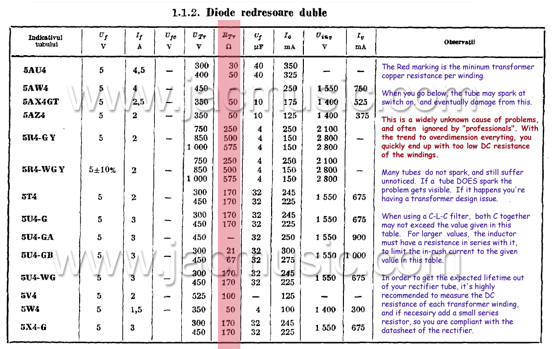

Hello all,
I saw some colleagues were talking about a spark that occur when the system is powered on. I want to share my humble thoughts about this.
1. Never exceed the max. capacitor value in the first position. If on the rectifier's datasheet is written 4uF, use maximum 4 uF, not 6.8 or 10 uF.
2. Every rectifier need a minimum transformer copper resistance in DC per winding (measured from plate to plate).
I learned these from a current tube producer webpage and I don't know if I can put the links here, but I can cite them:
"Note 2) To prevent large charge current peaks, the first capacitor (C1) should NOT be larger than 40uF (My note: they are talking about 5U4, but this rule is generally applicable to all rectifiers, depending on the value of C1 mentioned in the datasheet). If the input capacitor is too large, this will result in heavy AC charge current through this capacitor. This is not good for the rectifier tube, and also not for the capacitor lifetime. The AC capacitor current peaks may cause hum radiation into the preamplifier. With the given C-L-C values in table, the rectifier circuit will work best. For filtering, with oversized components, you will have best results by increasing the choke. Do not oversize capacitor C1, this may increase hum. You can choose the choke large as you want. This will have better results with high voltage rectification.
Note 3) Rectifier tubes may under no circumstance carry larger current peaks as what they are designed for. The current peaks are mainly a function of: power supply DC load, first capacitor and transformer copper resistance. The copper resistance for 5U4G and 5Z3 may not be smaller than 170 Ohms. This is very important to check, and too low copper resistance may damage the rectifier, no matter what brand or construction. Use a small series resistor if the copper resistance of the used transformer is too low. If you scroll further down this data sheet., there is a link to a table with historical information about this, for several rectifier types, not only 5U4G."
Also, please see the attachment to learn which is (for some rectifiers) the minimum copper resistance of the HV secondary measured from plate to plate. Generally this information can be found on the rectifiers datasheets.

<snip> Also, please see the attachment to learn which is (for some rectifiers) the minimum copper resistance of the HV secondary measured from plate to plate. Generally this information can be found on the rectifiers datasheets.
I am using the rgn1064 in my dac-outputstage and for the driver stage of my power amp in Mesh-Version.
They play with 100ohm at each anode into 22H choke-input with again 80ohm followed by a 50uF followed by LC again...(40H, 800ohm, and 100uF)...DC is just like 16mA needed...
So no heavy condidtions and perfectly with the specs of the data sheet...and it gives me the very nasty white sparks in the first second of switching on.
The Amplifier tubes (e182cc) are preheated to save their lifes a bit.
Someone in a different forum wrote that the Mesh-Types, especially the rgn1064 etc are far, far lower in specs than what the data sheet says. So, any experience on that ?
The only solution I found so far is: Take a large 5k resistor before the first choke, switch the PSU on, after a few secs, bypass the 5k resistor with a switch.
