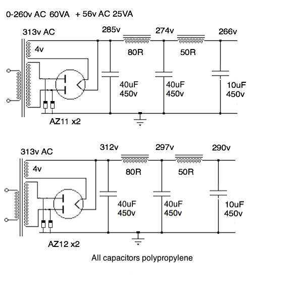

I have a power supply using 2 x AZ11 mesh. I recently tried to push up the output requirements to 280v at 140mA for 2 output tubes at 70mA each. I'm surprised at the large voltage drop at the first cap, 40uF. When I substituted 2 x AZ12 solid plate the voltages jumped up. Actually higher than shown, since the amp then drew 160mA with the existing component values. Unfortunately, while the sound is cleaner because of the higher output in the amp, the magic of the mesh plates has been lost, and the sound is flatter. So it's back to using mesh plates. I have a few AZ1 and AZ11 mesh plates. Choice seems to be:
- use 3 x AZ11 (or AZ1)
- increase the AC voltage going into the rectifier to boost the output DC voltage
With 3 rectifiers I worry about imbalance - my valve tester isn't working properly so I can't test and match them.
To optimise using 2 of AZ11/AZ1 I imagine that reducing the size of the first capacitor would help, even if it means raising the AC voltage going into them. I have CLCLC at present with 40uF first cap.

If you really paralleled AZ11s (pin-to-pin), nobody knows which rectifier's half diode conduct more, than another.
If one rectifier capable conducting more current (under the same conditions) aka. has "lower impedance", it able to conducting majority of requiring DC current, so voltage drop increasing.
Usually old tube's heater resistance (at hot state) vary from tube to tube, therefore filament temperature (and amount of electrons too) also alters at the same heater voltage.
If you measure the saturating current at -for example 80V- constant anode voltage, at the same filament voltage, the "pairing" is necessary.
If you paralleled AZ11 anodes, and use it as single diode and using two tubes ("pair") as double rectifier, its IMHO the best method.
BTW PT secondary DCR also important.

you are working your tubes hard, i do not think they will live long...
rectifiers are meant to be run at a fraction of their capabilities.....
if you require larger current then get a beefier rectifier like the 5u4 or the 5ar4 and be done with it...
if you have to parallel sections, then current hogging is a possibility so it will be better to avoid it...
Thanks euro21. I was wondering about paralleled anodes and using a single one as a diode. I should try that.
What should I do about increasing the PT DCR - put a resistor in series on one leg or two legs?

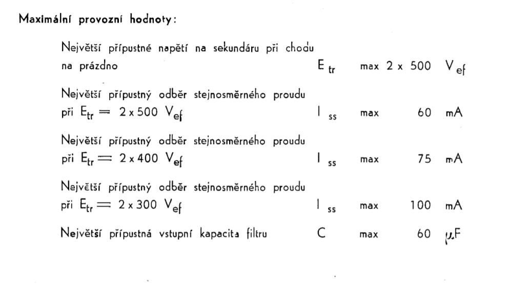

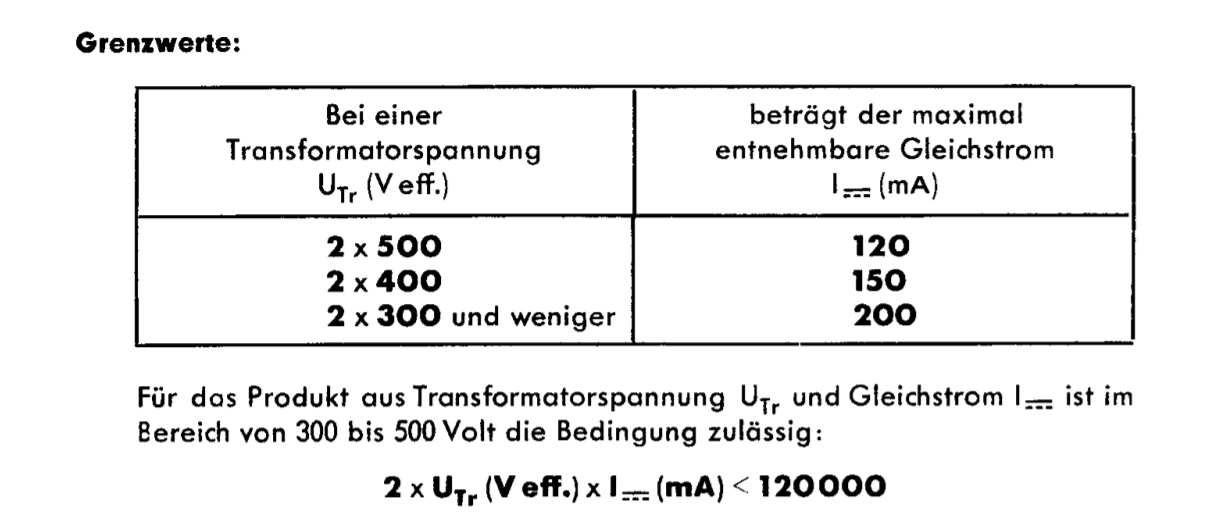

Tony: I realise that these rectifiers are working hard, but they've been on 24/7 for several years now. They've even survived sparks at switch on, which I've now stopped with a switch for the HT. From the data, I think the AZ11 is a little more robust than the AZ1 - the ratings are slightly higher. I have plenty of other rectifiers, including solid plate AZ12s which work fine. They just don't sound the same as the mesh ones.
resistors in series with the plates work fine....
there are curves shown here : https://frank.pocnet.net/sheets/076/a/AZ11.pdf
gives you a clue as to how to proceed...

No. AZ1, AZ11, AZ21 and AZ31 are the same tubes, but with different bases. They're all successors of the venerable Telefunken RGN 1064 or Philips/Valvo G 1064. First production run for all of them featured mesh plates, later replaced by solid plates - without altering their characteristics or ratings, mind you!From the data, I think the AZ11 is a little more robust than the AZ1 - the ratings are slightly higher.
