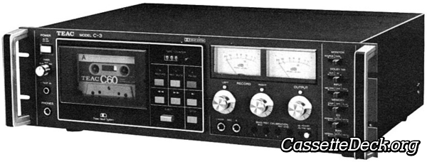

I have a Teac C3 3-head rack mount deck, circa 1977. Other than head cleaning and a new tape counter belt, it has never needed any service. It's built like a tank; very solid.Hello

Hi Philbo,
We modified a few of those with the 122 MKII head, it has separately adjustable record head azimuth. ou set playback, then once locked you can align the record azimuth. Better head material, does require some circuit changes.
Teac C3 - it has never needed any service. It's built like a tank; very solid. (Philbo)

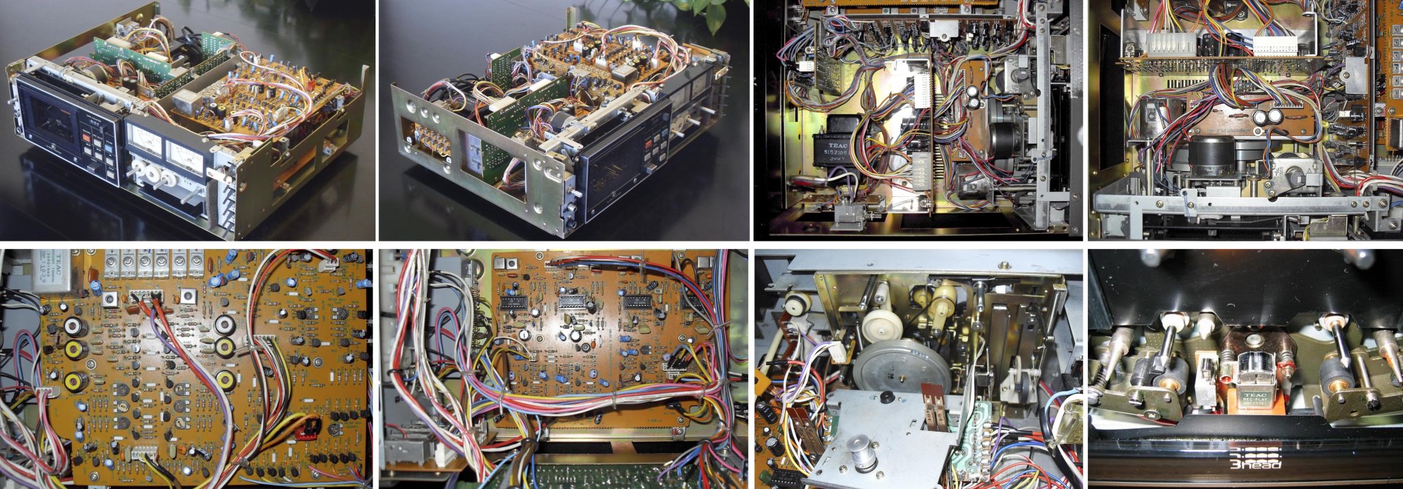

Quote for the C2, the A430 seems a baby in comparison, and hifi average....... but: it's belts lasted 1/4 century, present ones (from china?) no more than a lustre.

That's the thing ... everything needs cleaning and lubrication. Lubricants oxidize, and they can get sticky. When you don't do this, the bearing surfaces begin to wear and then it become unrepairable.
So when you say it has never needed service, you didn't express yourself well. What you really are saying is that you have never noticed a problem with it's operation and you have neglected its maintenance. Yes, it is built like a tank. Even tanks require maintenance.
Another thing I have noticed over decades of service. The average person doesn't notice a decline in performance until it becomes severe. You tend to adjust to it as the performance drops over time. This is true with everything. Once restored, people are pretty universal in their response - "I can't believe I thought it was okay".

I have a Teac C3 that I bought new about 50 years ago. Still works...
I did put in a new tape counter belt around '93.
