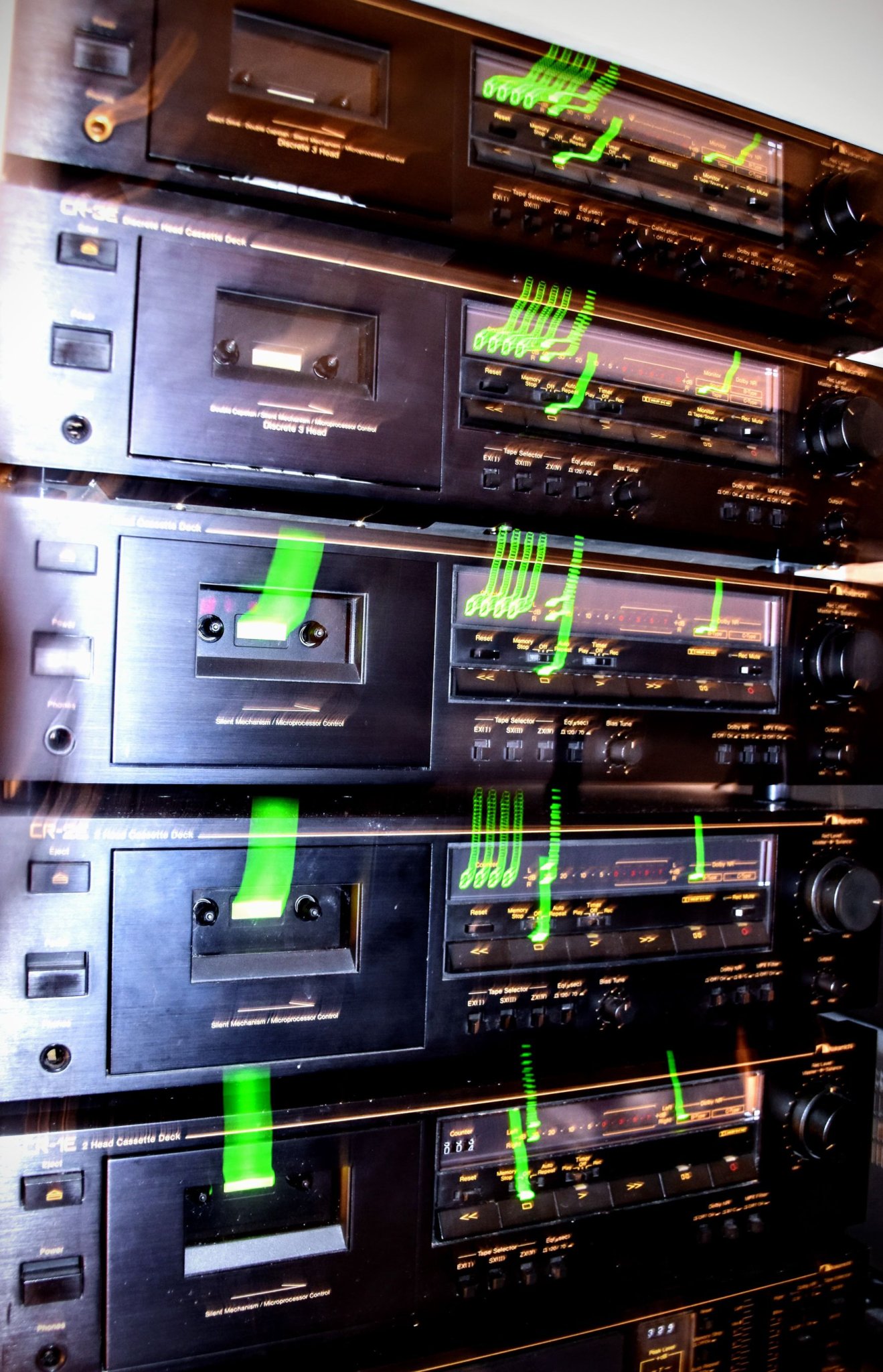

Been away from this thread a while but currently working through a stack of Nakamichi CR decks that I managed to amass over the past couple of years.
Consisting of a CR1E, 2x CR2's, a CR3E and a beautiful CR4E.
All have/had their issues and I've completed the repair/refurb back to full functionality on 4/5 decks. The last one to do is the CR4E, the 'daddy' of the stack. Currently building up the courage and trying to find the time to do a complete strip-down of the transport to refurb the reel and mode motors. Not for the feint-hearted!

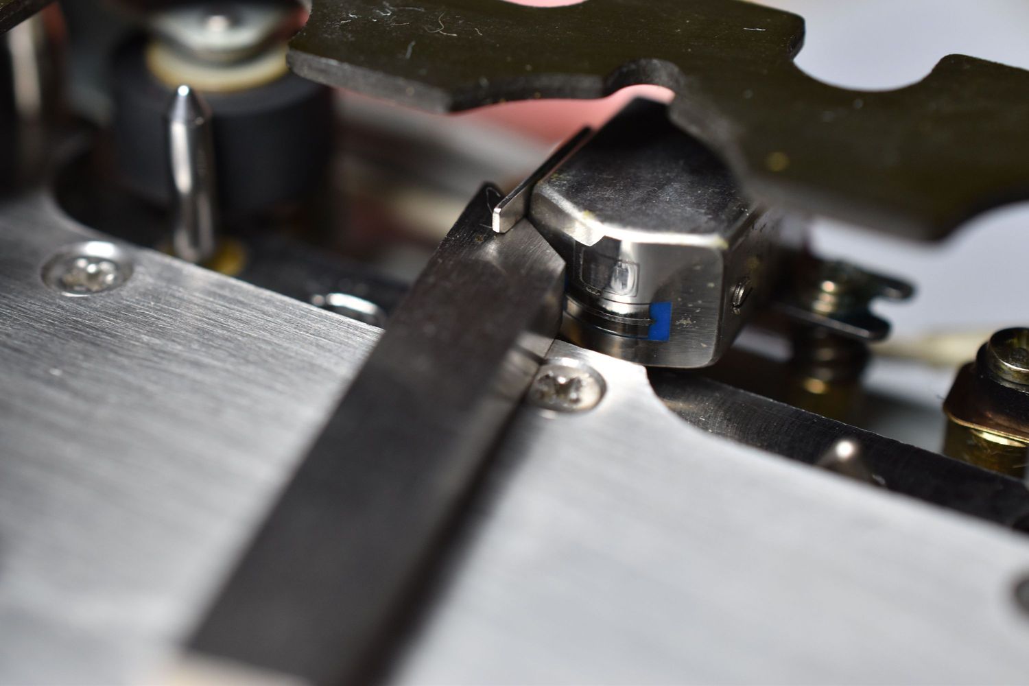

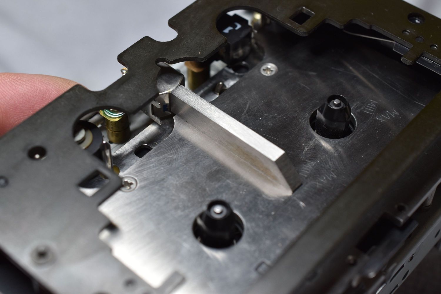

Checking the heads heights, tilt (zenith) and depth penetration and a thorough cleaning of the entire tape path is a good first step in order to ascertain how in or out of specification the playback signal is.

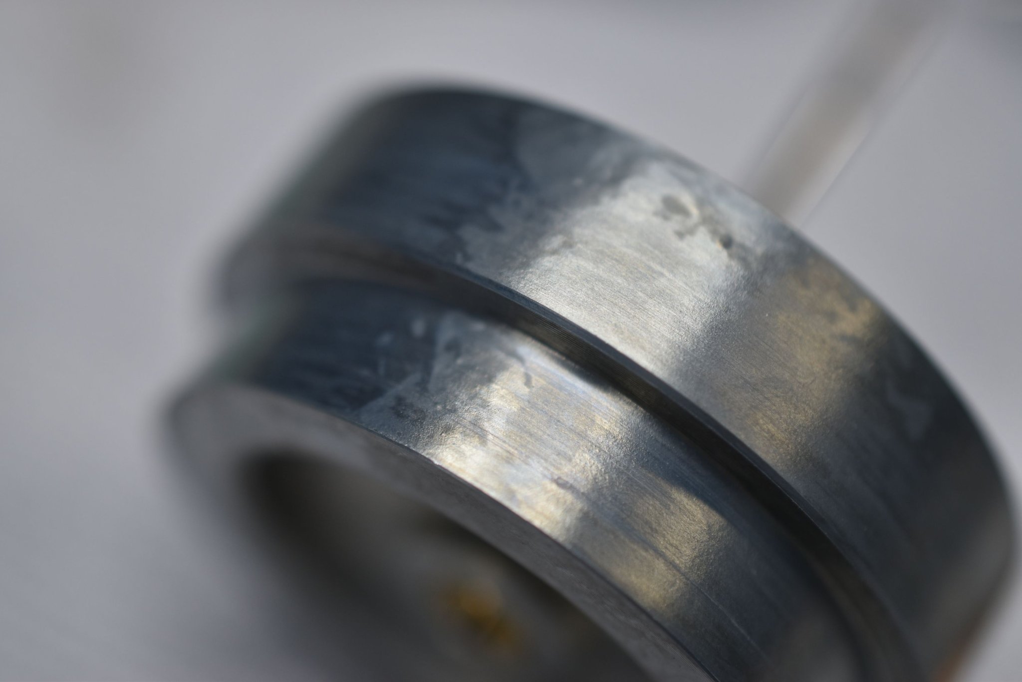

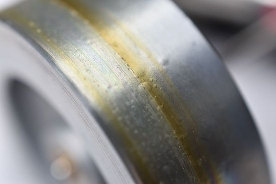

I'm finding that all of these decks' capstan flywheels are sufferering from varying degrees of 'zinc pest' which which can contribute to horrendous wow&flutter measurements.
Not much can be done to compensate for this unfortunately, apart from sourcing replacement flywheels and who has those??
Cleaning the transports and making sure everything is free from contaminants and detritus is a must on these decks

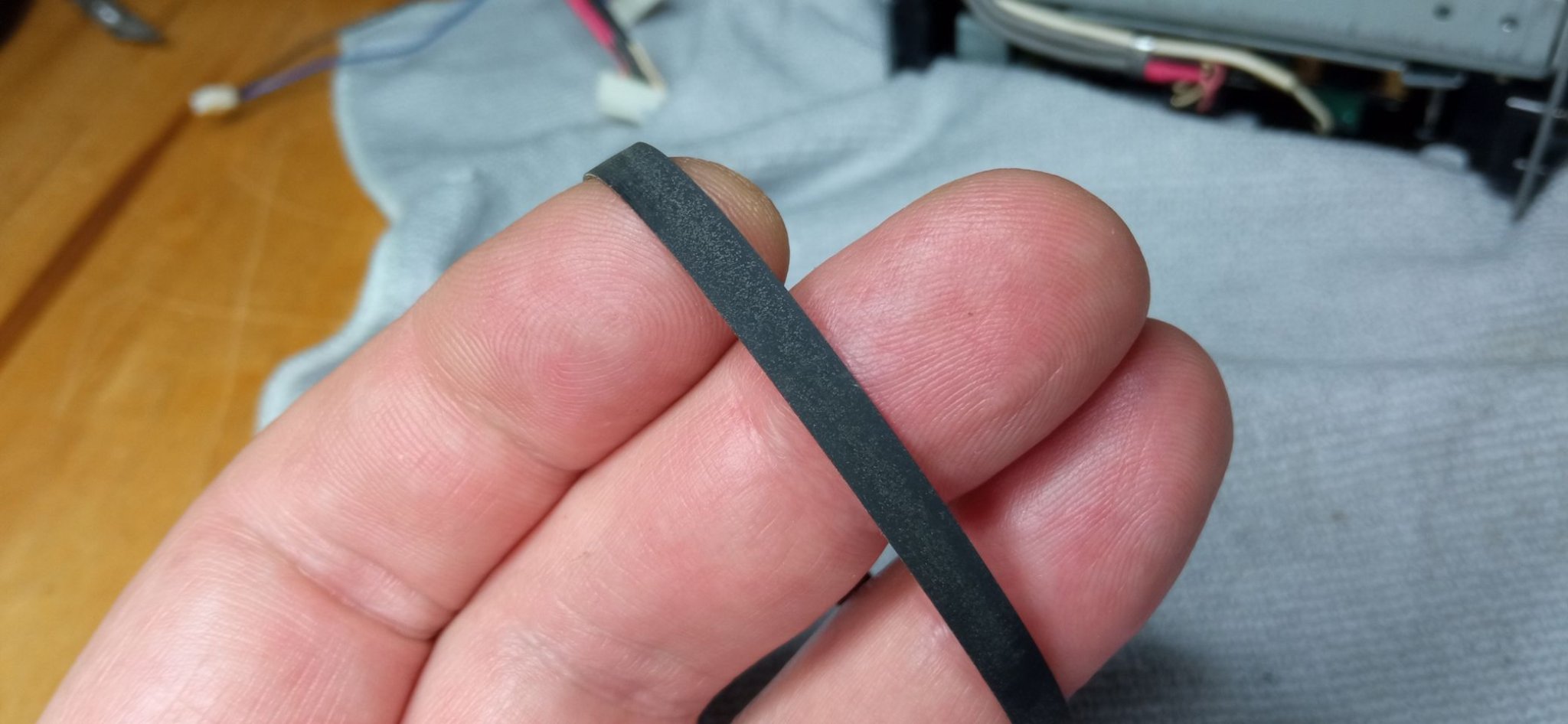

The original nakamichi belts should always be reconditioned and re-used if they are still elastic and show no signs of deterioration. I usually hit them with Platenclene (Naptha) which both cleans and reconditions, leaving them looking and feeling like new.
Before
After

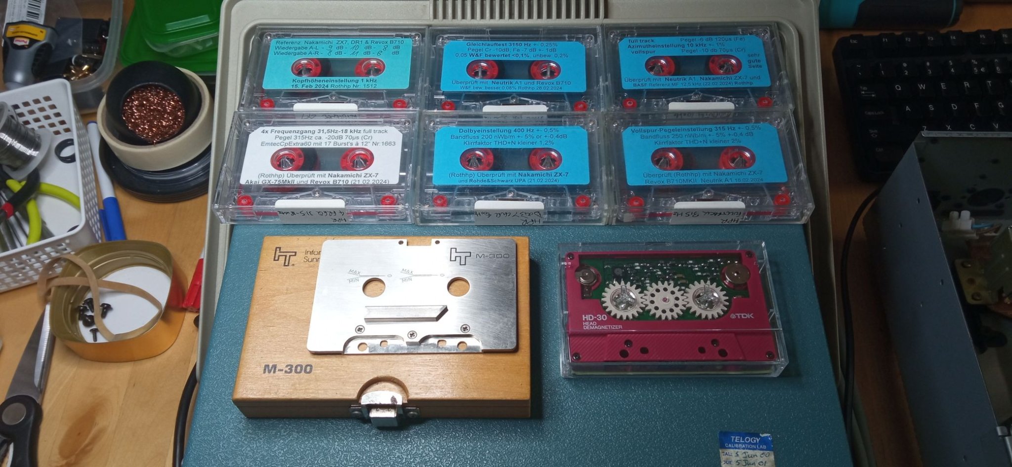

Once the decks are re-assembled and made good for operation it's time to get down to tweaking the azimuth and play/bias/record levels. I'm using the excellent HansPeter Roth calibration tapes to perform all necessary calibrations and gaining nice improvements back towards factory-specification.
Dolby levels check out ok on this one.
Getting the play azimuth back in-phase requires a decent set of screwdrivers and a steady hand.

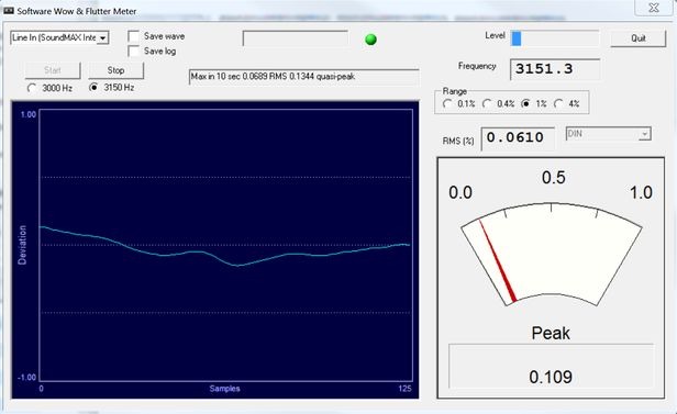

A 10 second average 0.068% W&F WRMS measurement on the original cpastan belt is acceptable.
