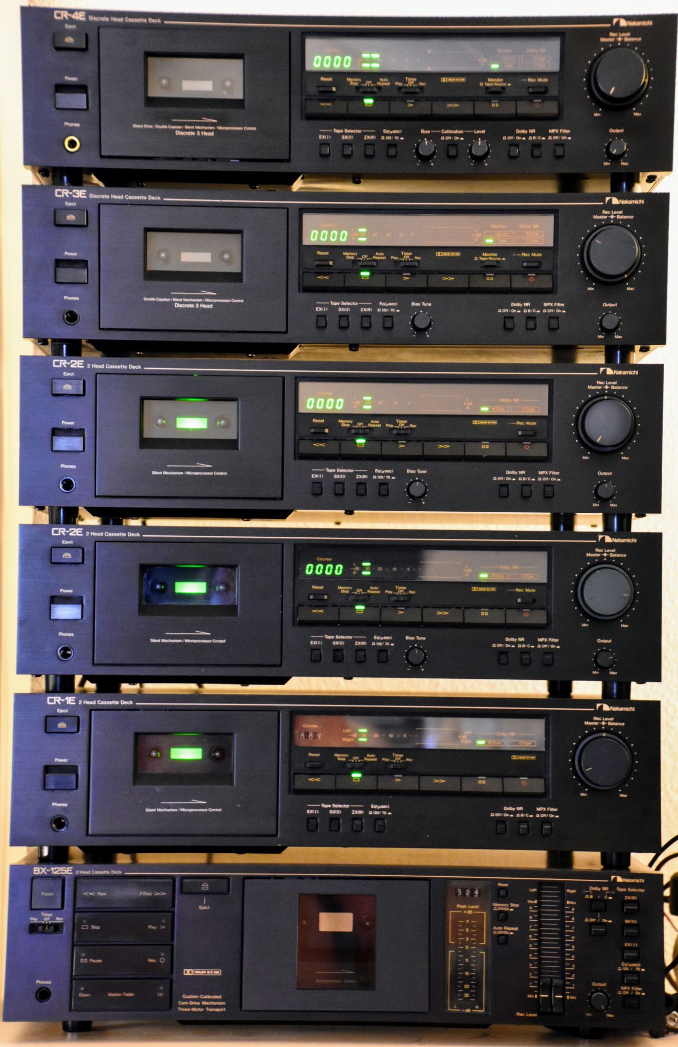

Still busy refurbing my little cabal of Nakamichi CR decks. It's actually quite a nice, relaxing hobby and gets me away from solder fumes and cut fingers when making cables lol.
The CR1, 2x CR2's and CR3 are all now refurbed and back to factory specs. The CR4 needs the mode-motor refurbing which is always a challenge, but never a chore. There's also a slew of new non-running Yamaha decks that I'll get started on at some point too.

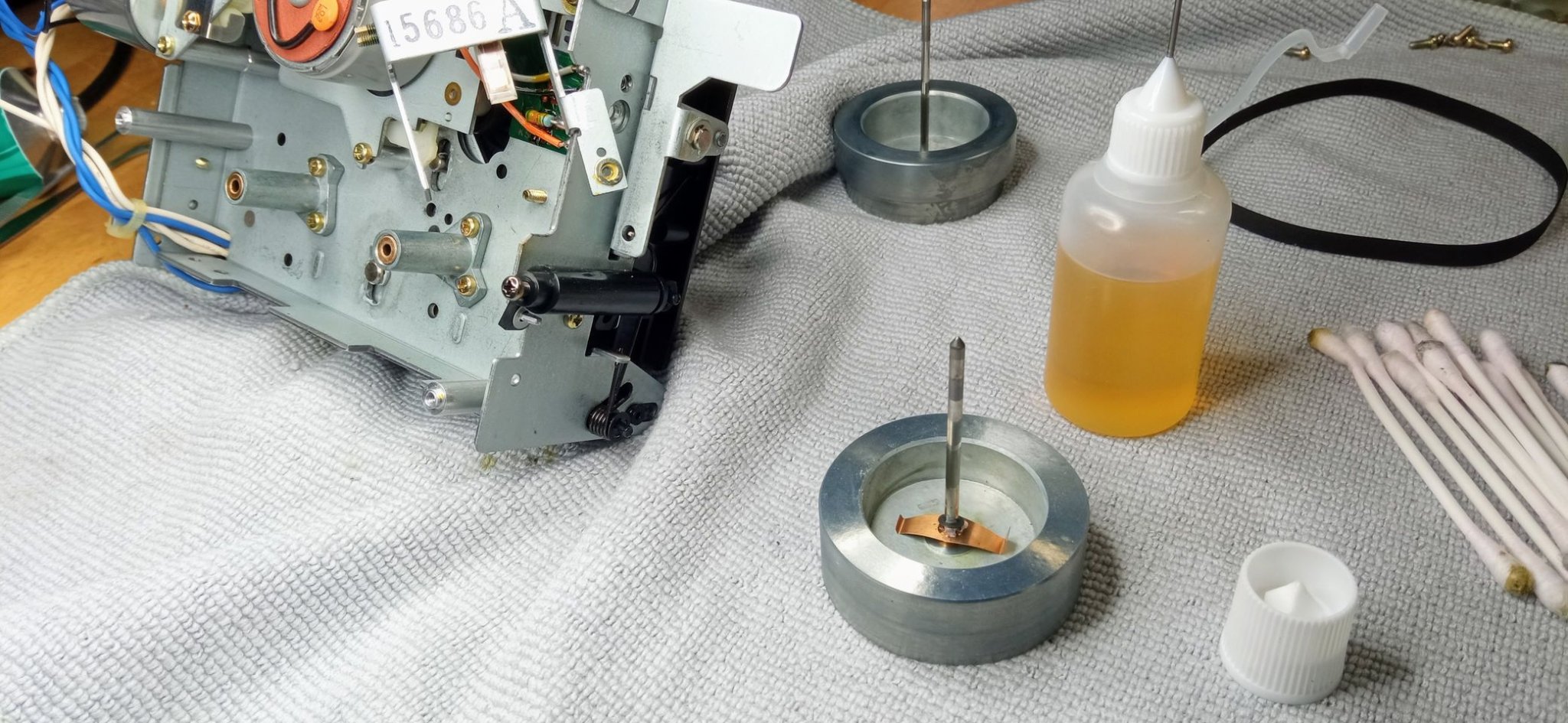

A pair of CR transports. Extricated and ready for refurbing. CR4 on the left, CR3 on the right. Note the direct drive motor of the CR4 - this is what makes it a really standout deck in terms of performance (w&f)

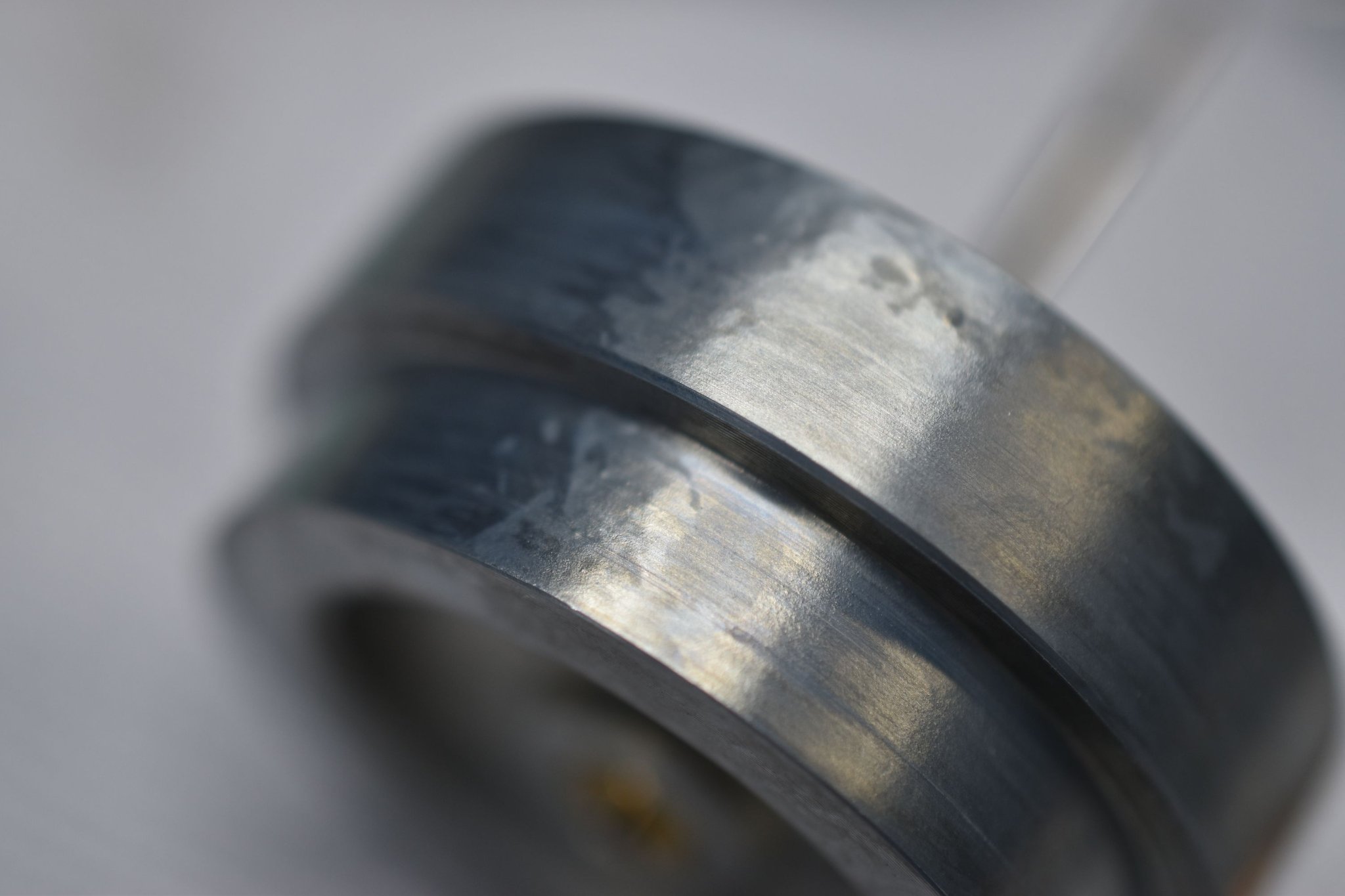

Zinc pest on the capstan flywheel of the CR3. Nasty. Increases w&f slightly too which is unfortunate.
10 q-tips down, 483 to go 😀
