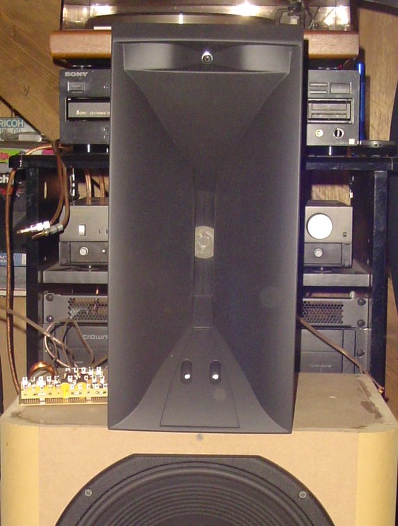

I'll also note that the JBL design that you criticized for diffraction effects (from the mouth) that Zilch presented to you, seems to be rather well received by a *very* large number people, none of whom I've seen so far are complaining about the horn's diffraction with respect to sound quality (..though I'm sure there are some, I just haven't seen any).
I corrected the mouth diffraction on that horn by utilizing open cell foam, shaped to loosely track the profile and provide a termination. This dramatically reduced the ringing and pattern flip at cutoff, and improved the sound substantially.
Now I've seen one. 🙂
I'm betting though that it wasn't *bad* before though. ..Gainphile's demo didn't seem bad to me. 😱
..as a point of reference, I was doing this sort of thing in the late '80s - and usually always had a similar improvement. I didn't have access to open-cell foam though, it was just poly batting integrated into my "grill" cloth cover. I don't think the sound was bad before it, just improved after.. but it's been a rather long time since then so my memory could be faulty. Usually when I had bad sound it was the result of a poor coupling of driver and horn (..visible discontinuity), or the use of titanium drivers with titanium surrounds and solid-state amps. It was slightly over a decade later when I had access to measuring equipment, so I couldn't say what sort of poor objective behavior those horns were contributing at the time.
