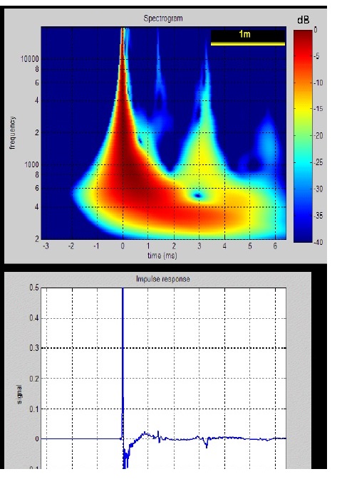

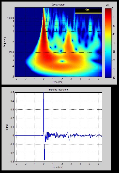

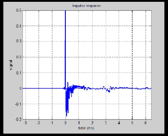

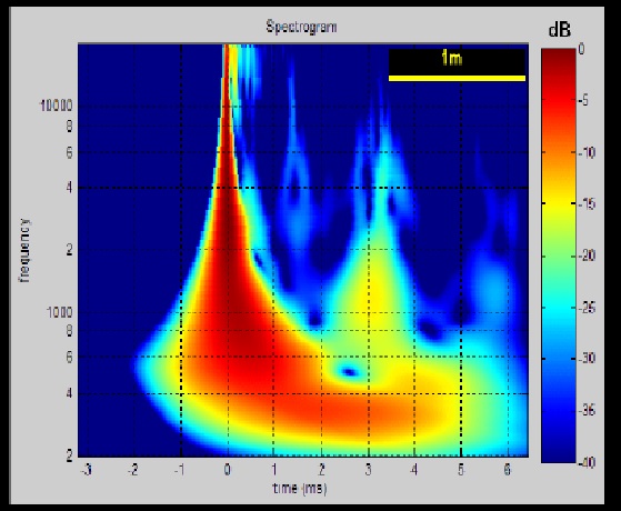

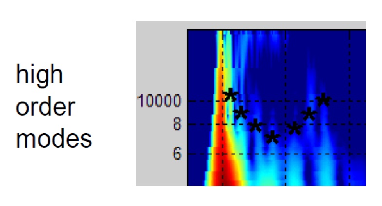

I've suggested this paper by JM LeCleac'h before:
http://forums.melaudia.net/attachment.php?aid=1760
Here he looks at 16 horn/compression driver combinations. Each one has a response curve, an impulse response, a 3d wavelet transform of the impulse and a group delay curve.
This give a very in depth look at the time domain performance of a variety of horns. Besides the early response that contains the broad shape of the horn's frequency response, there are all of the other delayed reflections that will come from whatever cause exists. Some reflections are seen as quite distinct echoes. For example most of the horns have a significant echo at about 3 ms. LeCleac'h states that this is the horn mouth reflection. Energy reflects from the mouth back to the throat and then out again. 3ms corresponds to the transit time of two times the horn length. In addition LeCleac'h singles out mouth diffraction as a strong secondary reflection. It is closer to the main impulse as it has a path determined by sound diffracting around the horn contour to the mouth and then coming to the listener via the slightly longer diagonal path.
Horns with discontinuities such as bends in planar sections (Manta Ray) or diffraction slots will also have reflections at the corresponding times. LeCleac'h also identifies HOM related reflections.
The strong reflections are visible in the impulse response and even relatively subtle ones are seen in the color plots. The color plot shows level by color, time on the horizontal axis and frequency on the vertical axis. A reflection of a certain time delay will look like some sort of vertical wedge to the right of the primary impulse.
Now we are told that the horns are operating in the linear part of their range. Curves were taken at 91dB and the efficiency is such that the impulse responses would probably hold true for from 5 to 105dB. As such the impulse response should fully quantify the sound of the horn, at least for a listener on axis in a dead room (and with typical horn directivity, even in a somewhat lively room). That means that the measured impulse could be used for an FIR filter and any musical waveform could be convolved with it, giving the output (the sound) that we would expect from a particular horn.
Thought of that way, we should just think of the horn as merely a device imparting multiply reflected energy to any signal. The audible effect of the device can be solely determined by the standard audibility of reflections. Reflection delay, level and frequency spectrum are all that matter (in this case sound direction is essentially the same as the primary sound).
In this way it hard to think of these reflections as being fundamentally different to reflections from any other cause, such as, say, cabinet reflections from a poorly mounted tweeter, or reflections off of a countertop surface that a system might be sitting on. Reflections may come from the mouth, from internal discontinuities or from HOMs, but there is no reason to believe that the predicating discontinuity is of any particular importance. Whatever the physical (or in the case of our FIR filter, electrical) cause, the sound is determined by delay, level and spectrum of the various reflections.
This being the case shouldn't we look at the levels and delays of the various reflections? Certainly the mouth reflections are the largest by far, and the most visible in the impulse responses. What LeCleac'h suggests are mouth diffraction reflections seem to typically be second strongest. Diffraction slots, bends and HOMs seem to be lower and more diffuse in time. (The measurement LeCleac'h suggests is mostly HOMs is attached.)
Why LeCleac'h can measure these and other can't is something I don't understand. Also, if this evidence is pretty typical of most horn performances, and if we are truly looking at linear effects (frequency response related effects independent of input level), then it would suggest that we really ought to be concentrating on reducing primary and secondary mouth reflections. At least before we get hung up on lesser reflection causes.
David

I am aware of Mr LeCleach's paper, but I don't accept that what he calls HOMs actually are. Because HOMs have cut-in frequencies, any reflection that goes to lower frequencies cannot be an HOM. There should be a staircase type of effect as each mode "cuts-in". I don't see that where he says there are HOMs. It may be possible to use this kind of analysis to find HOMs, but I don't think that he did. Also, the delay time would be much less than a reflection time.
I do agree that the #1 problem with many horns is mouth reflection/diffraction. I have always said that.
My main concern with horns and waveguides has always been directivity control and not any single axis response. Mr LeCleach has always had the opposite view. So we each developed techniques that optimally show what it is we are looking for. Nothing surprising in that.
If directivity control is key then good old diffraction slot type horns are the best available in that regard, yet we can't use them because of the HOM issues!
The point I'm making is that if HOMs are well lower in level than other more common issues, and in fact hard to even measure, then why do we care about them?
Why the attitude of some that they must be banished at all costs? (answer, because of the opinion (myth?) that they sound proportionately worse than conventional (old fashioned) aberrations.)
