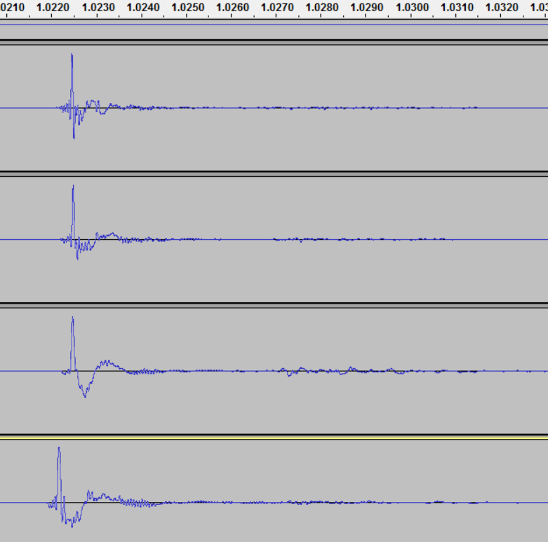

So far as I can tell, HOMs occur when sound bounces around inside the horn, instead of moving along the horn axis as you'd expect.
Given that, it would be possible to mount the driver to the horn, and then send clicks (1 sample wide) to the driver, and then record the result.
Look at the recorded trace, and see if there are reflections or smearing of the impulse signal.
I've just given that a try, and will figure out a way of uploading the results in a way that'll let you guys experiment.

Okay, here goes.
Files are as follows:
- screencap from Audacity, trimmed to a single recorded click.
- Impulse file (44.1kHz sample rate, 1 sample up as a click)
- Raw compression driver
- On-axis with horn
- Off-axis with horn
- Mic put somewhere around 2/3rds of the way into the horn
Mic was a Beyerdynamic MM1, soundcard was a Behringer UMC202HD. Compression driver is a 18Sound ND1460, horn is an RCF HF94.
Chris
EDIT - change .asc to .wav to get the files working.
