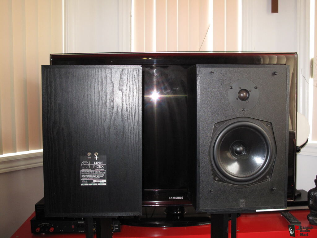

In various commercial loudspeakers used drivers was based on the B200 series but with slightly modified coating of the cone resp. diaphragm
Several of this commercial models I have heard, e. g. the Linn Index - go to
https://www.tnt-audio.com/casse/linne.html
the Linn S.A.R.A. (compound system) - go to
https://audiocostruzioni.com/en/product/linn-isobarik-sara-speakers/
and the model DARIUS from Roksan - go to
https://www.diyaudio.com/community/...or-stands-other-brands-wanted-to-know.225588/
The common feature of all speakers was that one got excellent sonic performance down to the low frequency area, but only if the amplifier used worked well with it.

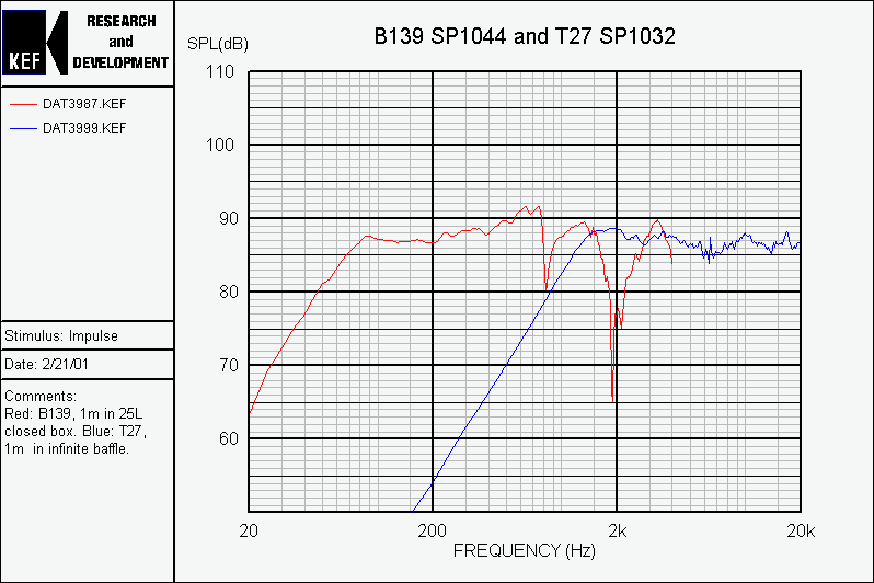

...near ruler flat response out to 750Hz - at which point it then falls off a cliff.
With a substantial resonance at about 1kHz.
dave

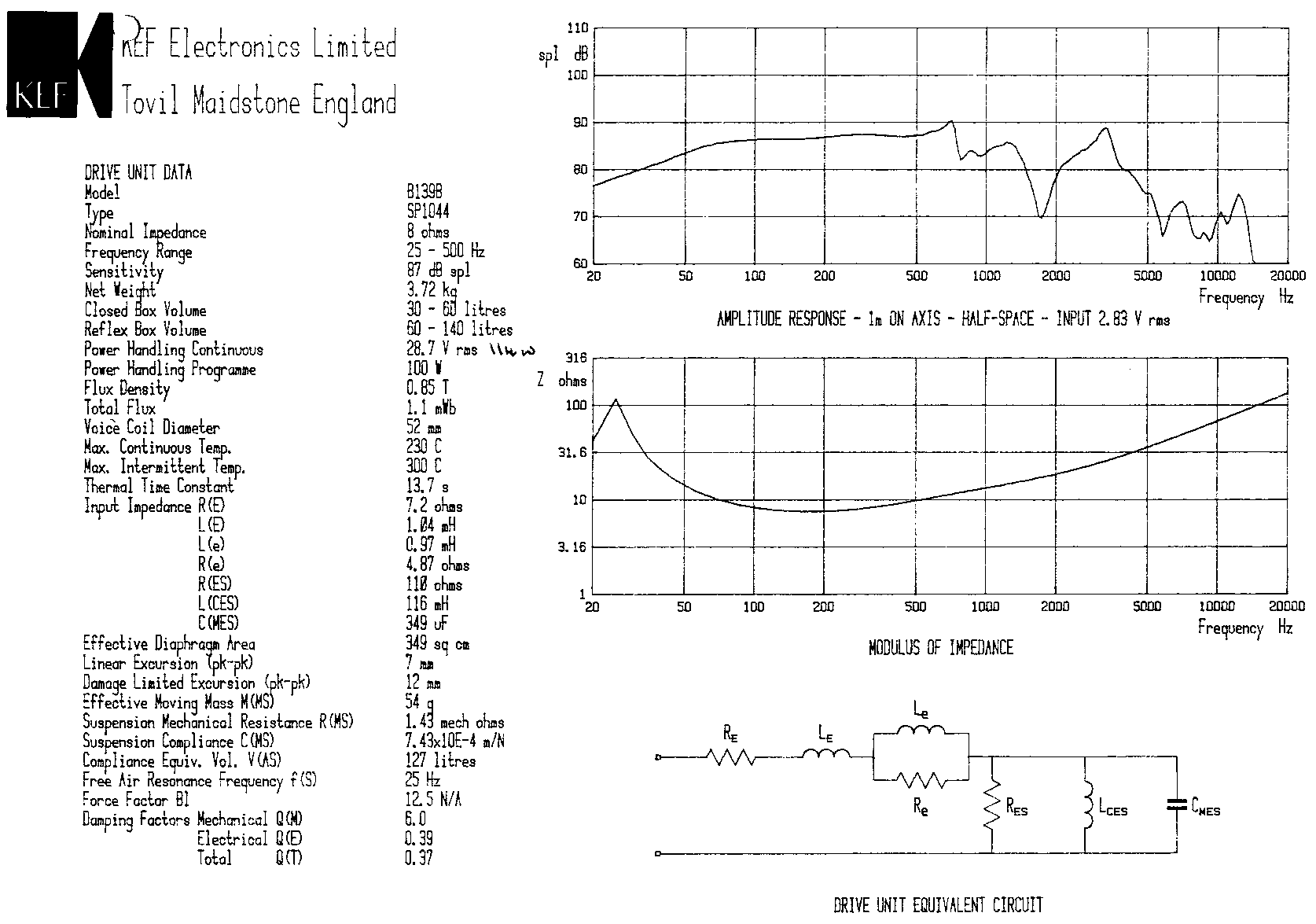

Would the B139 sound better than the B200 below 750Hz?
Never really done a direct comparison. The one ref i have is my preference for the IMF TLS50 (w B200) over TLS80 (with B139). XO was lower than 750Hz.

It's about 2.5dB at 750Hz or so and then tumbles by at least 8 dB between there and 800 and something. Pretty good if you think that's going to be about an octave into the stopband so about 18dB down at that point. That should make for quite a smooth handover to whatever is above it.With a substantial resonance at about 1kHz.

I don't think I'd take the B139 out to 750Hz. It's a bit messy thereafter. All these drivers are pretty much theoretical when we talk about frequencies up to 350Hz or so. There can be some contribution from the spider mechanical impedance (and, amusingly, from really weak baskets as I have just found out with an otherwise very nice 75mm midrange dome) but mostly the theory is better than the manufacturer's measurements - yes, there is at least one (good) manufacturer out there whose sub 500Hz measurements are worse than useless.Would the B139 sound better than the B200 below 750Hz?

Using the B139 will allow you greater max output but with a B200 (any B200, frankly, as they were nearly all used outside the ideal T/S region) you can also take it up to an old-fashioned 1kHz crossover. The B200 has a rising response from there upwards but it's not badly behaved and we know it has been used up to 3.2kHz. You can also get 50% more Sd than a B139 with two B200s (in fact the area of a genuine 12" driver). Then you have the alternative or redoing a 104 which is a supremely relaxing loudspeaker, if a bit bit too pipe and slippers for some but it would be fun to live with for a while.

It's about 2.5dB at 750Hz or so and then tumbles by at least 8 dB between there and 800 and something. \

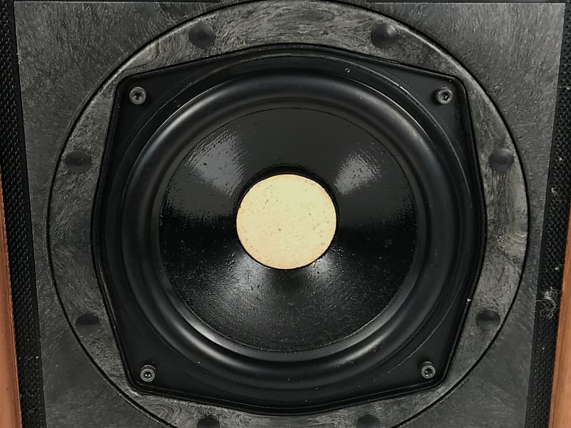

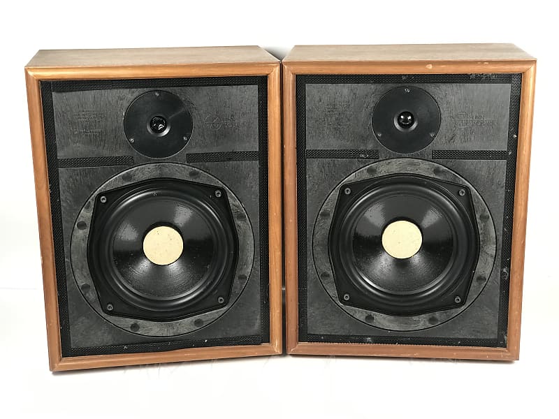

In an attempt to turn back time, I repurchased the loudspeakers of my youth -- a pair of KEF C65s -- on FB Marketplace. Unfortunately, when I took them home I discovered both woofers don't work. (Fortunately I got my money back.)
I only hear output from the tweeters. I removed the woofer from the box and tried driving it directly - no sound. I also tried measuring with a multimeter. No reading. So, even though the drivers look perfectly fine to my eye, I guess they are inoperable.
(Incidentally, my original pair eventually failed in the same way many, many years ago, after a friend played them too loud at a party.)
The speakers use B200 drivers, part number SP1259. I've been having trouble finding replacements online. Any suggestions? Could I use a different model of B200 driver? I see someone nearby has a pair of C40s - maybe those would work? Or any other suggestions to further test / refurbish my non-working drivers?
I've attached information from KEF about these and other speakers in the range. Any ideas much appreciated!

Sadly, yours is completely different B200 and, I believe is a 4 Ohm unit so you can't swap a B200 in. Just in case your drivers can be rescued, have a look to see if the joint between the VC wire and the braid is good. Sometimes you can repair a unit by unwinding a turn, or half a turn, and resoldering it to the braid (which, incidentally, is never that easy). But if not, it's either eBay for the same drivers or getting the bass units repaired, which is what I would do. Volt, who I think moved to Dorset some while ago, would be a good set of people to do it - especially as you will probably have to have the coils wound anew. Send them both drivers and you'll get back something pretty damn close to the originals and, most importantly, properly aligned.
Two things to bear in mind, one is that copper to aluminum joints will get galvanic corrosion, moisture levels in the atmosphere have something to do with that.
Second is that it could be a problem with lead free solder, Scan Speak drivers have been known to fail that way, braid to coil joint is the normal point of failure.
Unless you are very good, get it done outside, if you feel they are worth it.
