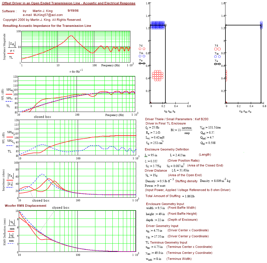

The B200 was not a very good driver back in it's haydays. It comes from an era when amplifiers became more powerfull and loudspeaker manufactureres began to manufacture drivers with highly damped cones to avoid breakup behaviour at the expense of sensitivity and unfortunatly also at the expense of live sound or exitement. Loudspeakers became over polite and the B200 and other KEF drivers where the perfect example of it. The KEF speakers did sound well balanced but they lacked dynamics, lacked detail and simply lacked live.
Certainly a good description of KEFs of the day. But i heard some really good DIY speakers. with KEF drivers.
dave
I have also heard very good diy loudspeakers with KEF drivers in the past so I thought but that was untill I knew better. It was untill I started working as a sound engineer and hearing live music on a daily basis I knew something was just not right with these kind of drivers/systems and after a while I just could not stand the sound of it anymore, it was too far of what I heard from real instruments, like a over romantisized picture of reality.
But the best system is the system that brings the owner the most enjoyment.
@Sjef. Very interesting. I think the SARAs are a pretty good implementation of the B200. They don't do anything like KEF did back then and put them against the wall so they didn't have to compensate for the 4pi to 2pi transition. That allowed them to stay more sensitive and be much more dynamic because you didn't have the bass swamping the sound (by putting only one unit of bass into the room rather than two). Sadly they aren't a patch on the Isobariks and if I were pushed, I think I'd have to say the Kans were better - and that's with a driver I definitely wouldn't use these days, the SP1003. (I would use the SP1228 at a pinch but there are better drivers out there and I anyway prefer either plasticised paper or carbon fibre nowadays.) But I wouldn't go as far as saying it was never a very good driver. It was cutting edge in its time and I bet the sales figures don't bear out your perspective. What is surprising is that they didn't make a polypropylene version (I think), especially as they would go on to produce about half a dozen models after the SP1014. Had they done so, it would still be giving almost everything equivalent in the market a decent run for the money. But at £10-£15 each - which is almost exactly what we paid trade in the early and mid '80s - they offer good value and would be very tempting for someone starting out. And you can get more out of them than the SARAs do.
