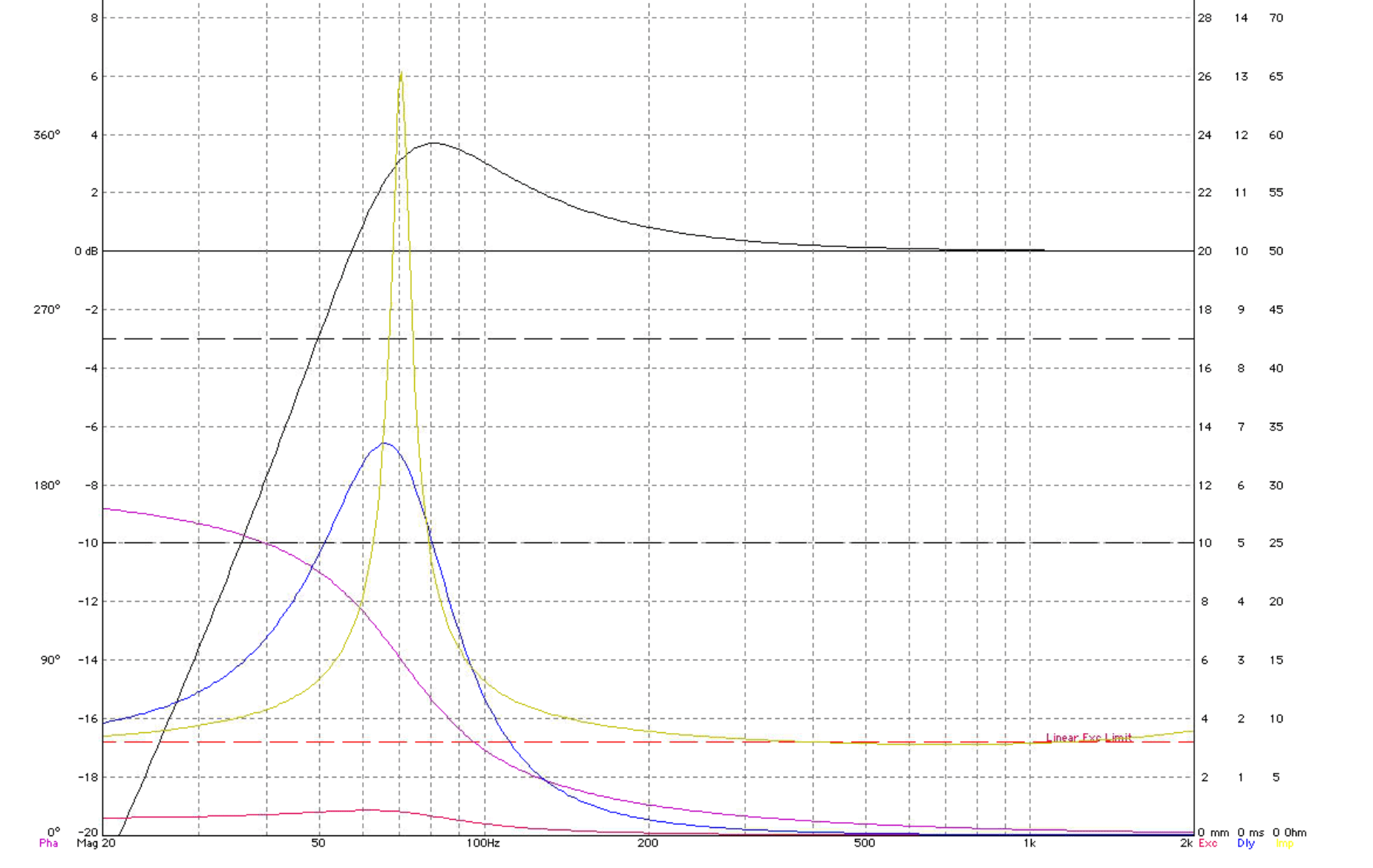

I don't think you can reconcile the two. The SP1014 starts off with a Q of a half and a large surface area giving a VAS of 131 litres. Your maximally flat sealed cabinet (Q=0.707) is therefore 130L (giving an effective 65L), which is miles away from the 20 something of the Chorale. It's a bit of an abberation in the KEF lineup of that era because all the rest of the drivers have alignments of T/S components such that they really are very close to the maximum low frequency that can reasonably (meaning not 120g etc.) be achieved by a driver of that size. Most people didn't get close, and still don't. SB have obviously worked it out - of the present day companies - and SEAS have historically always been good on this aspect, but there aren't many others.I have 16 KEF B200.
I am still trying to reconcil the small sealed boxes (the CHorale mentioned and the Tangent TM3 for instance) with what modeling suggests.
Those small cabinets must have had Qs well over 1 (I get nearly 1.3 for an effective volume of 20L). I guess that starting from a free air resonance of 25Hz, at least the rolloff point stays low in freq so you're getting quite a lot of extension from your box. They did tackle this problem from a couple of angles. One, with the larger magnet and higher power B200s and two, with a more heavily damped surround on what was otherwise a 1014. From memory these got the Qs down to 0.4 or 0.44.
There are so many ways to view this. I'm not sure of the date of the Chorale ('68?) but I'm going to guess there were more valve amps round then, so who knows what Q they actually had? You could also view it as a very flexible driver that worked in cabinets from 25L to 125L and didn't need a midrange. What is actually pretty incredible is how nearly all of them are still around and working. Assuming they haven't been in a workshop or garage they all look the same and, AFAIK, perform much the same. That's really quite amazing 50 years on.
Modeling based on the factory data indictes a very large box, but the TM3, which i am familiar with, the same driver worked well in a smallish sealed box (about 19 litres, Q of 1.4 by sim).
You know you don't need to Sim that, don't you? It can be done on a pocket calculator. In this instance, much of it can be done in your head as it has nice numbers like Q=0.5 at 25Hz. So as long as you've remembered that 25 x sqrt(2) is 35.35 you are practically there. And for a smaller cabinet your Q=1 is at 50Hz in an effective volume of 33L, which probably turns out to be a box of around 50L.
