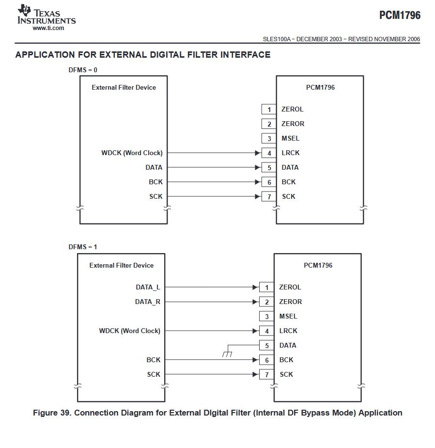

Only PCM1792 & PCM1796 accept 20-bit data whereas PCM1795 doesn't. That information on TI support page is incorrect. Just look at the first page of datasheet:
https://www.ti.com/lit/ds/symlink/pcm1792.pdf
https://www.ti.com/lit/ds/symlink/pcm1795.pdf
https://www.ti.com/lit/ds/symlink/pcm1796.pdf
Here is how parallel data input works with PCM1796. Same information can be found from PCM1792 datasheet.
Yeah, I am seeing that. And I was reviewing the conversation I had earlier with the engineer trying to "get into his head". This was the conversation he sent to me. He started by looking at the 1795 but changed to the 1794.
From the original engineer:
I reviewed the design as well as the PCM1795 . i found two things which i need to discuss:
1. the PCM1795 has builtin registers to change the settings of the DAC and can be configured over digital interface (I2C or SPI). it would have been ideal if the default settings were the same what we need but the default data format and resolution bits are different from the part we want to replace. there are two options, either i add a small microcontroller on the pcb to configure the DAC at power up or look for other alternate which wont require configuration.
2. just wanted to confirm the two DACs are configured as stereo? i see one more difference in the actual schematics and the PCM1795 or similar ICs and that is how the L and R data is received. in the original schematics the two DACs receive the same WCLK and the BCLK but different data (DACL and DACR). whereas in modern DACs, the left and right data is sent on the same data pin and the WCLK is used to tell if its L or R. i think i will have to look into detail if the PCM1795 can be used still or we might have to use two seperate DACs as in the original design. i could be wrong in understanding this and having your opinion will be helpful.
I did more research and i think the following solution will be the most suitable.
1. use DAC from same TI family but which can be configured by high and low signals to dedicated pins (instead of requiring digital communication protocol and register updates). one such IC is https://www.ti.com/lit/ds/symlink/pcm1794a-q1.pdf?ts=1659132465465&ref_url=https%3A%2F%2Fwww.ti.com%2Faudio-ic%2Fconverters%2Fdac%2Fproducts.html
2. to solve the L and R DAC data, we will have to use two DACs separately each receiving one of the two signals coming. most of modern DACs have two (stereo ) outputs but we can leave the second output unused.

OK, so if I go back and look at the PCM1702. I don't see in the data sheet, a bullet point under features, for the input data. Is that inferred from the description?
20-Bit DIGITAL-TO-ANALOG CONVERTER
When reviewing the various DACs
PCM1796:
Accepts 16, 20 and 24 bit audio data
PCM Data Formats: Standard, I2S, and Left-Justified
PCM1795:
Accepts 16-, 24-, and 32-Bit Audio Data
PCM1792:
PCM1794:
Accepts 16, and 24 Bit Audio Data
So basically, 1794 and 1795 are not good candidates because they don't accept 20 bit data.
What I can do now is at least configure my current 1794 to give me output (even if it is not good).
