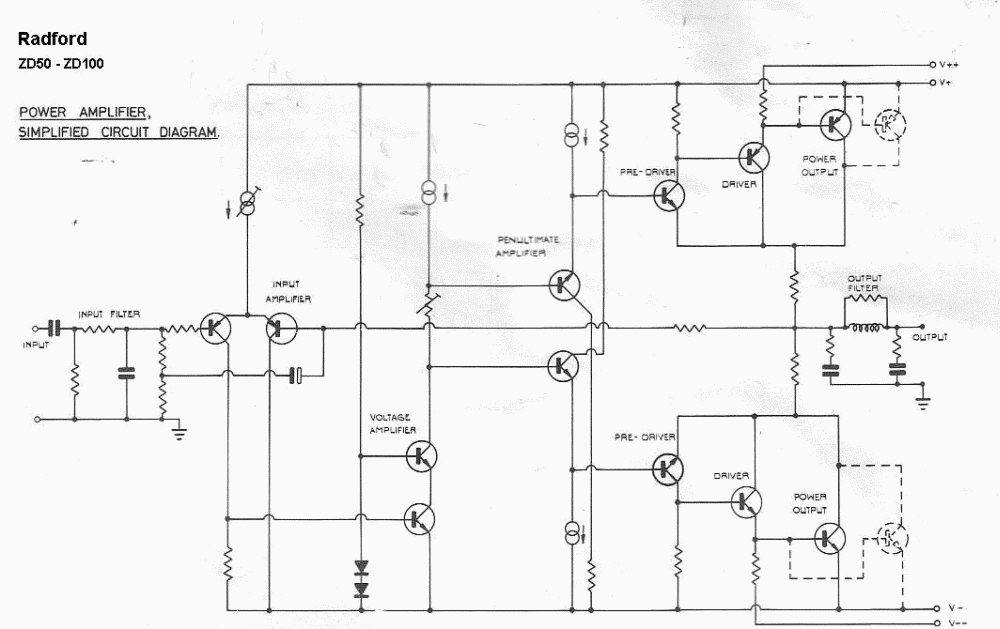

Do you have something from Radford/Bailey you can post - perhaps into this thread as an example of 'complexity' 😉

some nice features for a simplified 60's creation.
I like the input filtering, the Pi output filtering, the diamond drivers, the cascoded VAS, the CFP that is then darlingtoned. Where did they get complementary output devices in the 60's?
All that with just 12 transistors.
How much simplification has taken place?
How well did it perform, cf. it's peers and today?

The Radford design, like their tube designs, is revolutionary for its time. It represents the flowering of all Bailey's ideas, and the adventurous spirit of Radford, who were technical leaders.
I'm an admirer, I really am.
It would not be that much more complex in real life; there would be lots of decoupling caps, additional driver power supplies stapled over the power rails, elaborate current sources for the predrivers and LTP, and cascode voltage references. None of this is too hard.

I like it, meets my desire for low parts count i.e. simple and it looks like a topology that feels comfortable in it's own shoes. I don't understand the feedback loop, seems to have a strong frequency dependency with only a capacitor to gnd from the inverting node. Is this why there is no Cdom, the design is old enough that VAS transistors had enough internal Cdom to remain stable and the feedback loop maintains a low shunt resistance at higher frequencies to roll-off the response ?
I like the CPF output, I feel drawn to this type of output. It seems a natural way to combine devices.

follow the NFB route all the way to the ground.
It goes through a resistor then a capacitor and finally another resistor.
The order of the last two C+R component does not matter in normal feedback.
Radford have also added a bit of +ve feedback using that extra resistor going up to the +IN line.
It bootstraps the input impedance and requires the reversal of those two components.
I'll guess the input impedance was raised to mimic the typical impedances of valve gear that dominated good High Fidelity at the time.

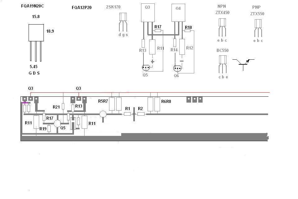

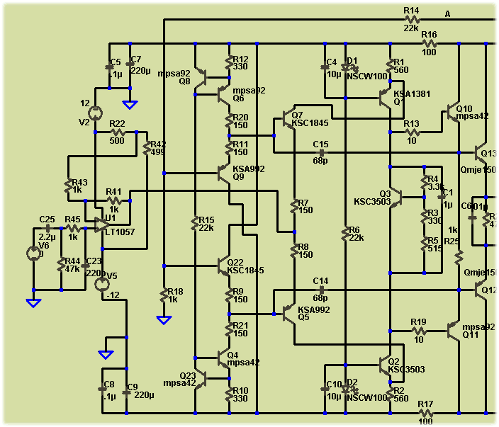

here is something that is part radford , part QSC , part folded. I admit I "stole it" from the VSOP (syn08) , but it works ... VERY GOOD. I drove a triple and a pair of IRF's with it. It also "bucks the trend" as far as sound goes for a full symmetrical amp .
OS
Joined 2009
Lots of interesting goodies in there 😉
Perhaps I should take a look at some symmetrical designs, that would be new for me. At least a look.
