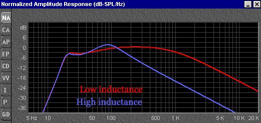

Here is a comparison of the old HE15 TC made for us back some years ago. This was a very high inductance driver. At rest and on inward stroke the Le was about 6mH and you can see this response in the Blue curve. As the coil comes fully forward the Le drops greatly. The blue curve is response on the inward stroke and red is response on the outward stroke. I think it is quite clear that there is effect over the entire frequency range. Now imagine a driver like this trying to play 1KHz where you have nearly 20dB difference in the response from inward to outward stroke. This is the "unique symptom" noted on the chart for IMD created in the current domain.
The next graph is one I did for the car audio guys showing the IDMAX 12(top graph) vs an AV12X(bottom graph). The IDMAX is not an overly high inductance driver and could be comparable to many hifi type woofers out there. You can see that there is again an effect on current even from 50-100hz as inductance changes. However when you take a very low inductance driver like the AV12X, the effect s very minimal up until well over 1KHz.
Then we need to look at the effect of Le(i) which is flux modulation. This is probably the biggest issue in distortion. All the symmetry that is worked to get in the flux field doesn't mean much if the flux isn't fixed in the gap. As the coil is energized it becomes an electromagnet. The more current applied, the stronger it's own field becomes. As this field moves through the gap it moves the permanent the flux field around. This isn't an effect seen in a modeled response curve, but is very clear if you do an FEA model showing the coils effects on the permanent field at various positions.
The key for a motor is to get the Bl(x), Le(x), and Le(i) to all be limited to inaudible levels. The attempts at linearzing Bl often create even more issues with Le(x) or Le(i). Trading one distortion that only has effect on sound pressure for greater issues that cause both sound pressure and current domain issues is not the right philosophy.
![inductance.gif](https://www.aespeakers.com/pics/inductance.gif)

Wow, those graphs are amazing! I'd never have expected changes on that order of magnitude. Any better idea of the Le of the ID driver?
This level of amplitude differential explains a lot of why better drivers sound the way they do. AlNiCo motors being less susceptible to flux modulation is a bigger plus here than one might have suspected. Underhung, likewise, makes more sense than ever, here.
