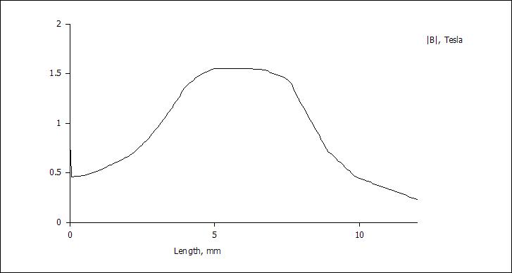

Re: Re: How can an overhung voice coil produce good sound?
Easily said, not so easily done.
This is the field along the gap for the original overhung construction I had in mind.
jneutron said:
2. Use a long length coil within any field whatsoever (overhung). As long as the ends of the vc are outside of any significant gap fringe field, the drive force will remain linear and constant.
Re: Re: Re: How can an overhung voice coil produce good sound?
It's difficult to tell the out of gap performance from that curve. Does it continue as 1/r? I didn't see a gap dimension, so can't tell from the curve, how far out one would have to go to pull in 99% or so of the integral.
And I agree, not so easily done. as a WAG from that graph, I'd think you would have to go at least another 15 or 20 mm in each direction to get low enough on the curve..too much a price in my opinion.
Cheers, John

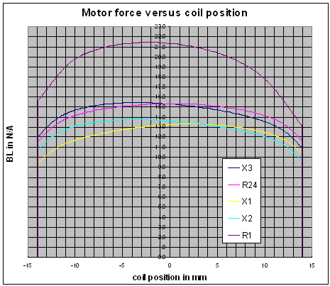

454Casull said:Is the LMS technology the same as the LMT technology?
yes, same technology from TC Sounds.
but LMT stands for Linear Motor Technology so LMT Technology is a bit redundant ( Technology Technology ) and maybe that is why they seem to have changed the name to LMS Technology which means Linear Motor System Technology.
here is the description from TC Sounds (Audiopulse is TC Sounds Mobile) describing the tech, referring to it as LMS Technology:
http://www.audiopulse.com/products/technologies/lms/
and here is the same technology described as LMT:
http://www.soundsolutionsaudio.com/forum/index.php?showtopic=2748
i think that LMS is the designation that will be used by TC Sounds from now on.
454Casull said:DD, AFAIK, doesn't even have any mechanism to flatten the BL curve. [/B]
why do you think it was developed for then ?
454Casull said:All it is is just a excessively-long voice coil. While you make use of all of the B, you waste most of the L. Sensitivity is extremely low for LMS drivers IIRC.
fact of the matter is LMS drivers have some of the strongest BL numbers of any drivers on the market now.
sensitivity is low because it takes a strong (and heavy) cone to handle the forces generated.
also if the BL was made any stronger the driver would not be able to produce bass because the already low QTS would become even lower.
voice coil is indeed very long ... of course imho you're way off on the "just" and "excessive" part

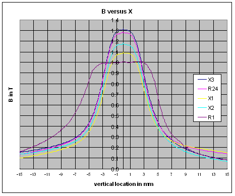

Variable coil winding pitch does work very well to make the BL versus X curve very linear. The big problem is that is does this by throwing away sensitivity. For a given gap dimension, you want to fill as much of the gap as possible with wire to get maximum sensitivity, because it is B cross L that determines motor strength and B is always highest in the gap. To use variable coil pitch to make the BL versus X function more linear, you must reduce the number of turns of wire in the coil (mostly in the middle). By definition, for a given gap width and magnet volume you are now reducing sensitivity.
As Jneutron seems to be saying, it isn't easy to look at a B versus X graph and tell how linear the resulting BL versus X function will be. To do this, you need B measured out very far from the center of the gap, and you must know the coil winding height, then be prepared to do some integration. Attached are some examples of B versus X and BL versus X for a couple permutations of a motor. In all cases, the winding height of the coil is 32mm.
Jack Hidley said:Variable coil winding pitch does work very well to make the BL versus X curve very linear. The big problem is that is does this by throwing away sensitivity.
i know this. this is why TC only puts this technology on the drivers with 4" diameter voice coil and 500 ounce quad stacked magnet.
TC at first had both 4" VC and 3" VC variants of LMS driver but it seems they dropped the 3" version. i have the 4" one in any case.
yet when compared to XBL the LMS wins because it only sacrifices some of the voice coil in the gap while XBL sacrifices a full half of it. not to mention LMS makes better use of the iron without any dead space that XBL has between the two gaps.
and when compared to DD the LMS has a flatter BL curve
with LMS when you sacrifice efficiency you only sacrifice that portion of it which is nonlinear. that is to say that with LMS when you sacrifice output you only sacrifice the distortion part of it, which i think is not a bad deal
i can also think of a way to improve DD drivers with variable winding density coils ... that would be ideal probably ... as linear as LMS but with less weight and perhaps less inductance.
