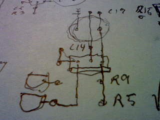

How is the quality of surface mount resistor
Seem there are many kinds, and difficult to choose
Seems in some places they would be practical to use, even with a mostly hole through design
In picture R5/R9 ordinary resistors are good to do the needed "jump"
But C14 could be a SMD
Well, here its a cap, but Im sure it could just as well have been a resistor in other places
