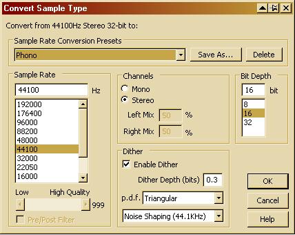

Nice article. That's what I'm doing when transferring LP to CD. Is that from our Werner?
Yes, it is. I think he got a bit tired of the audio magazine canards and bumper sticker slogans constantly having to be debunked, so it's a convenient way to get people to understand how digital signals actually work. Chapeau to Mr. Ogiers!
