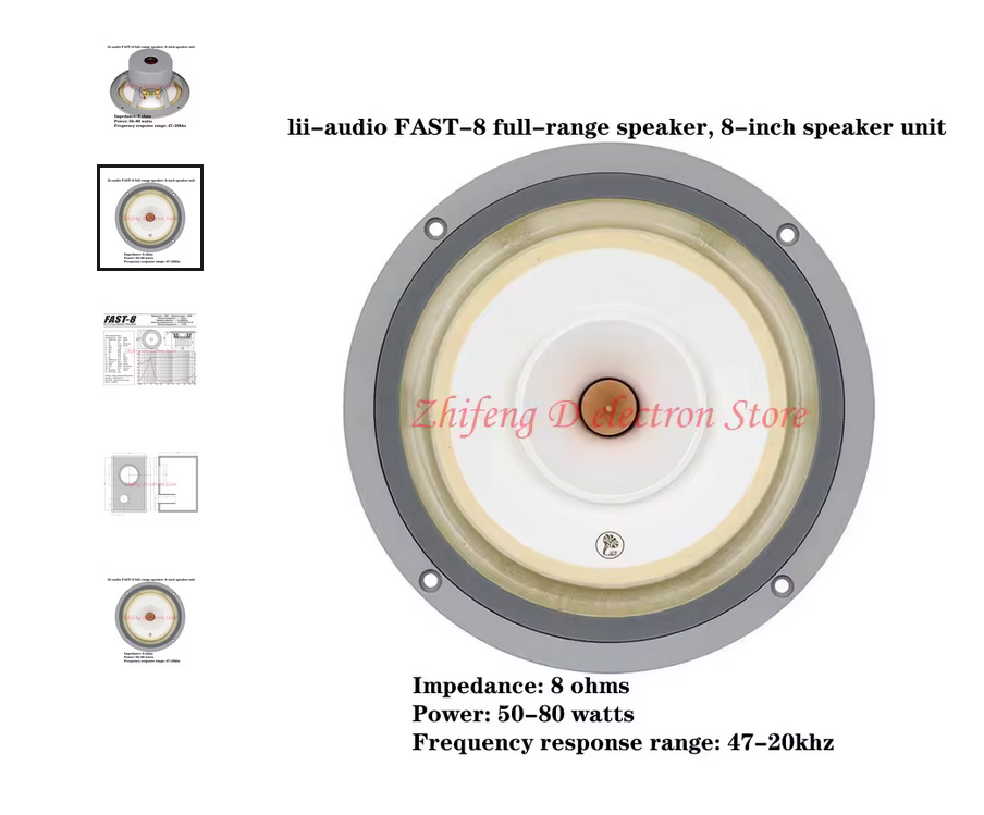

is the fullrange a legendary one?
Heard its paper is treated somehow with a sort of ceramics giving high velocity?
If its in mint condition why not change it with another aficionado who would prefer your looks and offers other surround colour?
whats the name of the driver?
Not legendary status at all. They're very popular in the open baffle communities out there, but far from being legendary. Inexpensive even.

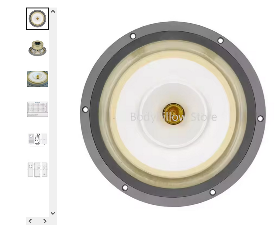

Lii Audio Fast-8's.
I prefer the fully bone/cream/ivory color like in the website image. The yellow was not expected. I don't hate the yellow, and I like how they sound. Love how they look. The yellow isn't my first choice though. True, I could change them out with something else, like a Tang woofer that looks similar I suppose. I dislike shipping speakers or anything around, too many problems with couriers and payment and people being scam jerks and stuff. If I ever did sell them it would be local hand off only.
https://www.lii-song.com/product/one-pair-new-8-fullrange-drivers-fine-and-clear-sound-fast-8/
The image on their site doesn't have the yellow band. Lii Song. But Lii Song & Lii Audio are the same company. Lii Song does international. Lii Audio seems to do local via Aliexpress and stuff.
Looks like several variations. Not sure what's fake, real, copy cat, etc, at this point.

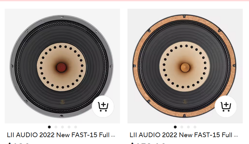

Some are immediately different like the Fast-15's with several variations too (the 15's are very popular):
