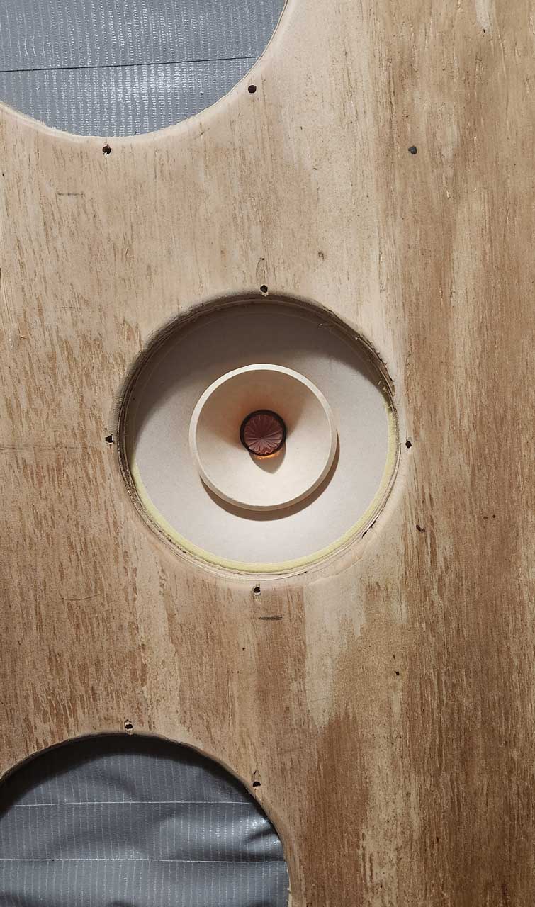

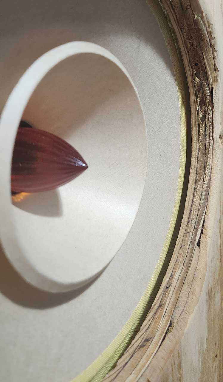

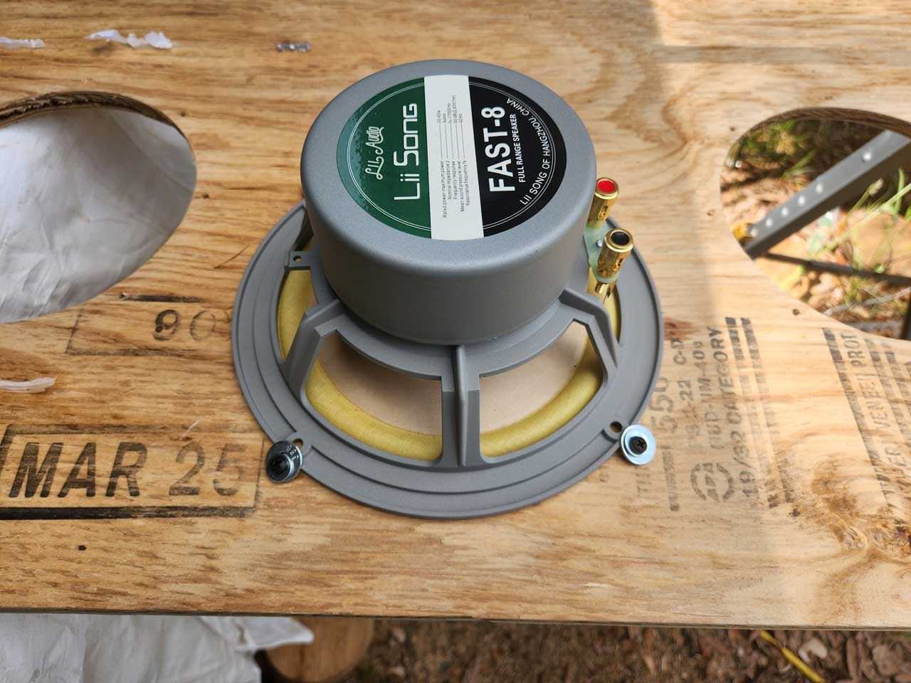

Ok, measured the cone, its 6" roughly and the cone without any yellow is about 5.75" so I could mask it up to that point. But you can still see a thin yellow ring. To me, seeing 3mm of yellow vs 12mm of yellow is the same thing. It's there. Less doesn't change it much. To me. Will see what the wife thinks. She definitely hates the yellow lol.
There is a 2~3mm gap between the driver cone and the material, so it shouldn't impact it since its not going to try to play double digit frequencies.

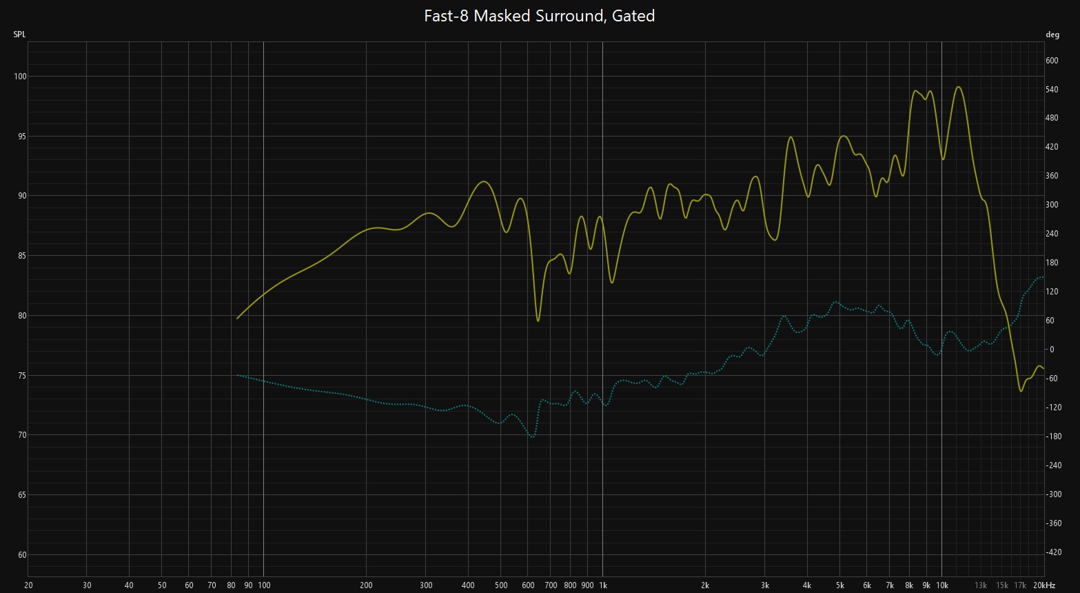

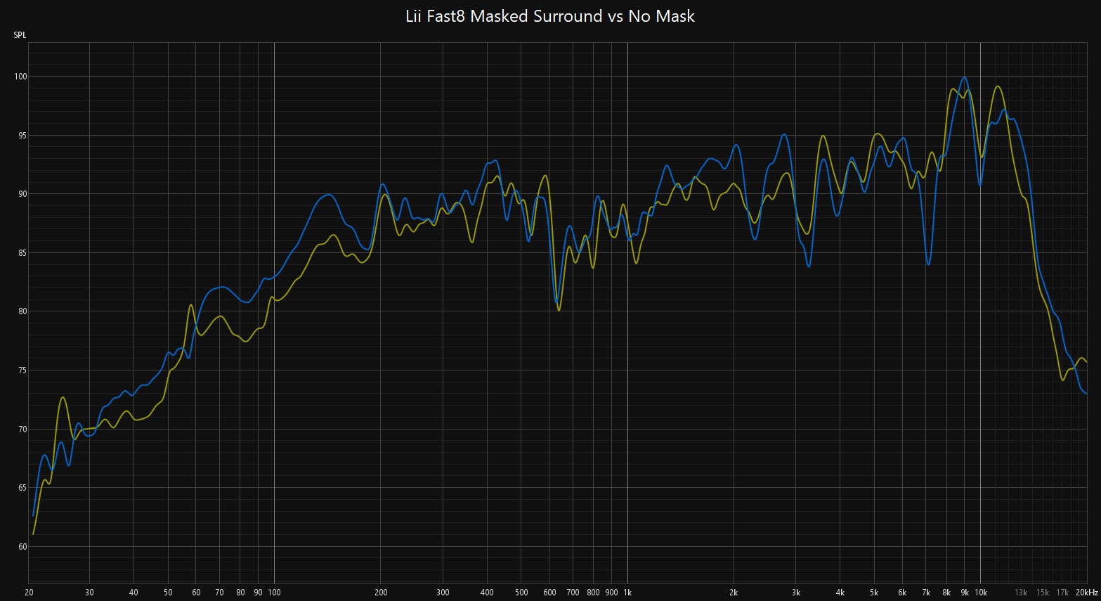

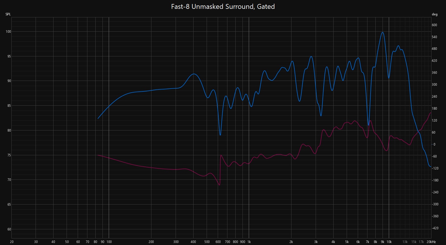

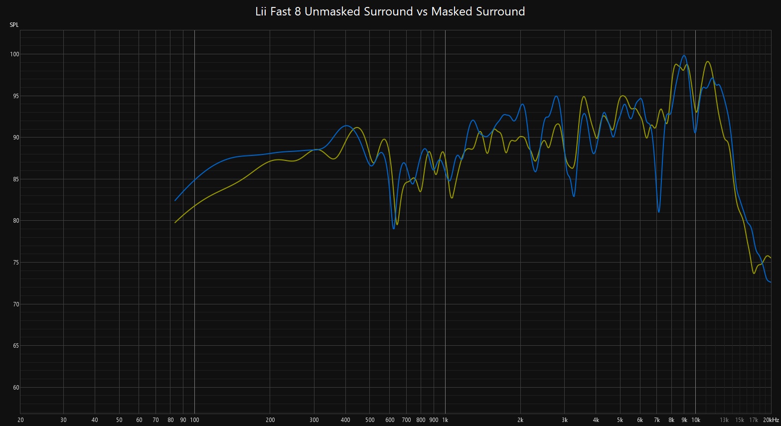

Ok dirty quick measurement differences, same baffle location and distances, no gating or anything, so this is not anechoic and there is influence from the room. But, it gives an impression I think. This is one driver in its baffle, surround exposed, the other driver on the other baffle, surround masked. The blue is masked. There was actually more bass from the masked version below 200hz. I wonder if the pressure at the surround up against the baffle loaded mass onto the cone a bit or something. Treble and mids are basically the same. So looks like I can mask this driver, if I have to.

Blue curve looks better than the yellow one.
I'll do a better metric in a bit, gate it, to make sure I'm not just looking at bias.
And I got them backwards. Blue is unmasked. Lighter color is masked. Derp.
There's a phase flip here at 600~620hz. ANd against heavy at 8khz. Unmasked.
Masked has less deep phase activity.

the 4 mm of the surround on the paper could be painted with less risk. Some thin white Edding
That's a very good point, I could do something like that. I'll look around for a bone/ivory color maybe. Otherwise, might just go brown. If it works on that, maybe it could be done to the entire surround.
Still reviewing the above masked vs unmasked response. It is different of course. Though when listening its not super obvious.
Very best,
As for preference, I just DSP'd the top end down a lot with a curve similar to what a contour filter bending it down would do, starting around 2khz to flatten it, and I honestly like it better with the higher treble. It sounds immediately veiled with the flattening curve. So maybe I'll accept the treble spikes.
So really just comes down to seeing the yellow or not I suppose. I like the cone either way. I would prefer to see the surround, I just wish it were ivory/bone color. I can live with it being masked, could try coloring the surround with a marker to a brown or ivory if I can find an appropriate color marker. Or leave the yellow.

I build a “waveguide” for the front of markaudio speakers and the first implementation extended to the cone, covering the inverted surround. It caused a bunch of distortion.
Interesting, how'd you assess the distortion to be distortion?
Very best,
With a Dayton emm-6 and rew
Thanks, interesting. So just increased distortion, do you recall about how much? Unacceptable I imagine? No response changes?
Very best,
Basically Everything changed. When I reprinted the new waveguide, everything improved and it was very apparent upon first listen. It was a significant improvement. Joseph Crowe had similar findings with a fostex driver.
From this, I just went back and looked at distortion on my two basic measurements of masked vs umasked, and yup, more distortion on the masked version from 700hz down, 2~5% more distortion immediately.
