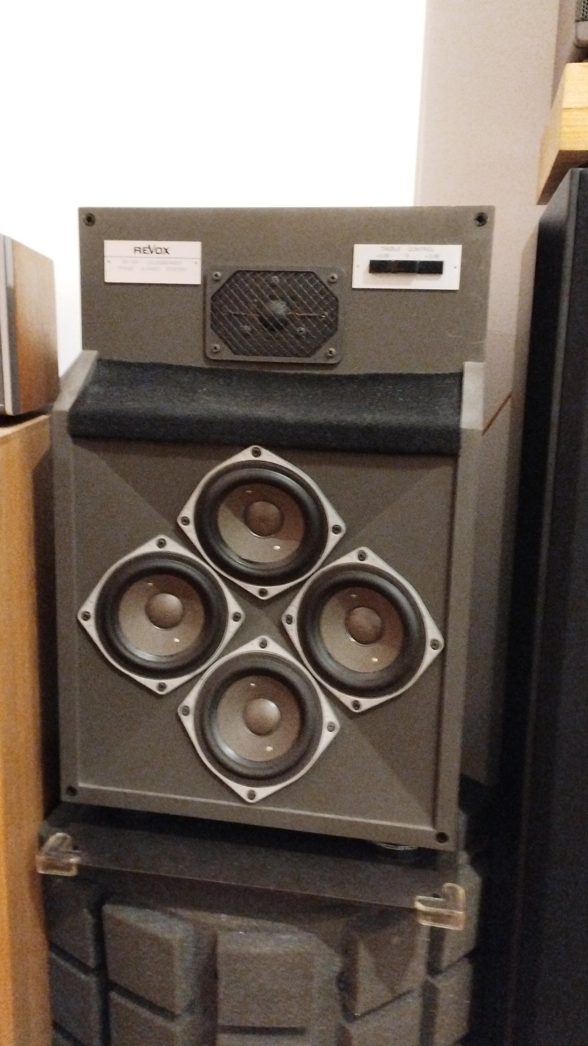

Here are Revox BX-350's in their natural shape and the very proper, one and only valid color:

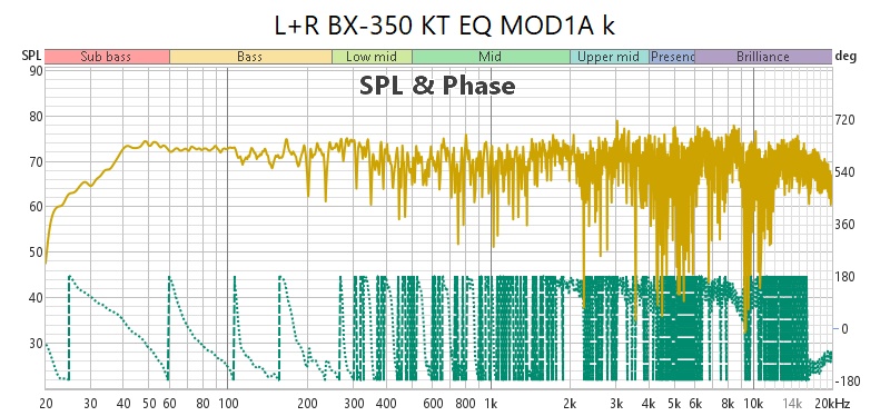

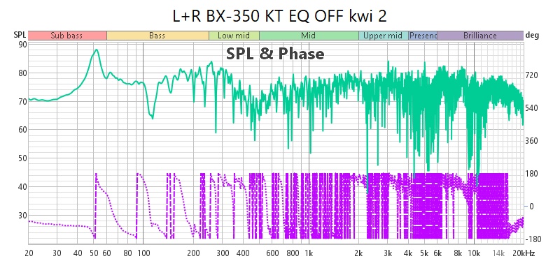

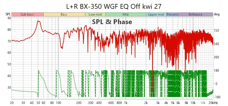

And this is in-room SPL and phase graph from REW captured with UMIK-1 in the listening position:
...the 500 Hz dip is an inevitable asset of BX-350 set, the roll-off over 15 kHz definitely not. Now with manual room EQ in APO and PEACE:

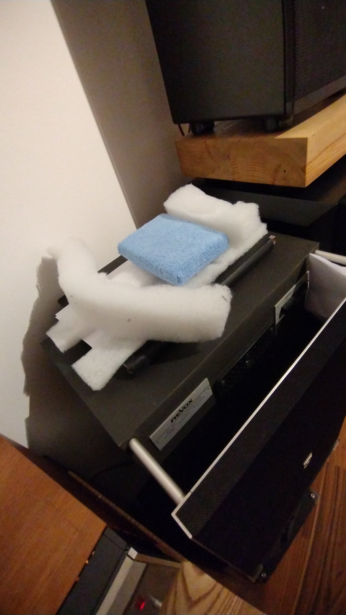

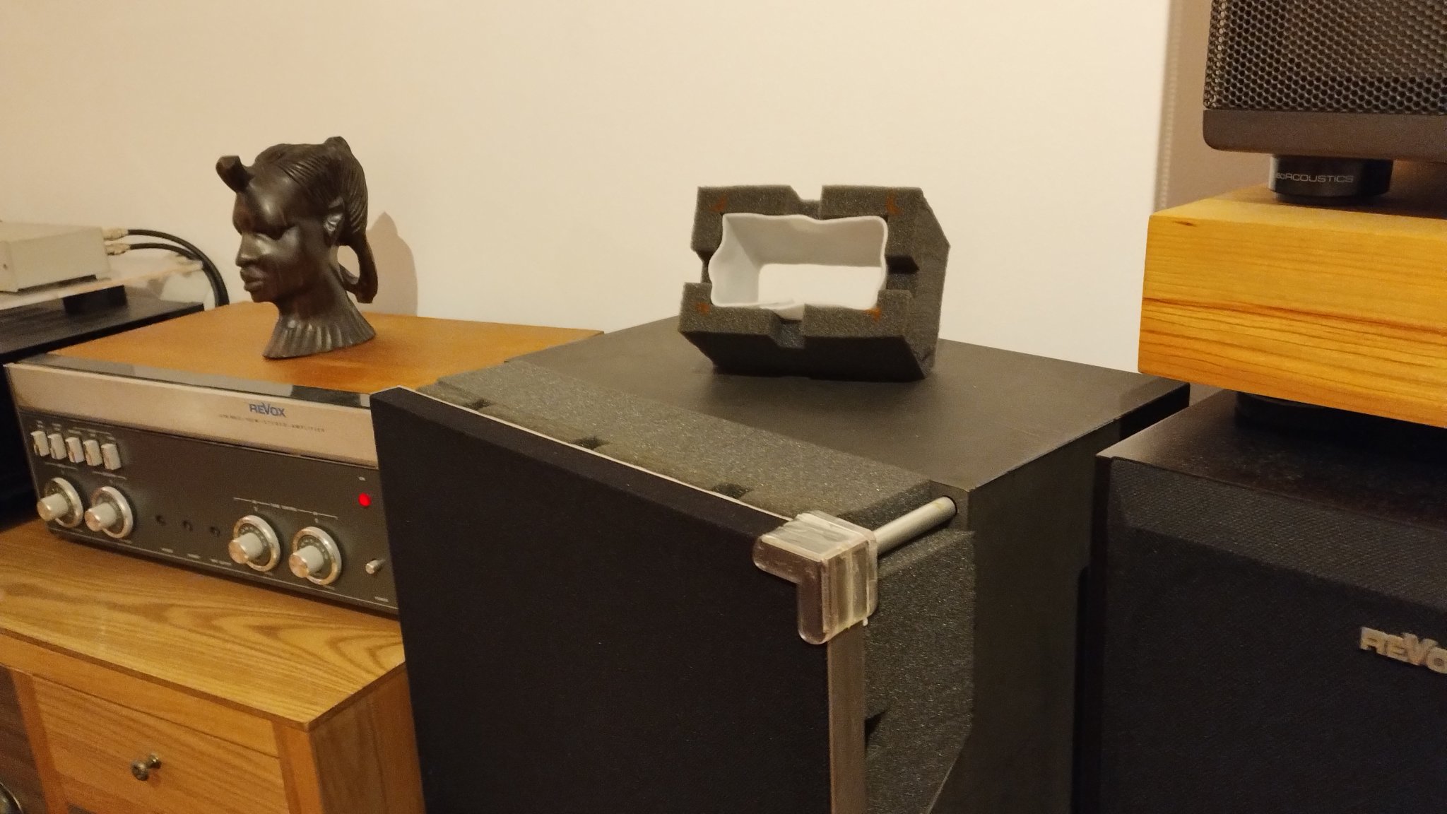

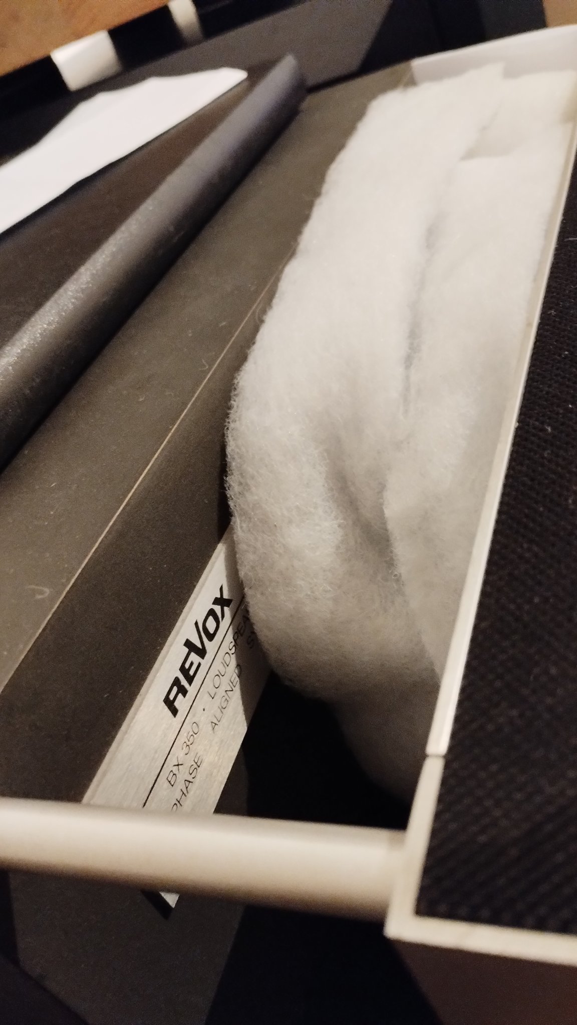

Prototype number one substrates: polyester wool, detailing tool that I use to clean up the vinyls from dust and an analog notebook:
And now the implementation of this sophisticated idea 😉
...and the notebook...

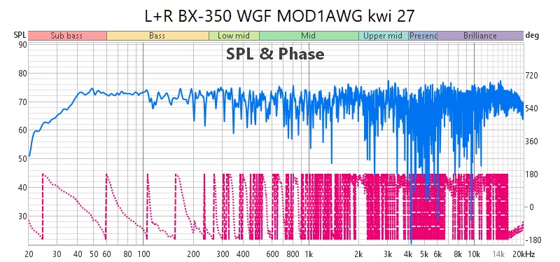

...and if this made you smile - enjoy 😉 but first look at the SPL and phase graphs without EQ:
...and with a manual room EQ:

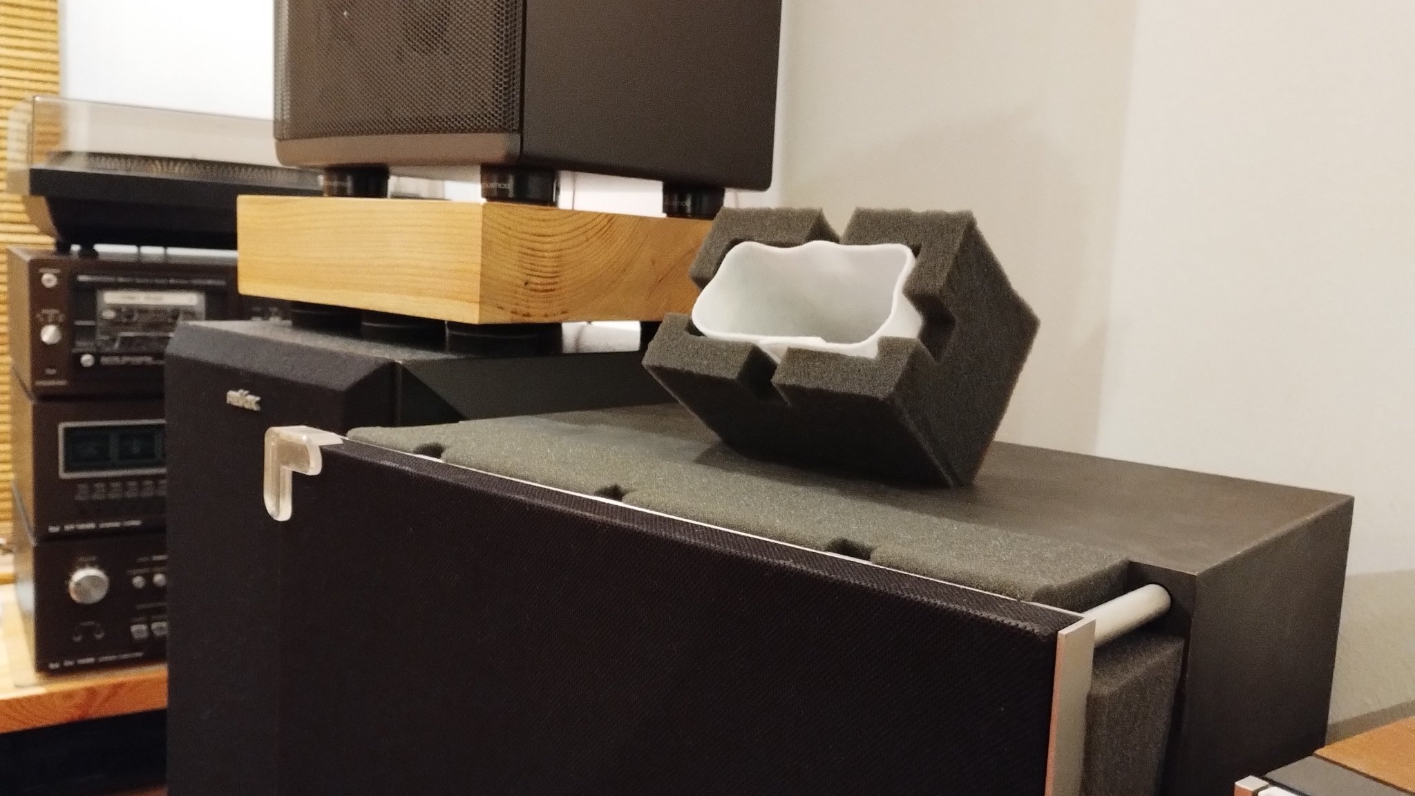

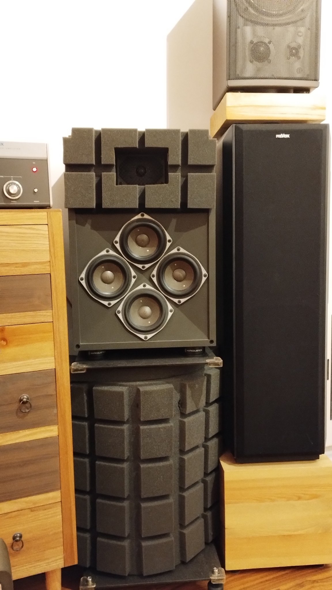

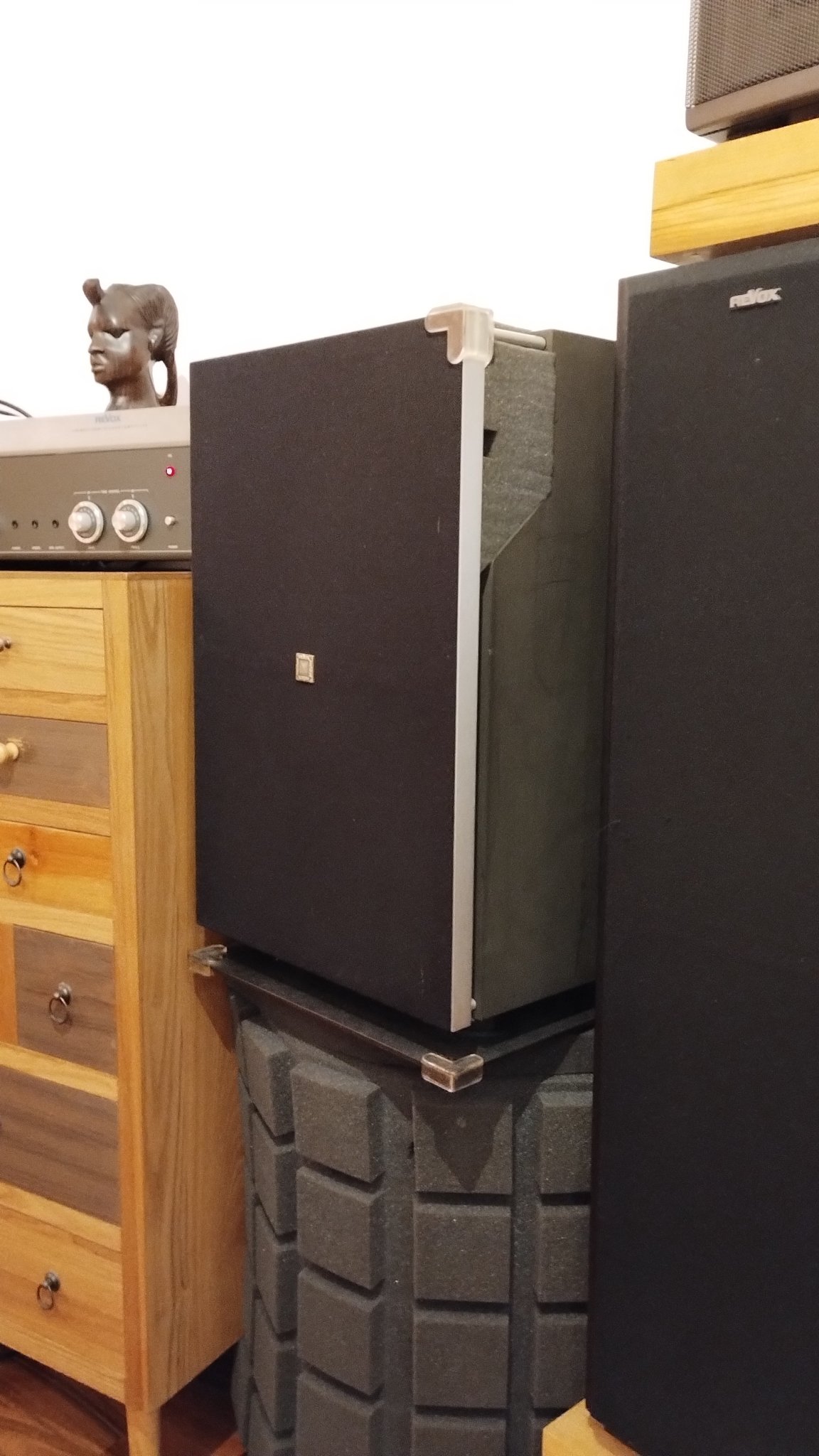

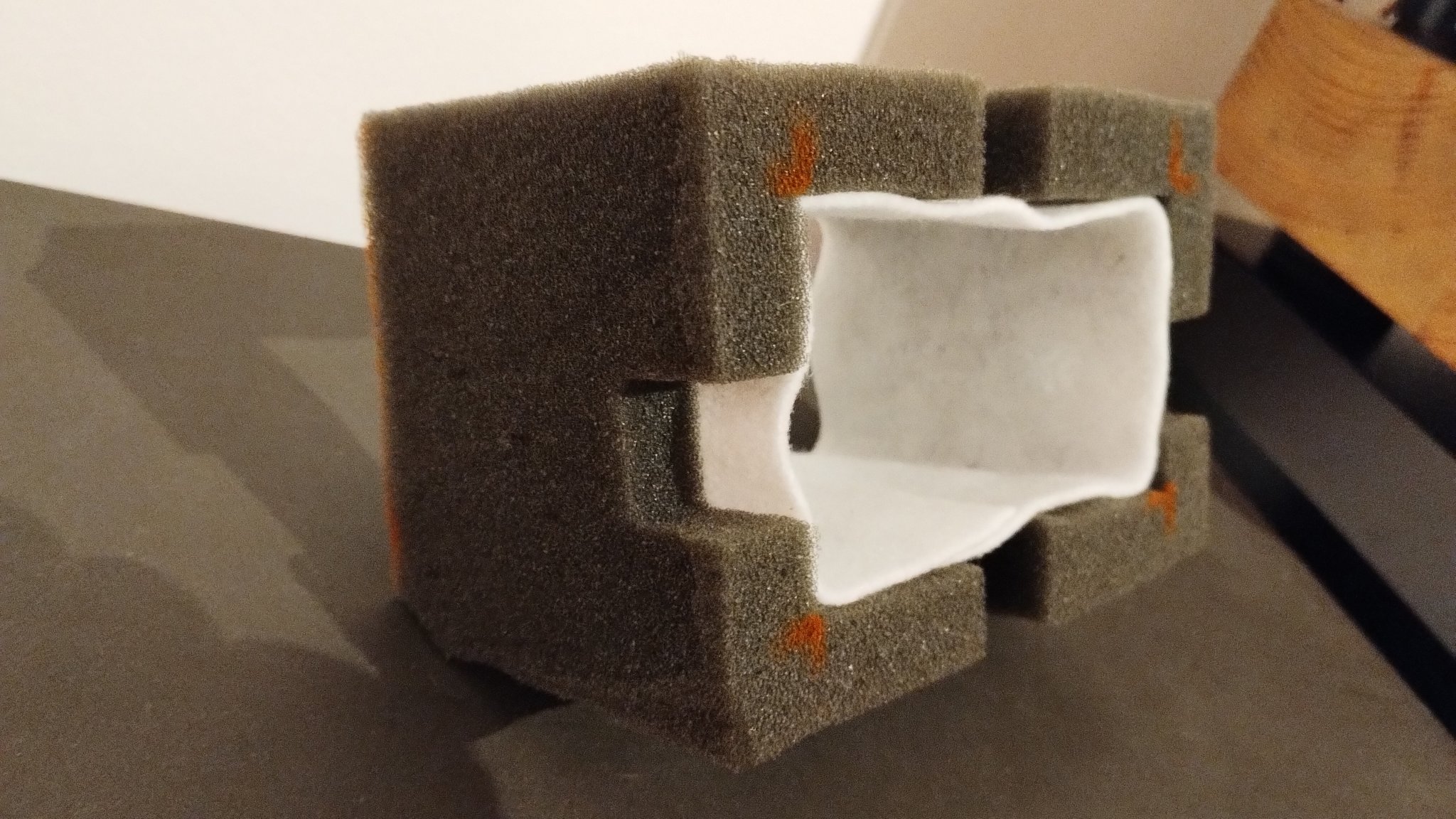

The second prototype - cut from an open cell foam to trap any sound trying to go elsewhere than perpendicular to the driver. Not a waveguide, not parabolic, not hyperbolic, just a primitive dispersion trap:
The pattern of a front of the foam is generic - just because I had this particular piece of foam panel. The driver:
...and the whole system:
What a handsome 😉
With an original 50-year-old grille mesh:
The measurements of a prototype 2 were not as impressive as its more primitive number one sibling. No EQ:
...with room EQ:

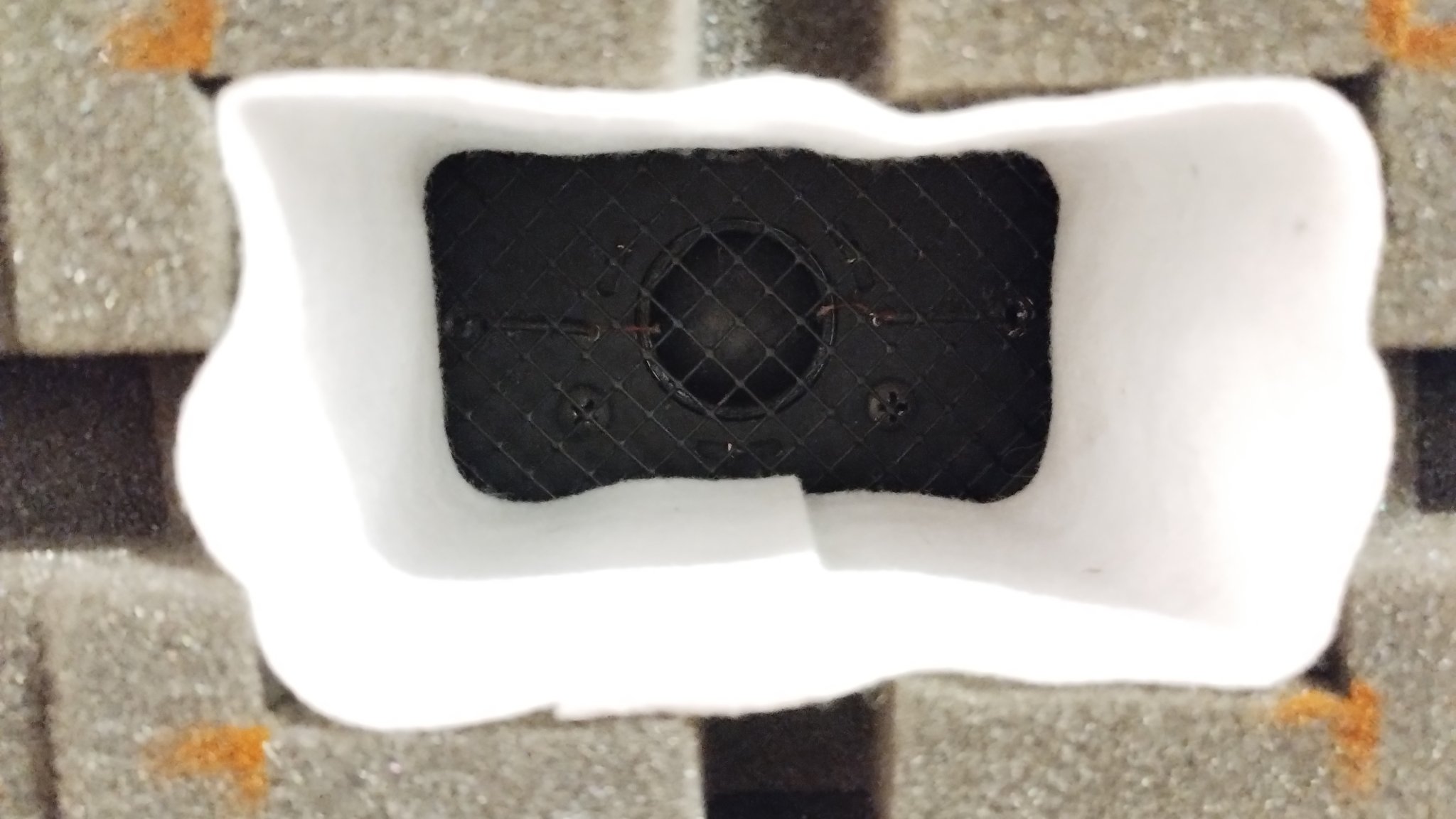

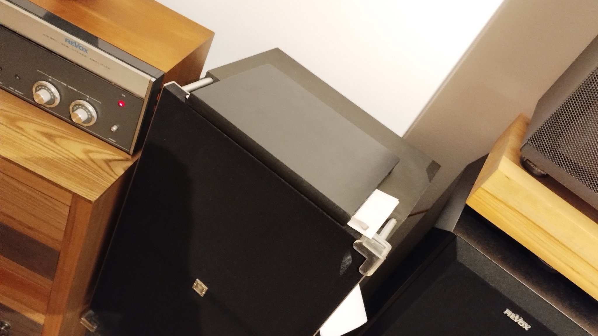

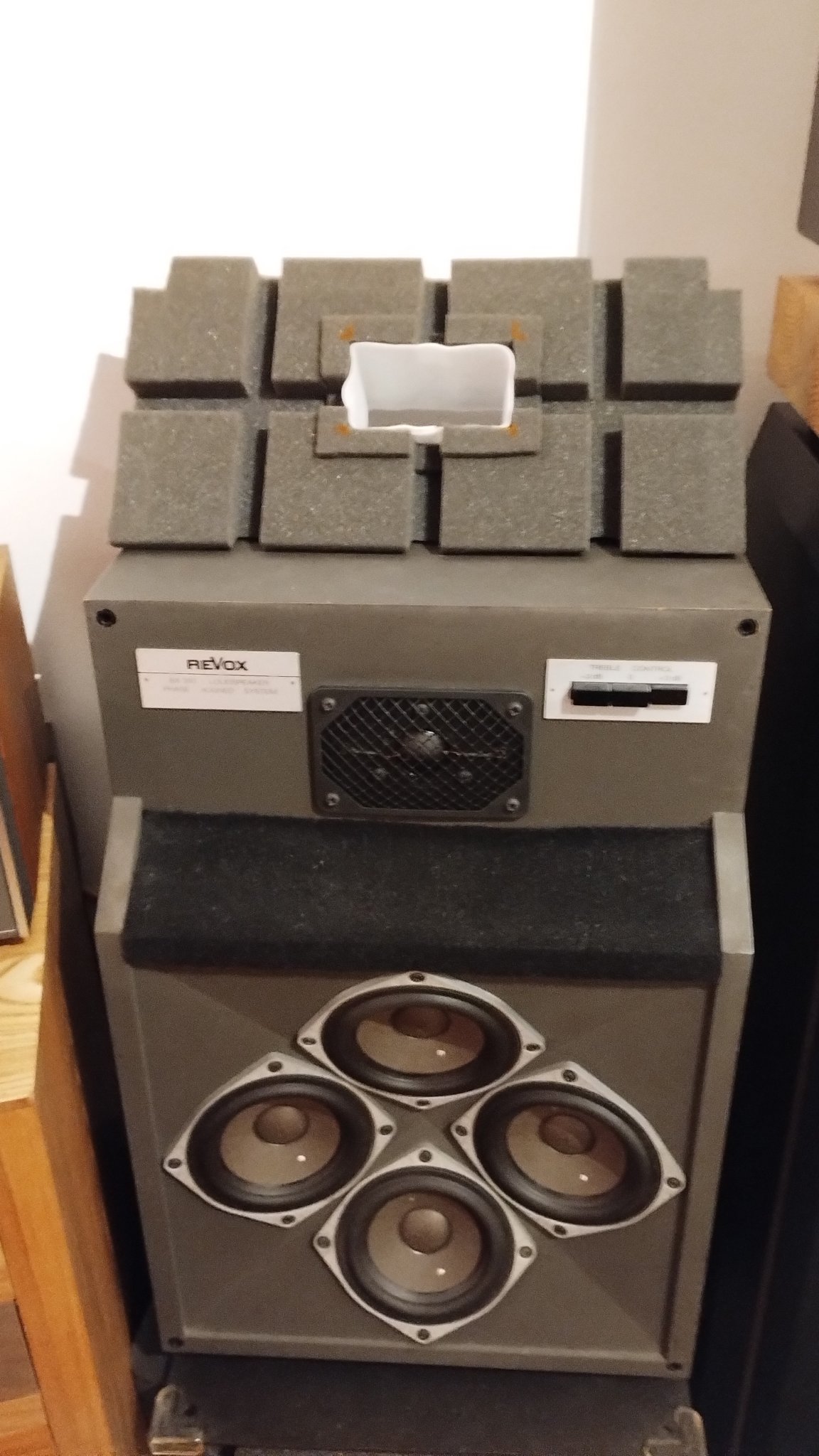

Prototype number three - narrower HF trap slot with additional layer of felt. The right one:
The left one:
The inside element closer view:
...the whole "HF Trap System" on Revox BX-350 😉
...closer:
...will be continued with graphs and photos in a minute 😉
What a handsome 😉
The left one:
...closer:

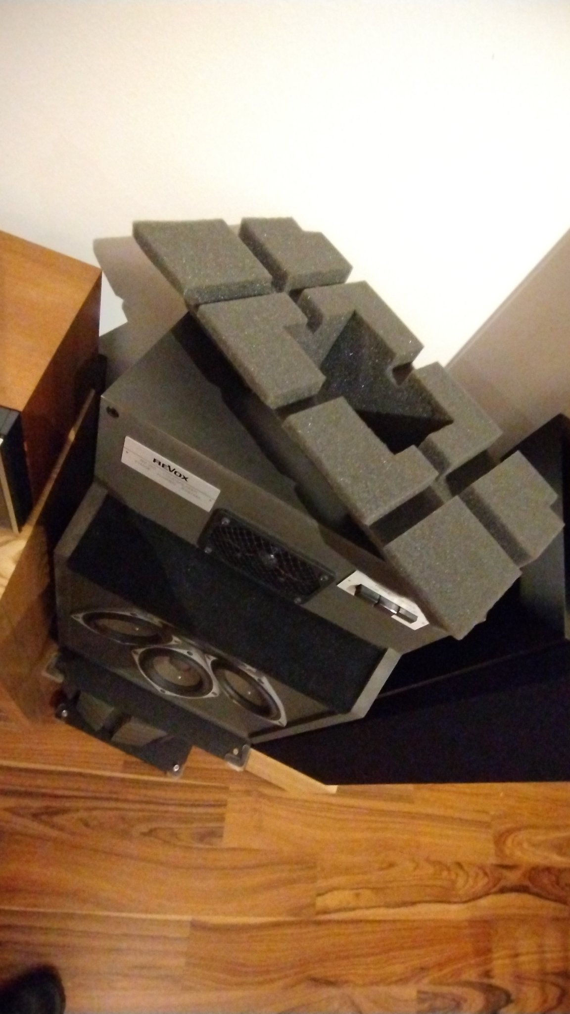

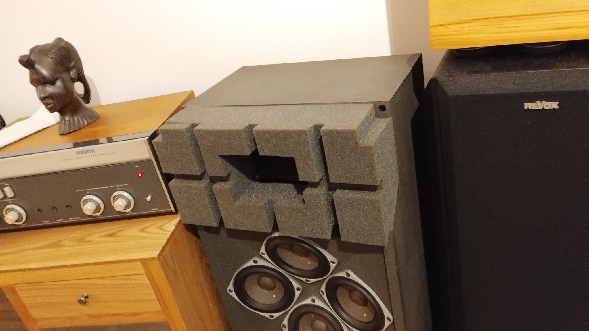

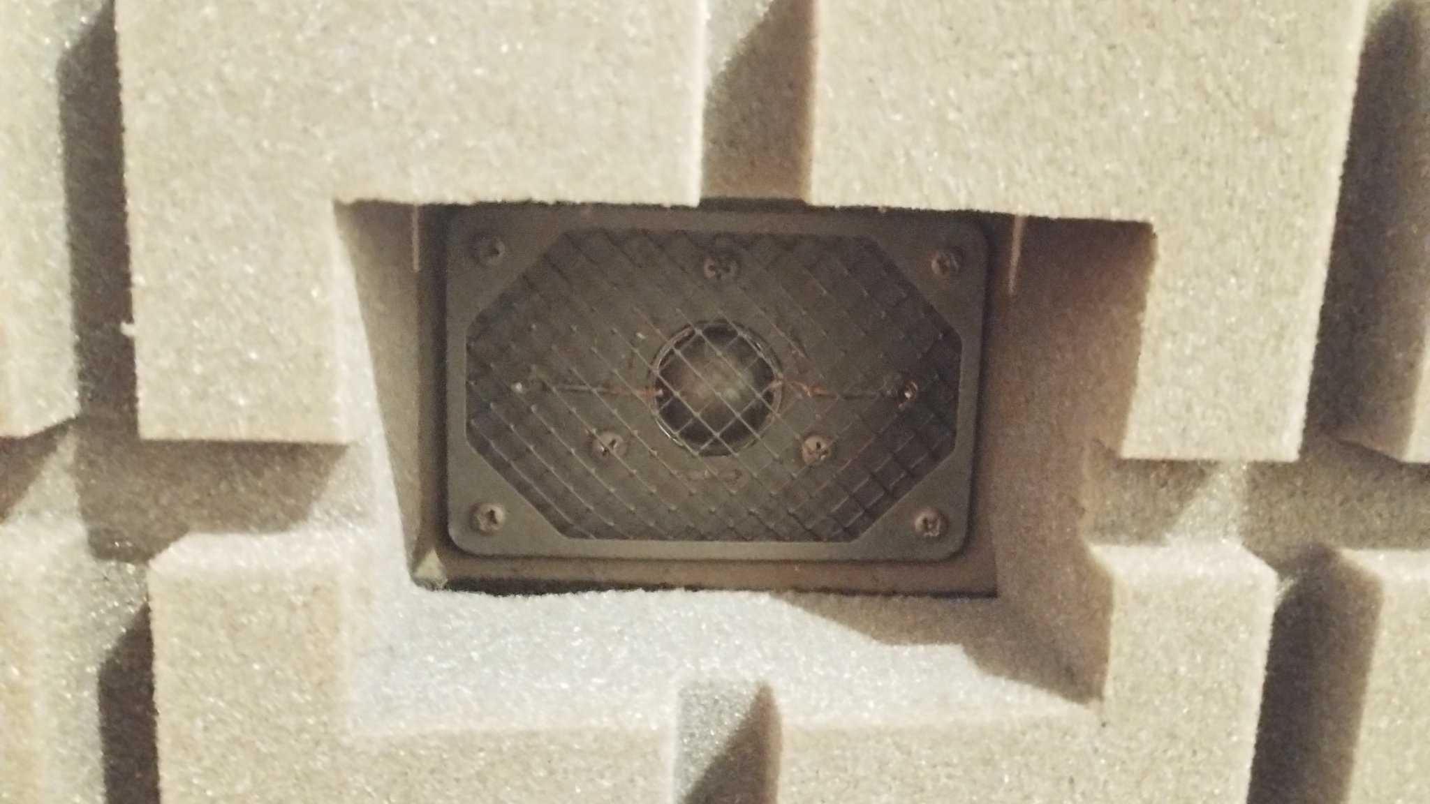

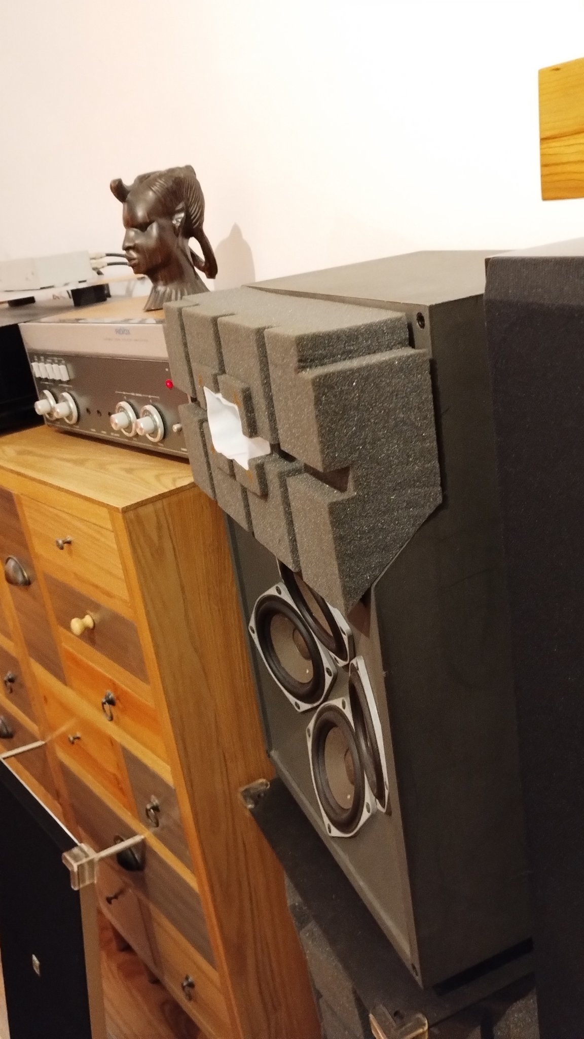

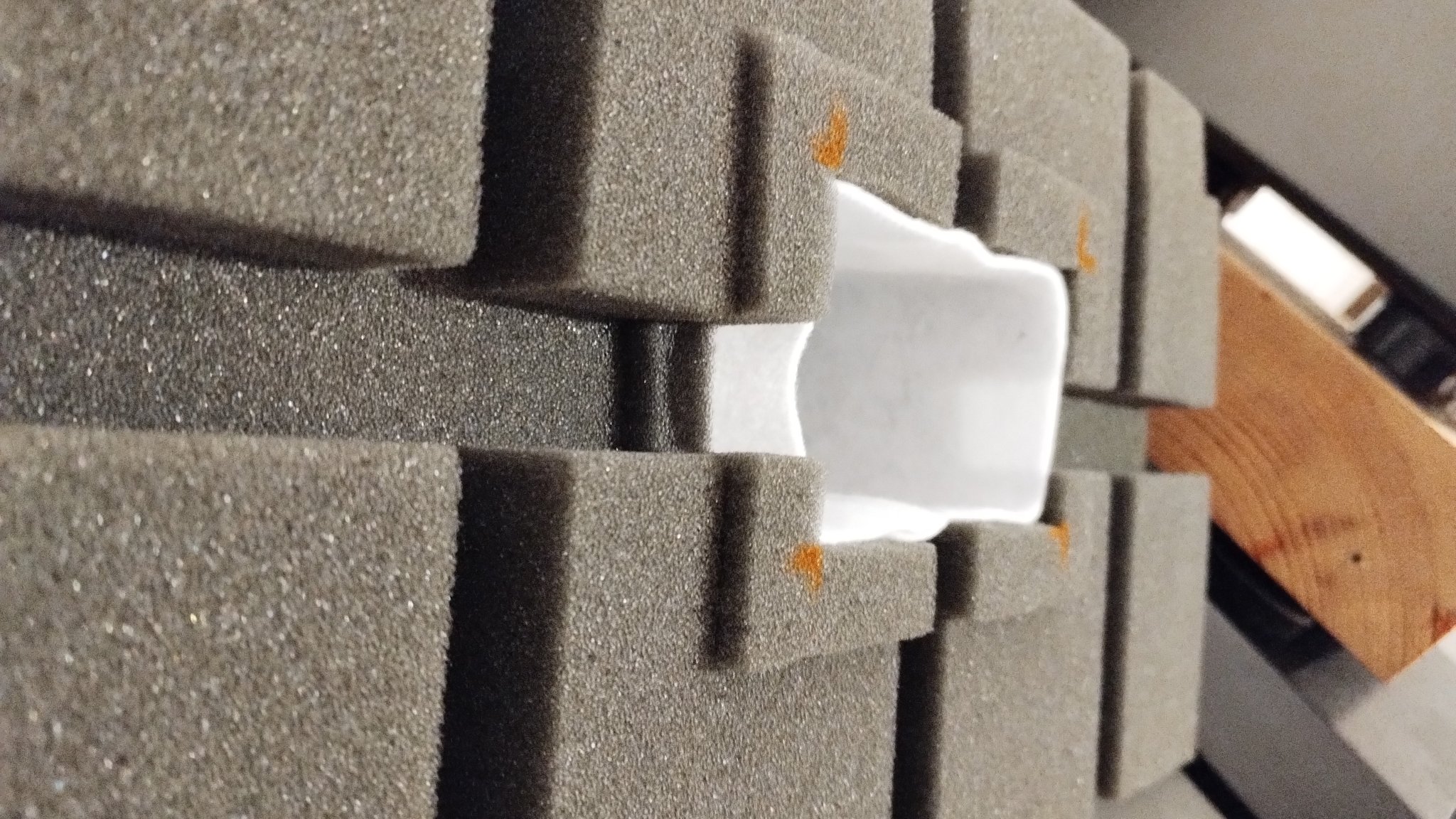

...continuing, the back side of the open cell foam panel with the place for the tweeter's grill:
...and implementation on Revox BX-350:
Yes, I know the angle of the lower cut line of the foam is not at the optimal angle but that's still a prototype. The driver in its damping room 🙂
...and the whole system prototype ready to be measured:

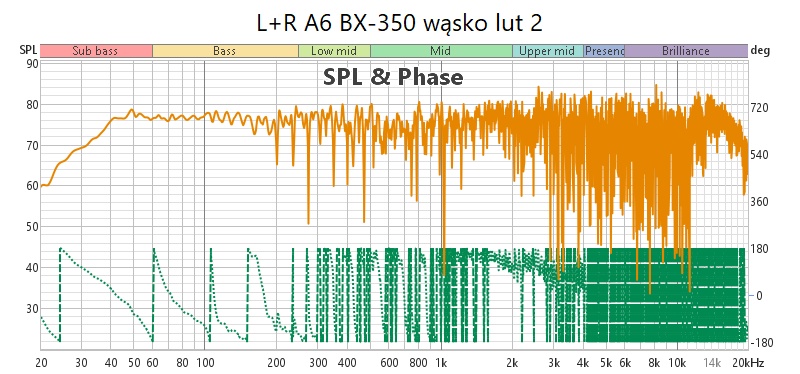

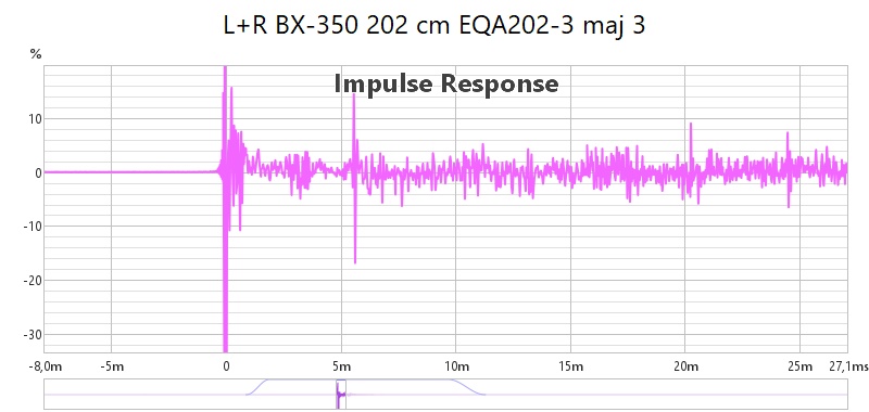

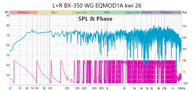

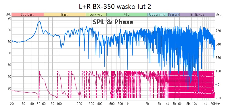

The SPL and phase without EQ with something new, a 5 kHz dip:
...the 5 kHz dip could easy be fully resolved if PEACE EQ had more parametric EQ slots. Despite the no-waveguide, no-parabolic and nonhyperbolic nature of the HF dispersion trap and despite its primitivity, the changes are evident in the HF section of the graph in both SPL and phase plots. A few important details to measurements:
And now the most important area - the listening experience. Believe me or not, but that was the most surprising change in the sound system character I have ever heard. The HF trap can catch above 3200 Hz crossover point and of course something a bit lower but is limited to the tweeter. That should sound unnatural as part of mids has free wide dispersion and higher mids and the rest of HF being limited by the primitive felt-foam trap. But that's not the case!

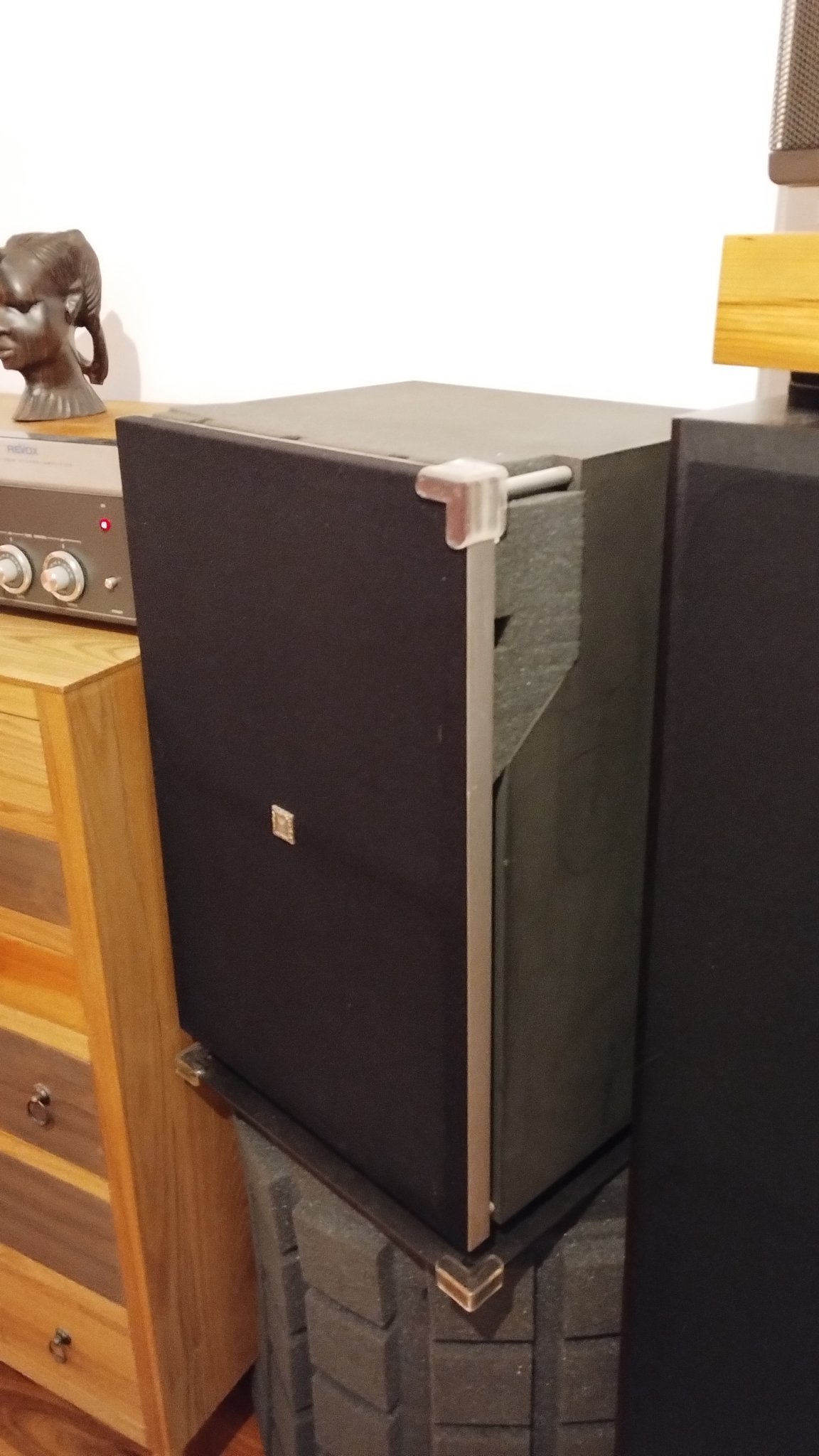

- measurements with EQ were made with some attenuation integrated in the PEACE EQ to prevent clipping in the signal chain,
- measurements of prototype number 3 were made with HF attenuation switch on BX-350 set to +2 dB

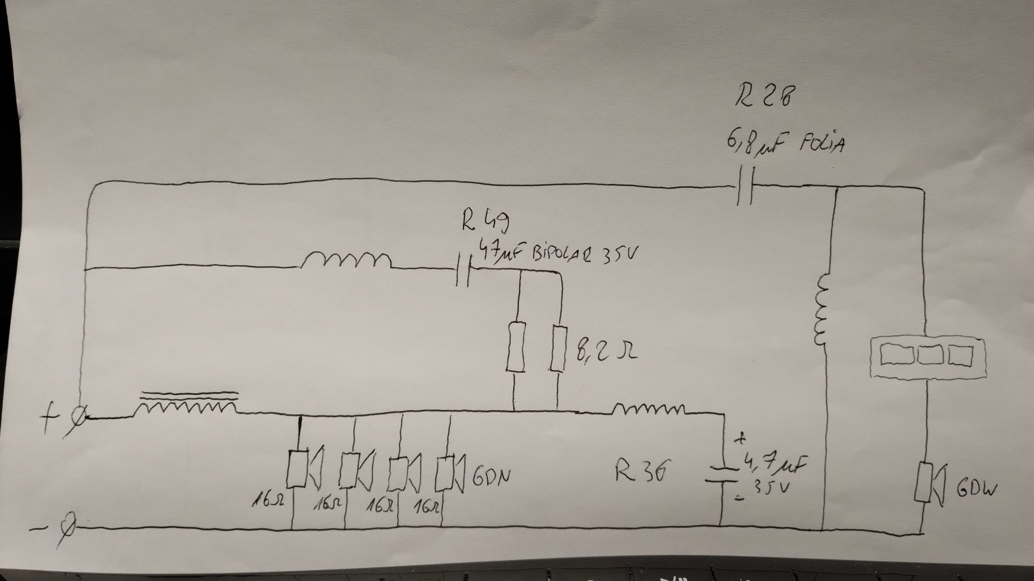

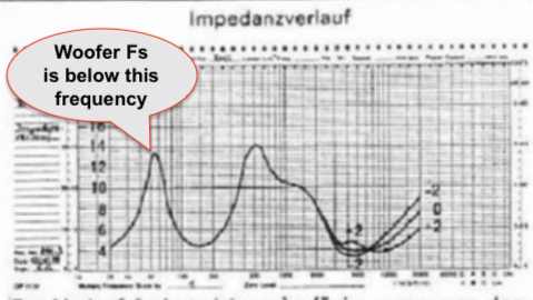

Mike,The Revox BX-350 by nature have heavy attenuation on the SPL graph surrounding some 500 Hz - that comes from the every single mid-woofer factory 400 Hz Fs increased by the enclosure. I guess.
Guess again, the free-air resonant frequency (Fs) of the woofers is not 400Hz, it is below the Fc (speaker in sealed box resonance).
The dropping impedance above Fs/Fc is normal, the second impedance peak reaching higher than Fs box resonance is due to the crossover design.
Because a "phase plug" in the center of the pyramid won't reduce the center to center distance between the drivers responsible for the constructive and destructive interference patterns off axis, also known as "lobing" or "comb filtering".Why not to put a phase plug in the center of the factory mid-woofer pyramid?
Art
Art,
my guessing was rather of a rhetoric nature 🙂 as Revox puts the resonant frequency at the magnets of their speakers. In case of a Revox BX-350 mid-woofers it reads as following:
...four of such drivers are connected in parallel. I have such spare drivers on the shelf from BX-230 (with 8 Ohms and 400 Hz Fs), can measure their impedance peak outside the box. I bet it will be exactly 400 Hz. Studer barely made any mistakes and it's hardly possible that they added a zero to the Fs of their drivers label by chance.
At the very beginning of this thread, I gave a schematic of BX-350 crossover. If you can find any circuit there which could bring such a peak in 500 Hz impedance then please explain, how it works. What I can see there in mid-woofer line is one LC band trap parallel to the mid-woofers and one RLC band pass bypass parallel to the main LF inductor. Both solutions actually make impedance lower locally at the SPL graph, as far as I understand the electronics. Crossover frequency is 3200 Hz. I bet that 4,7 uF and its series inductor address some resonance and 47 uF with inductor and resistors try to increase the SPL in certain frequency range. Look (GDN are mid-woofers, GDW is a tweeter, R means raster of capacitors - not important):
As to the phase plug - in a single driver, phase plug also does not alter distance between cone outer edges by the cone diameter and despite that it works, pushing some unwanted frequencies about an octave higher when half wavelength reaches cone diameter. As you do, I also hardly believe it will work in the center of four mid-woofers, but it is not enough for my mind not to give it a try 😉

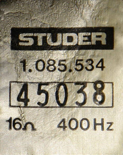

I'll bet the driver's impedance will be ~50 ohms at it's Fs.Art,
16 ohm 400Hz is on the back of the driver, but Hz is cycles per second, not Fs, free air resonance.
I would not bet against the driver's impedance being ~16 ohms at 400Hz, or that it's impedance minima is near 400Hz.
Without the raw impedance curve of the drivers and the inductance of the crossover coils I can only guess about the circuit.At the very beginning of this thread, I gave a schematic of BX-350 crossover. If you can find any circuit there which could bring such a peak in 500 Hz impedance then please explain, how it works.
That said, I can't read the frequencies on this chart recorder impedance graph with a magnifying glass, but if the crossover components are not responsible for the peak, then the individual drivers must be ~50 ohms at that frequency.
Looking forward to seeing your measurements of the driver's impedance response!
