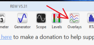

I just went into the chart "comparison mode", if you press this button then you will also have this button.Why your REW has an STEP button and mine does not?

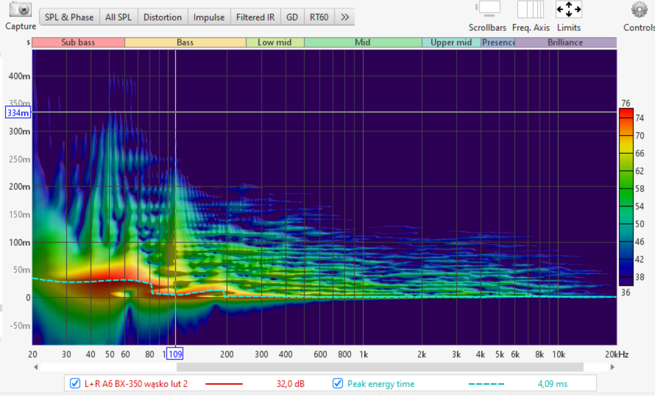

This speaker system had a resonant tail at 109 Hz after correction. This confused me, since they usually try not to add resonant tails during correction. And that's why I thought that the measurements were simply taken in different rooms.
I already understood why this happened, but that's not what I was thinking about then.

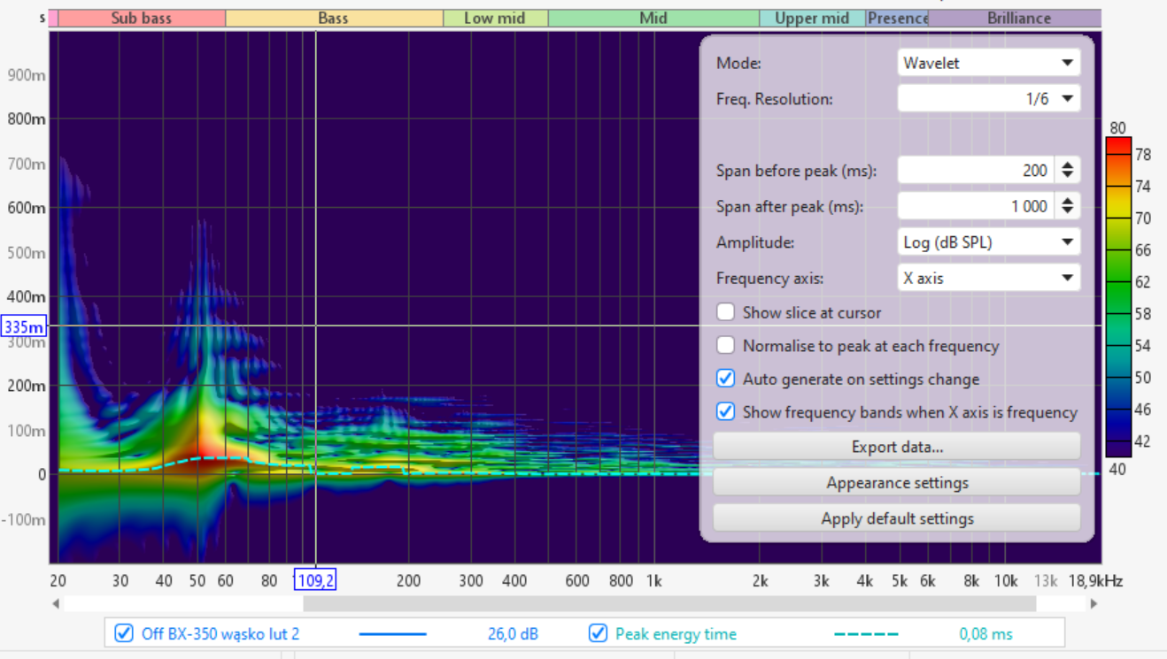

This is the spectrogram of the speaker system with correction.

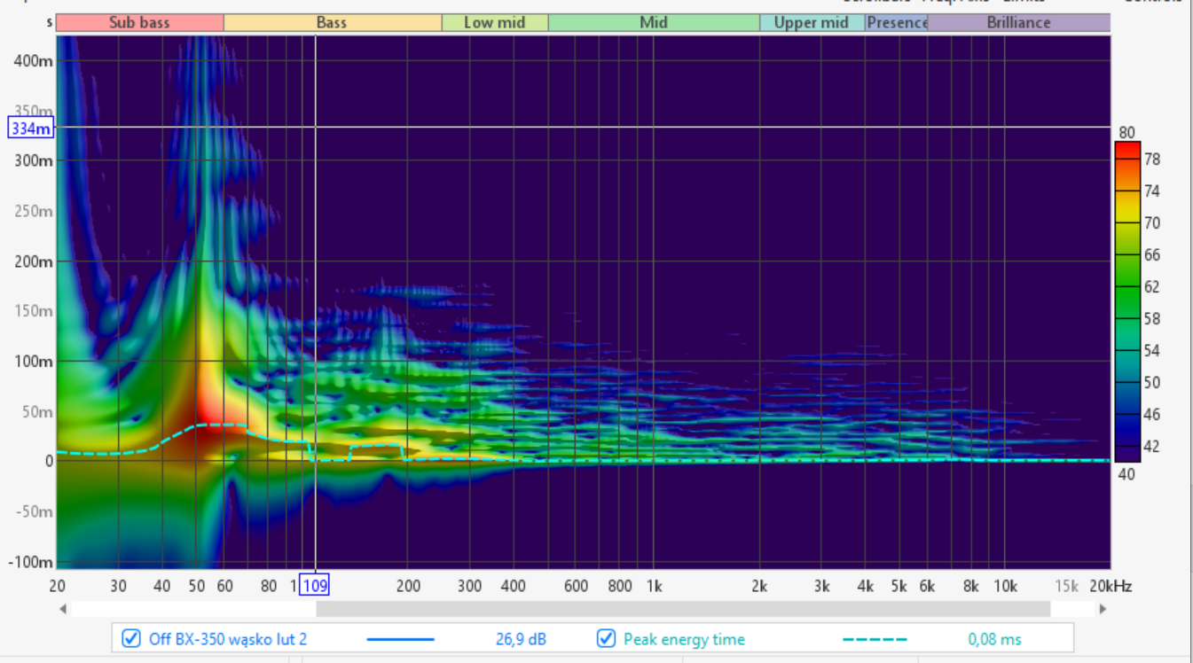

This is the spectrogram of the speaker system without correction.
The Y axis in the pictures shows time in milliseconds. As you can see from the picture, the correction added a resonant tail at 109 Hz.

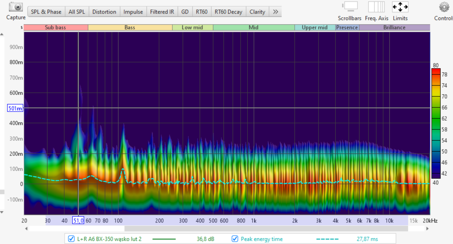

You are perfectly right - I sacrificed some resonance in favor of a flat FR which is not a perfect solution. And that was partly because I usually focus on FR when applying room EQ which I apply always manually, not using any auto-eq and it is a very time consuming process. If I understand well what you pasted here, you applied some time gating to this spectrogram:
...but still this 109 Hz resonance remains a question to solve. Should I leave it and maintain maximizing FR flatness or EQ a dip in FR to cancel the resonance? And this resonance at 109 Hz is added by the parametric EQ, as room has almost a null here. The 109 Hz EQ was added to even the bass notes SPL in clearly recorded and mixed genres of music, with separated instruments. In heavier mixes of rock and metal this 109 Hz makes an uncomfortable mess.
It's up to you, not me. Usually, they try not to compensate for the pits, so as not to overload the speakers and not get tails, but this is not the law. Sometimes I partially compensate for the pits, but I boost the desired frequency no more than +3 dB. Very rarely no more than +6 dB, but all this is controlled by ear and the final decision is made after listening to musical material of different genres.Should I leave it and maintain maximizing FR flatness or EQ a dip in FR to cancel the resonance?

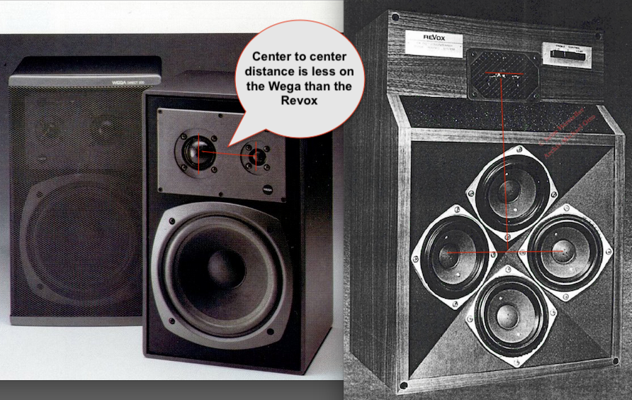

I suspect the difference in presentation probably comes down to the center to center distance difference between the Wego D200 and the Revox BX-350:The differences may come from a radical way that Revox had chosen to impulse-align BX-350 drivers, that's a stepped baffle. I am doing in-room listening triangle measurements on purpose as they - just as you mentioned - show how do the speakers go on with room modes, reflections etc. I am aware how different these speakers sound and can easily express these differences by air as far as tonality, precision, scene or dynamic abilities are concerned, but these are all just perceived and sometimes quite abstract criteria. Reproducing reverberation/echo from the source material by the speaker drivers is a very instrument-dependent subject, as every instrument and every room, never mind a real room or virtually added by reverb plug-in into the mix, has its specific spectrum of reverberation that is the most obvious for the listener.
The Wega has a much more compact center to center distance, so it's off-axis response should be more consistent throughout the room. Since you are hearing a combination of direct and reflected sound past the near field of the speakers, the more compact virtual source can reveal details that may be obscured by the larger spacing.

about the center to center distance - that's even worse that it seems from the first sight. That's because Revox has to deal not only with the distance you mentioned on the photos around the crossover frequency, which is 3200 Hz. Those four woofers play exactly the same signal, always and when we check out the 1/2 wavelength driver placing rule, these tiny woofers are much too far from each other to prevent lobing both vertically and longitudinally. Probably that is the reason why the baffle is not even but has four sloping surfaces meeting in the center point between woofers - their designers were aware of the challenge. But that's why I measured SPL vs amp volume with pink and white noise graph from the near field to have a clear picture how these drivers perform on alone. Almost on alone, of course, as full acoustic separation in such measurements of the whole speaker cabinet is not possible.
I still believe that a speaker that is not so good in echo/reverb reproduction should be louder at higher input signal and quieter at lower input, those losing the nuances as reverberations and hiding them from the ears of the listener. From my point of view the higher SPL of the speaker does not count as the listener always adjust the volume to feel comfortable at the peaks not the quietest parts of a source material. So if we have speakers with higher SPL we listen to them at lower amp volume, and those with lower overall SPL - with higher volume and if both speakers had similar SPL vs input signal graph slope, the effect should be pretty similar. But it is not 😉
Another thing to consider is that Revox woofers act as mid-woofers. Wega woofer is crossed over at some 900 Hz, Revox - at 3200 Hz. Wega has a sealed midtone dome which I prefer very much because it does not use a support of air volume from the back, as midtone cone drivers do (they have a separate closed volume for their exclusive use). Revox woofers always use the whole cabinet volume, even when playing around 3000 Hz and that can be evidently heard. But should it "eat" the source signal echo/reverberation of instruments?
