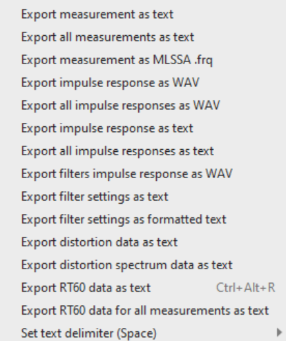

Which one of the files would you like? There are several export options in REW:What is the problem with giving the source file in REW? You can give two files, I will combine them and analyze the measurements in a more convenient form than you provide.
Like anyone could tell what is what just by listening to the system, including the listening room… but I’ll stop pointing at the obvious.This is about rerpducing recorded decays... and not decays added by the reproduction system.
Here 🙂No need to export measurements. Give me the REW file itself, which contains the measurements of these speakers. Just attach the REW file to the message, as I did for the example.
Okay.

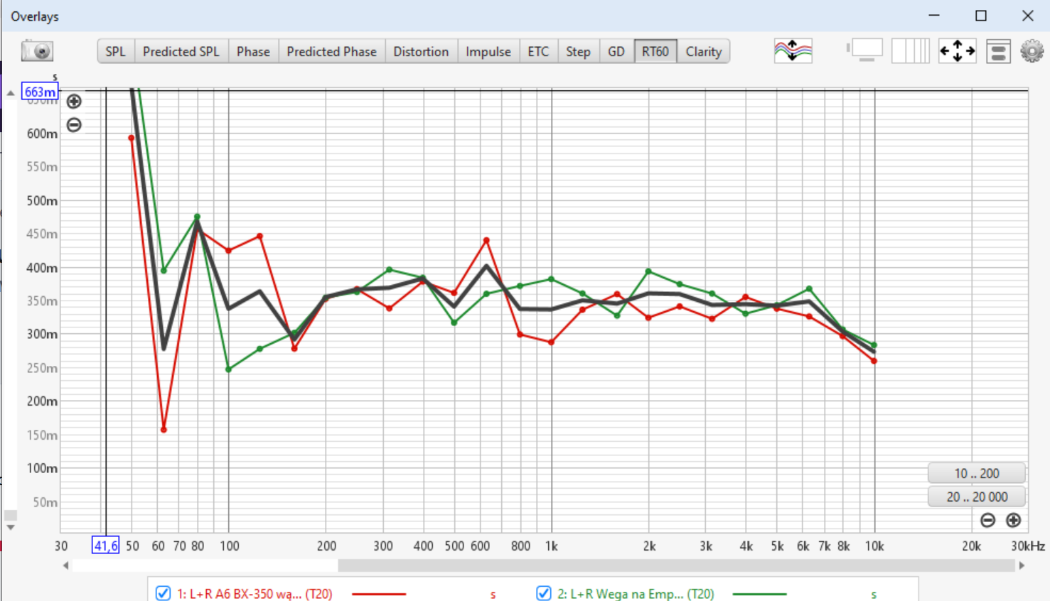

We look at the RT60 graph, this is the signal decay time at -60 dB at each frequency. As you can see from the graphs, each speaker has a different signal decay time at different frequencies, this already shows us that these speakers cannot sound the same in these acoustic conditions. We don't pay attention to the black line.

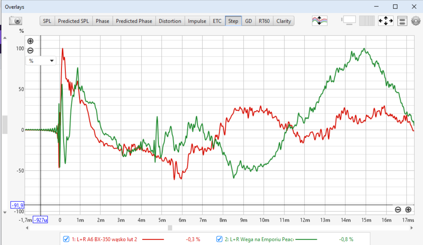

Next, we look at the step response. These two speakers have very different step responses, I don't want to describe what depends on what, but I think it's worth mentioning that in order for the speakers to sound the same, they must have the same step response. Or very close to each other.
In all your measurements, the room itself greatly influences the measurement result, but if you measured different speakers in the same room, then in fact we see how the speakers behave together with the room, roughly speaking, we can see the character of the speakers, but we cannot say for sure what the character of the speakers themselves is, or the room makes them show some of their character traits.
In fact, judging by the step response, I strongly suspect that the measurements were made in different acoustic conditions.

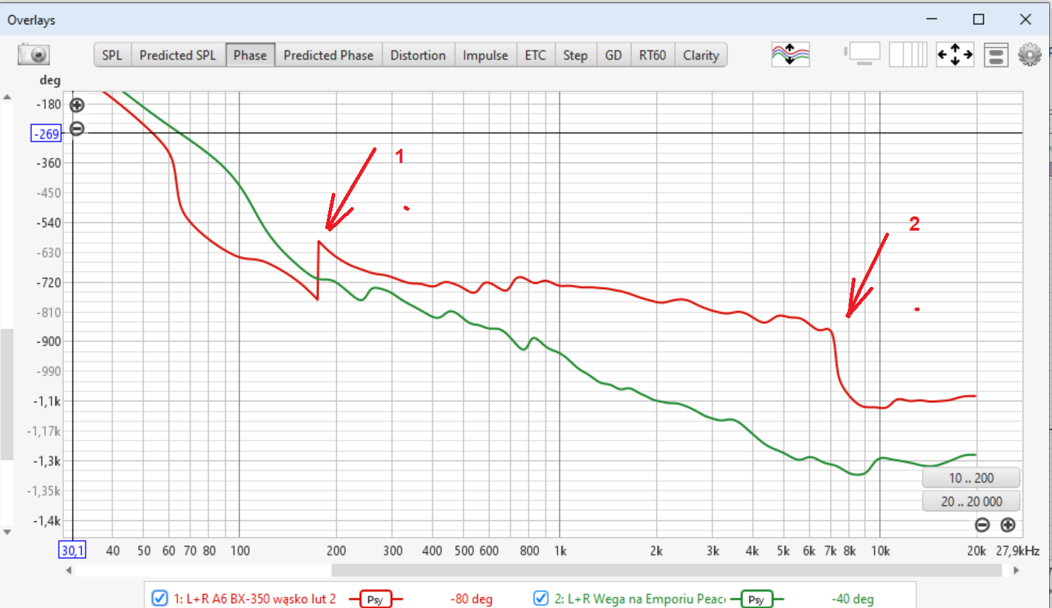

The phase response is very different between these two speakers. These speakers are simply bound to sound different. And this is without taking into account their amplitude response.

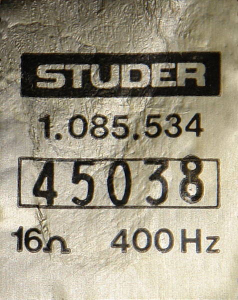

Just a sidenote: In no way did these midwoofers have an fs of 400 Hz. In the measurement plot that you show it is clear that the fc is around 55 Hz. Back then when they were new I didn't like the sound of these speakers at all. Part of that was their lacking bass extension.Interesting detail, Revox mid-woofers have FS of 400 Hz (!) and go down to 45 Hz without hesitating.

Ihe measurement were taken in the very same room 😉 The differences may come from a radical way that Revox had chosen to impulse-align BX-350 drivers, that's a stepped baffle. I am doing in-room listening triangle measurements on purpose as they - just as you mentioned - show how do the speakers go on with room modes, reflections etc. I am aware how different these speakers sound and can easily express these differences by air as far as tonality, precision, scene or dynamic abilities are concerned, but these are all just perceived and sometimes quite abstract criteria. Reproducing reverberation/echo from the source material by the speaker drivers is a very instrument-dependent subject, as every instrument and every room, never mind a real room or virtually added by reverb plug-in into the mix, has its specific spectrum of reverberation that is the most obvious for the listener. That's why I started with something such simple as measuring SPL at different amp voltage at the speaker terminals. Some basic logic - which is misleading of course - told me that if such SPL vs. input voltage grapg would be steeper for one speaker than it would be less or more rev/echo capable than the other one. But w are still talking about an echo or reverberation that comes from a source signal. Speakers can add or subtract, room can attenuate or not, that's interesting in any way. BTW: Why your REW has an STEP button and mine does not? 🙂Okay.

Hi Charles,Just a sidenote: In no way did these midwoofers have an fs of 400 Hz. In the measurement plot that you show it is clear that the fc is around 55 Hz. Back then when they were new I didn't like the sound of these speakers at all. Part of that was their lacking bass extension.

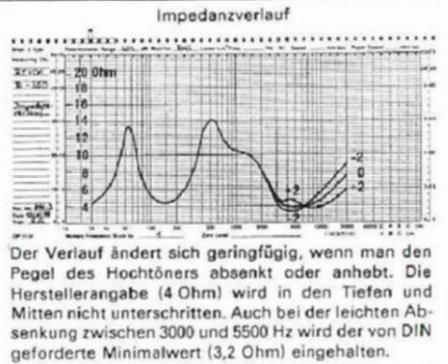

whay You see is my listening rooms first mod at 52 Hz. Here is the impedance curve of these speakers taken by German testers in 1970's:
...and the resurrecting truth stamped on the speaker magnet 🙂 (photo taken by one of Revox enthusiasts: https://www.technikundnatur.eu/revox-lautsprecher/revox-bx-350.html)
...and yes, these speakers ar not a bass-reflex-like bass-boomers, but the quality of the bass is exceptional, as it is superfast. Huge magnets, superlight paper cones that go up to 3200 Hz. One of my favorite speakers of all times. For earth-shaking I have Revox Emporium B. Any bass-reflex speakers have a no-go to my room since a few years 😉
