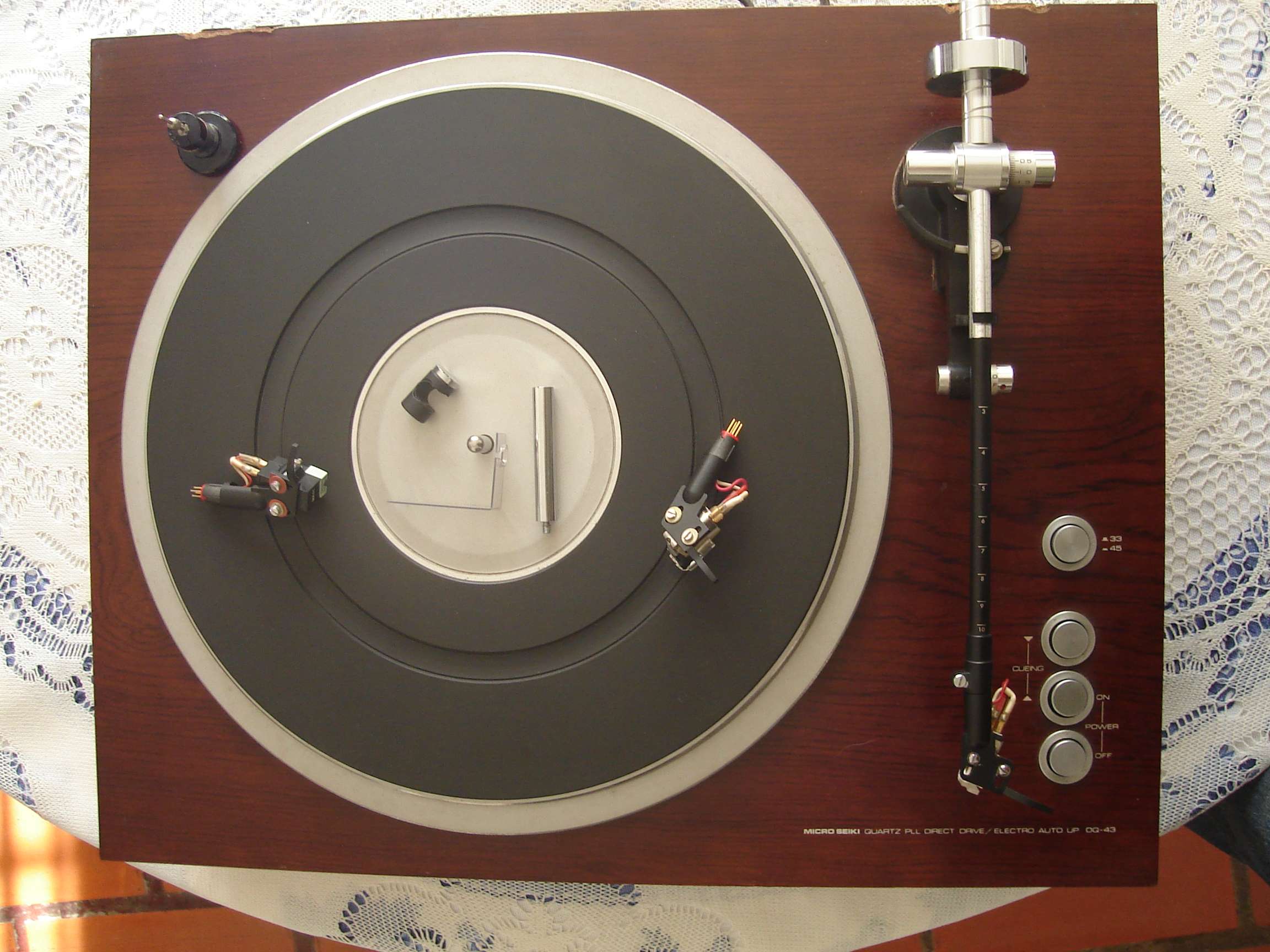

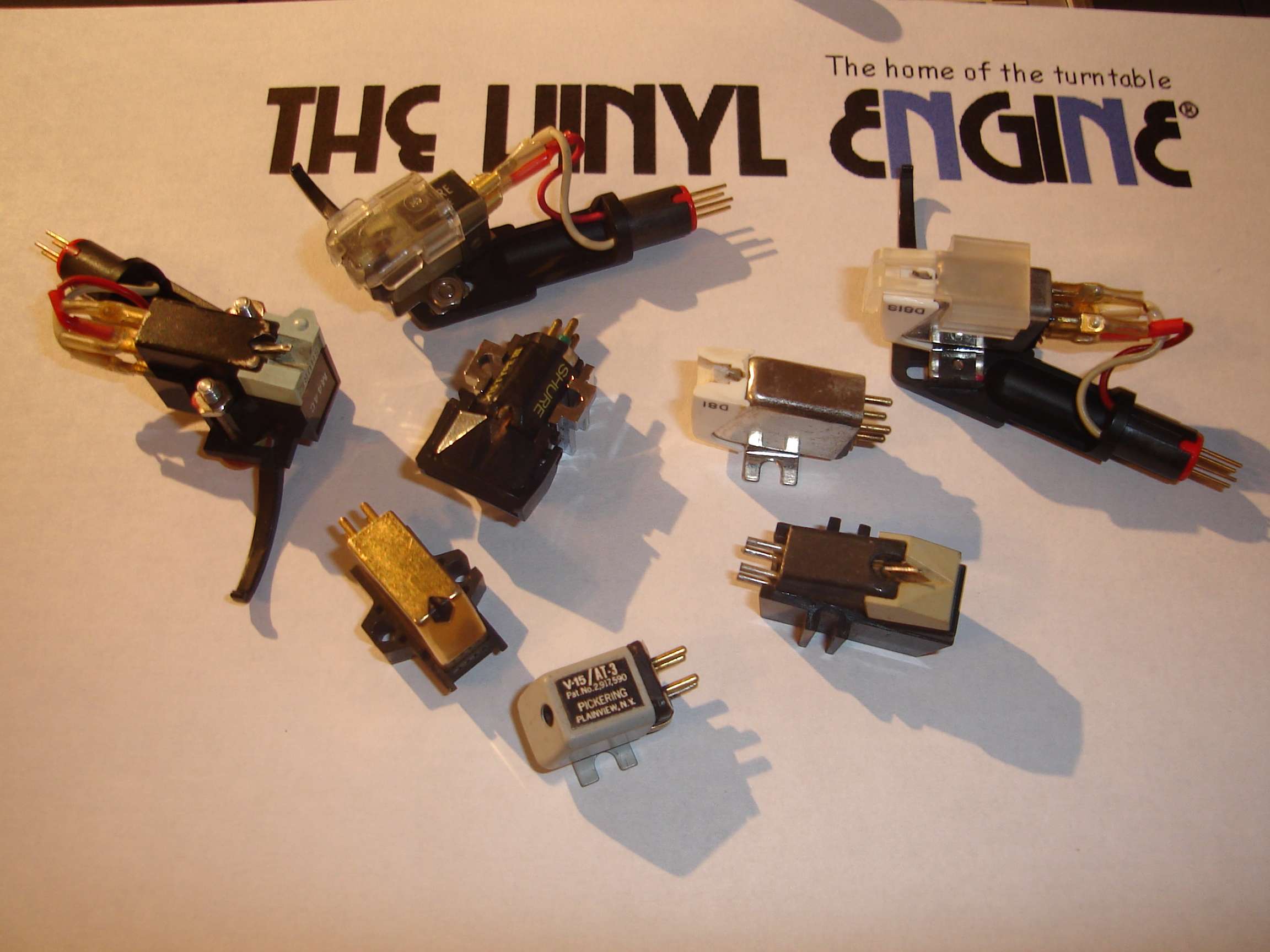

I have been reviewing photos of my external HDD, I did not remember having so many capsules in use ...

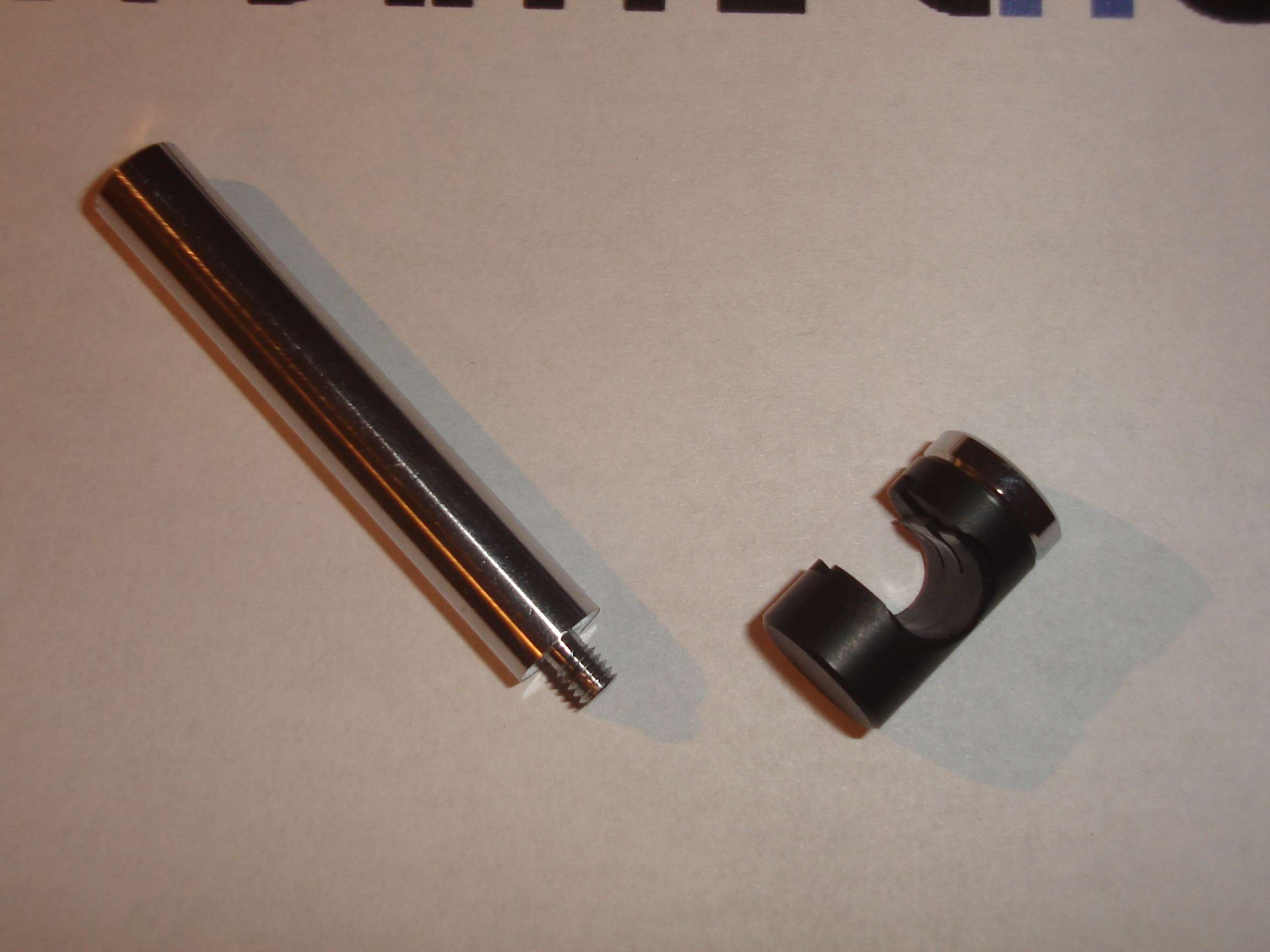

I am determined to go for an MC, and according to my budget it will be the Denon DL 103, I am more anxious than in my "honeymoon" to release the additional weights to add more mass to the arm, something essential with this cartridge if we intend make him " sing " :)

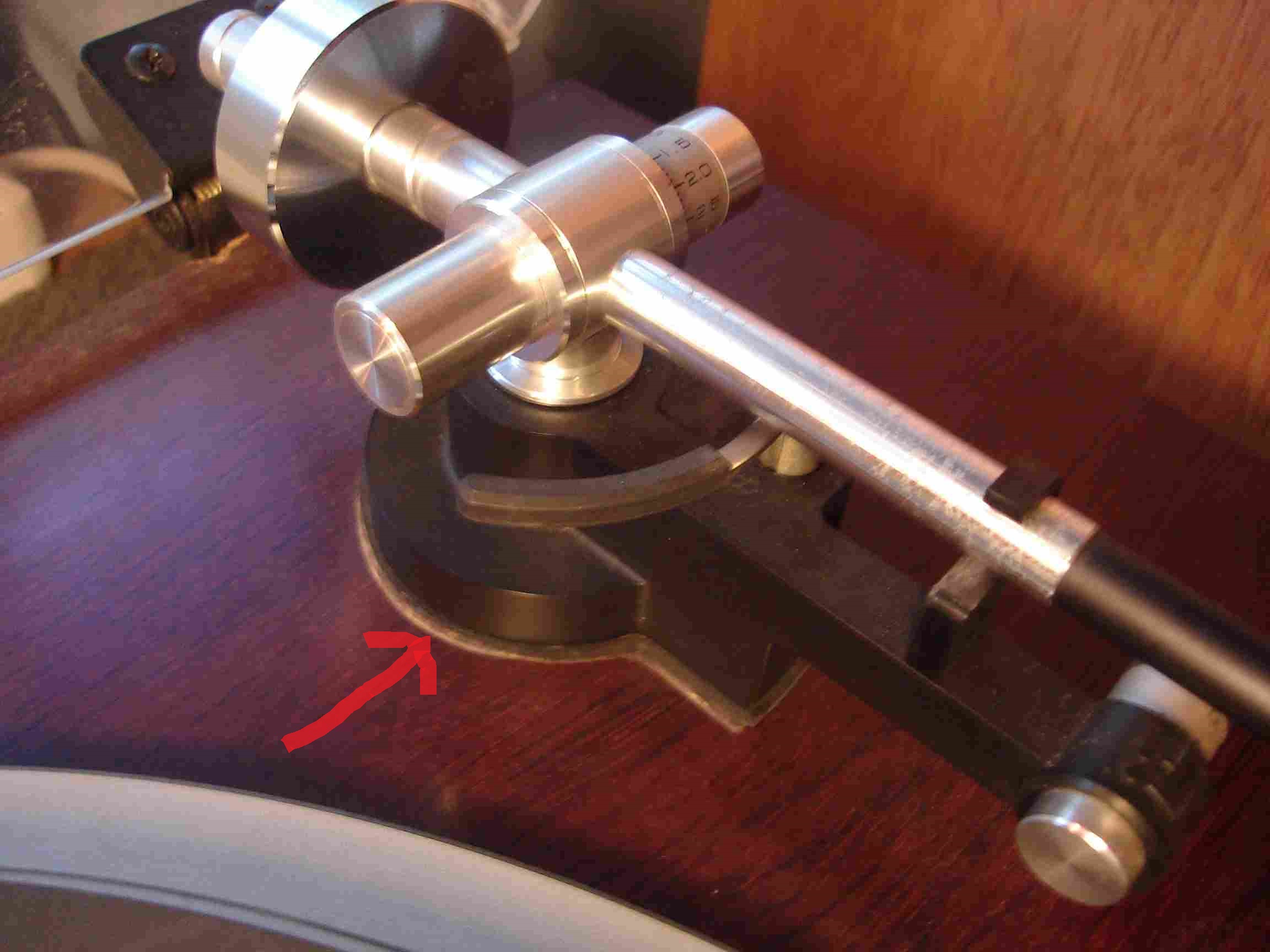

You can also see how I solved the VTA problem by complementing 3 MM +/- the base of the arm, to achieve perpendicularity according to this paragraph of the attached article:
"With the stylus resting on this medium thickness album, the bottom of the cartridge should be parallel to the album."
How to adjust the VTA of a turntable – PS Audio

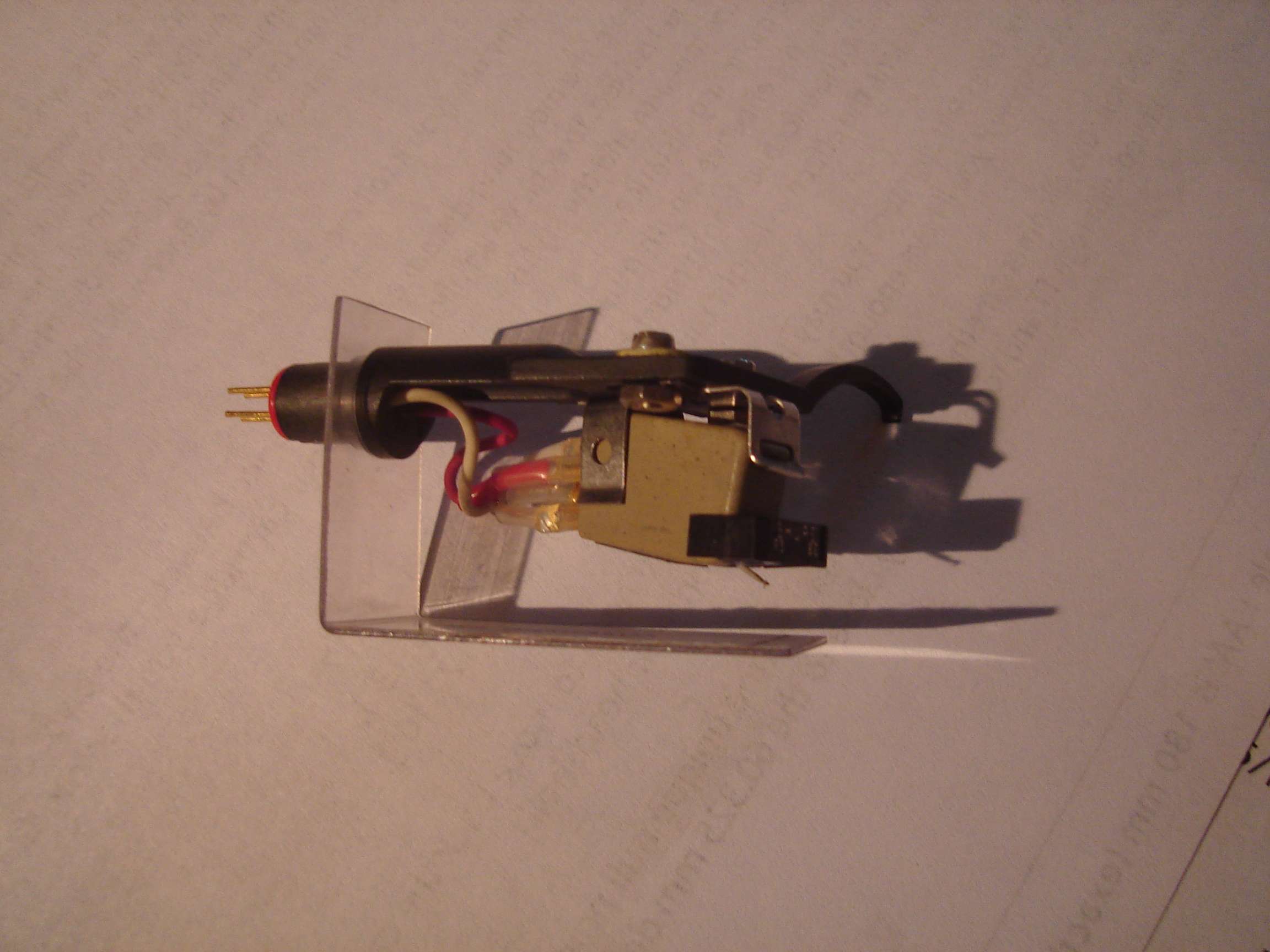

With some cartridges like this Shure M91ED it was not so easy .....
