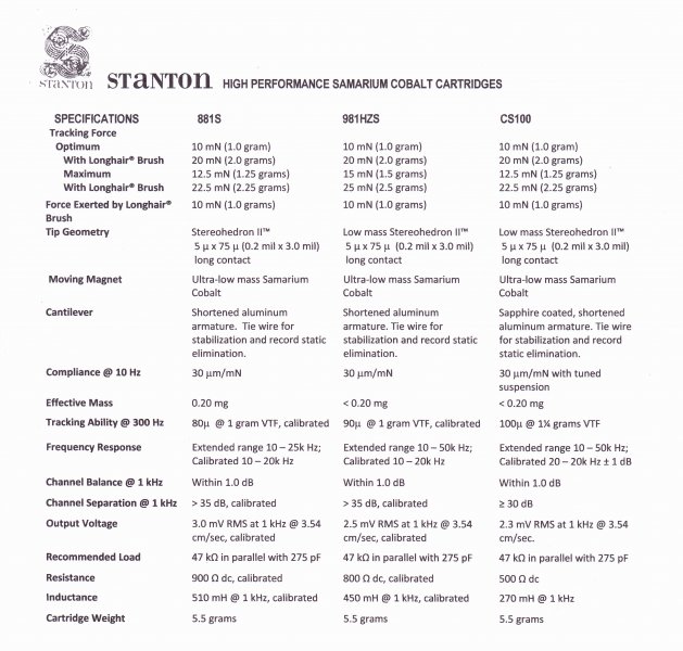

By observing the Stanton 881S capsule, with the gadget that you see in the attachment, I confirm that indeed the needle is much more worn on the external side, as I had already imagined.
It was impossible for me to take a picture with the smart phone, sorry.
So, and responding to my own concern since I am the OP, I come to the conclusion that the "factory" AS settings tend to be excessive.
But, likewise, a difference of 1.3 grams (there was an error there, I added instead of subtracted) also seems excessive to me, especially in a brand that enjoyed great prestige and manufactured excellent arms and TT at the time.
So to regulate the AS according to post 30, it seems to me that it will be too little, I just use my intuition here, some phrases seem too pretentious to me, like the one that states that "this setting works with any VTF and with any cartridge" ..
So I adjusted AS in the middle, that is, when the arm / needle remains static on the RX plate in the middle, placing the plate on a vinyl of normal thickness.
Now to enjoy music, which is finally the leitmotiv that concerns us.🙂
